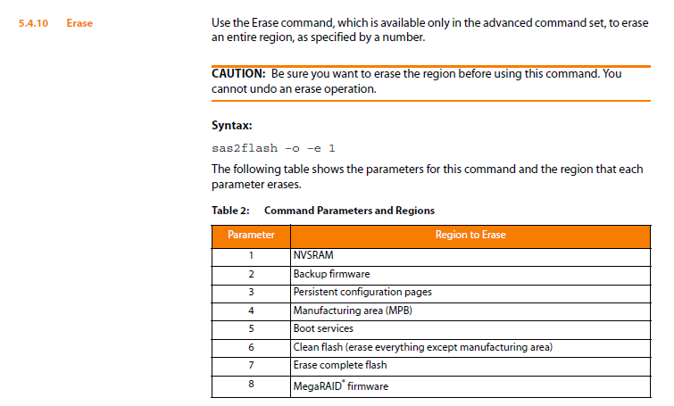

13 minutes ago, Fireball3 said:
I'm not sure if "5" is the right option.
It is.
sas2flash -o -e 5
then confirm it was removed with
sas2flash -list
Bios Version should now read N/A
Edited by johnnie.black

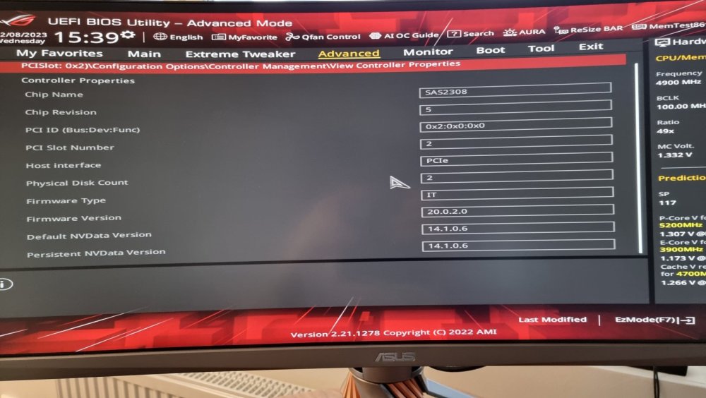

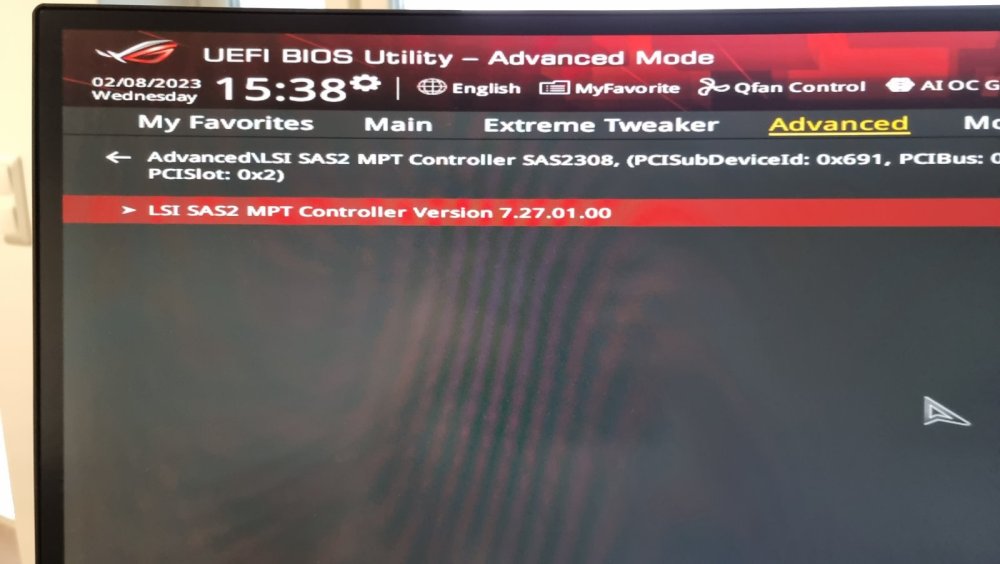

Hello guys new to the forum and Unraid! just go my hand on a 9211-8i from ebay. and I've read online that you need to flash the firmware to a newer ideration and IT mode to use it as a normal sata controller. But when I installed mine i'ts saying FW 20 and -IT mode. Does that mean I dont have to do anything?
Should just work then.
Plug a HDD in and then, see if appears unraid. If it does boom working.
Check it's using the latest firmware P20.00.07, there were two previous releases and the 1st one especially (p20.00.00) had issues.
