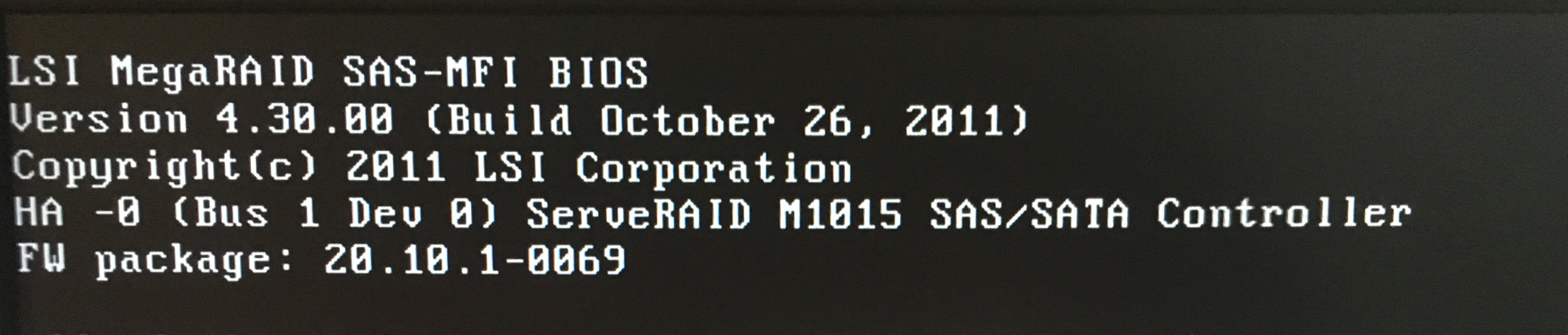

Hey all,
I just tried flashing my IBM ServeRAID M1015 card, using the tools kindly provided by @Fireball3, but I get the "No LSI SAS adapters found!" error on FreeDOS (during the 1st step).
I am attaching a pic from the card's initialization phase during boot, which shows its current status.
Any workarounds/ideas?
Can you PM me the logs from within the logs directory?
