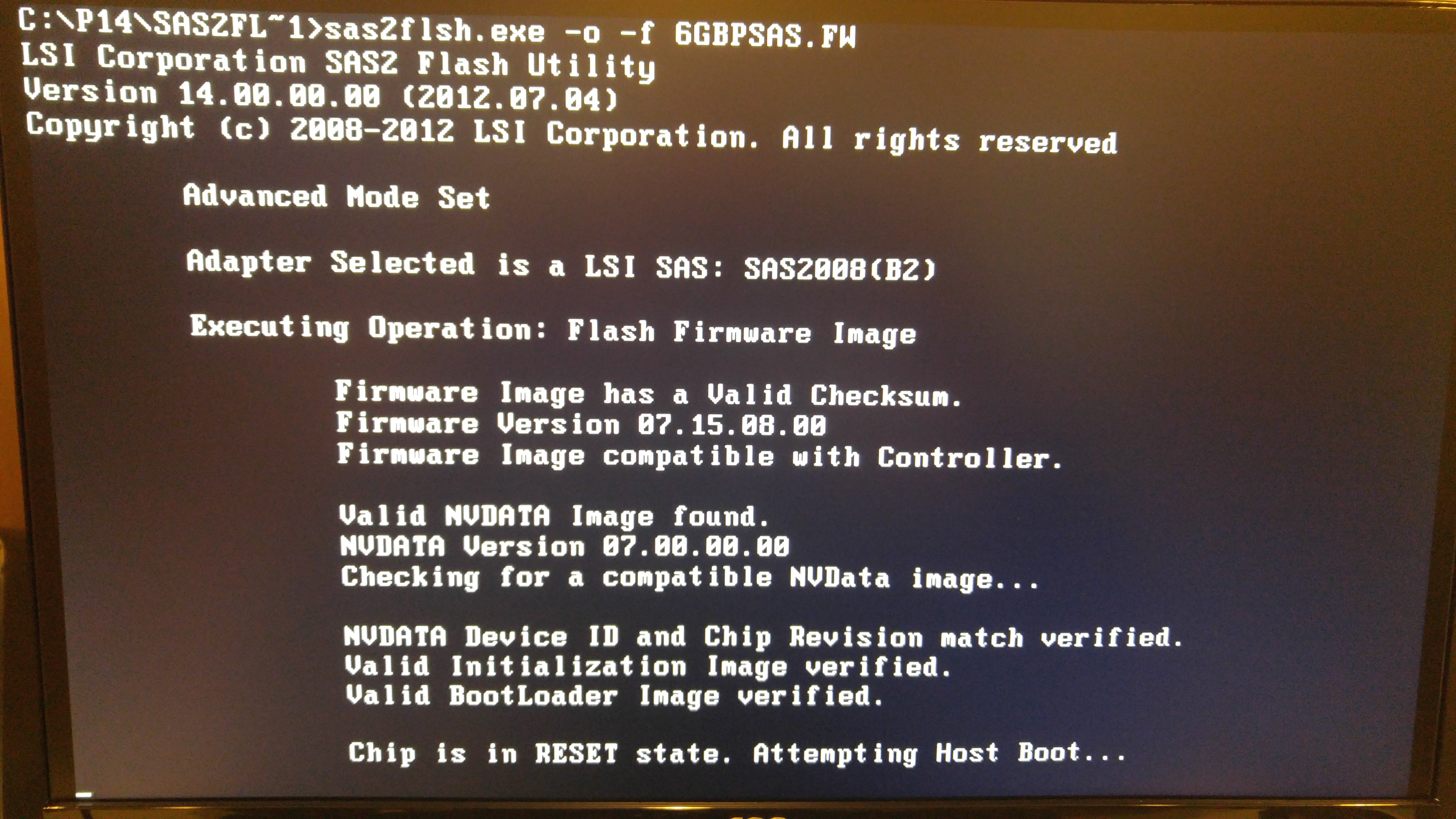

I then executed "megarec.exe -writesbr 0 sbrempty.bin" and it returned a Success!  The way the guide was worded I assumed since the command succeeded I could skip the step of "megarec.exe -cleanflash 0", so I rebooted the system.  No RAID BIOS loaded and I just booted straight to the USB drive.
When I execute the "sas2flsh.exe -o -f 6GBPSAS.fw" I get an error of:
Chip is in RESET state.  Attempting Host Boot...
ERROR: Firmware Host Boot Failed !
Due to error remaining commands will not be executed.
Unable to Process Commands.
Exiting SAS2Flash.
I went back and executed "megarec.exe -cleanflash 0" but that has not helped the problem.
The little green light on the card is still flashing.

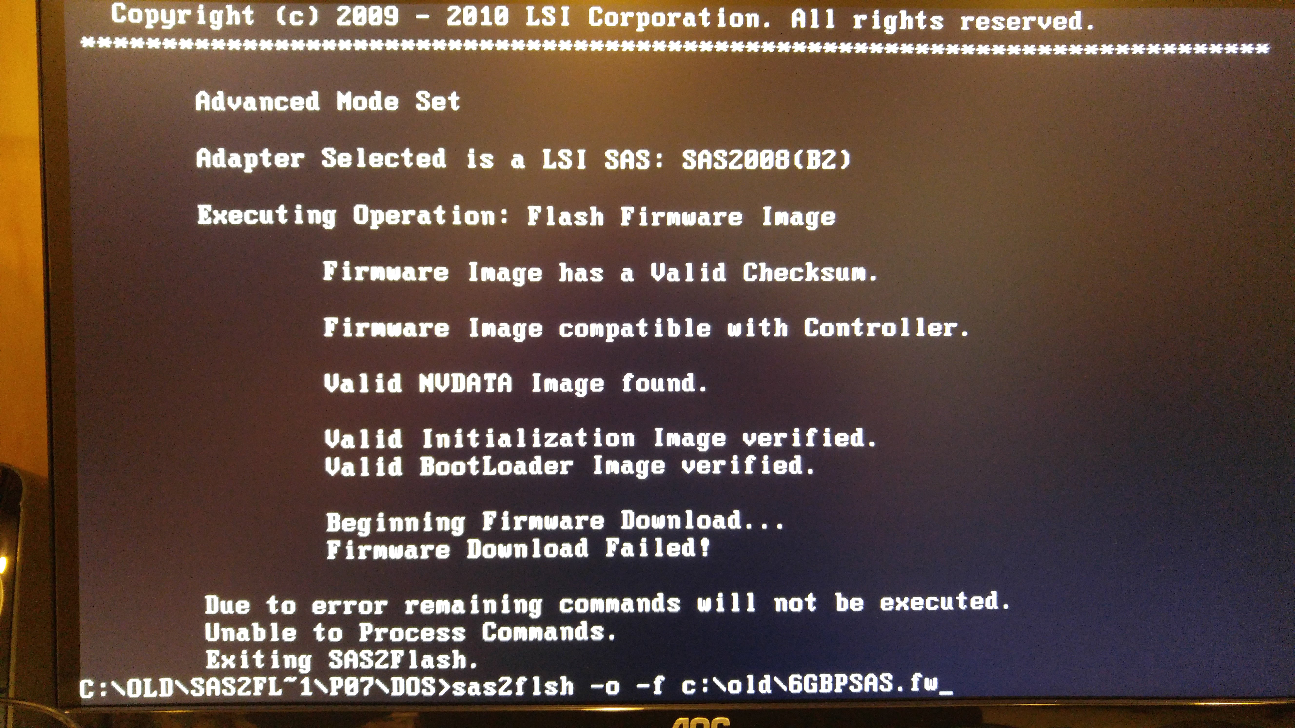

I then did some searching on this error and found these forums and your awesome batch files for accomplishing the flash.  I wish I had found these first!  When I run your batch files I get the error:
Controller is not operational.  A firmware download is required.  Enter firmware file name or quit to exit:
So I enter the path back to the 6GBPSAS.fw that I had previously and it gives the error:
Beginning Firmware Download:
Firmware Download Failed!
At this point I am not sure which direction I need to go.  Is this correctable?

The card is not bricked. While the instructions you linked are detailed, it fails to explicitly say to use the older version of SAS2FLSH tool for the first time.
You will need SAS2FLSH version (phase) 14 or below for flashing 6gbp SAS FW. Then you can flash the IT mode FW.

I tried the P07 version of SAS2FLSH and while it did recognize the version number of the chip (B2) it still gave me an error.  Here is a screen of the issue with the command that I used at the bottom:
What am I missing?  Thanks.
Try the P14 version.
Also, copy the FW file in the same directory as the sas2flsh. Not sure if that makes a difference. But just to rule out the quirks.

OK.  I got the P14 version of SAS2FLSH and it just hangs when attempting host boot.  It has been like this for about 30 minutes.  I'm assuming it will wait forever!  Any other ideas?  Thanks again.  I really appreciate the effort.

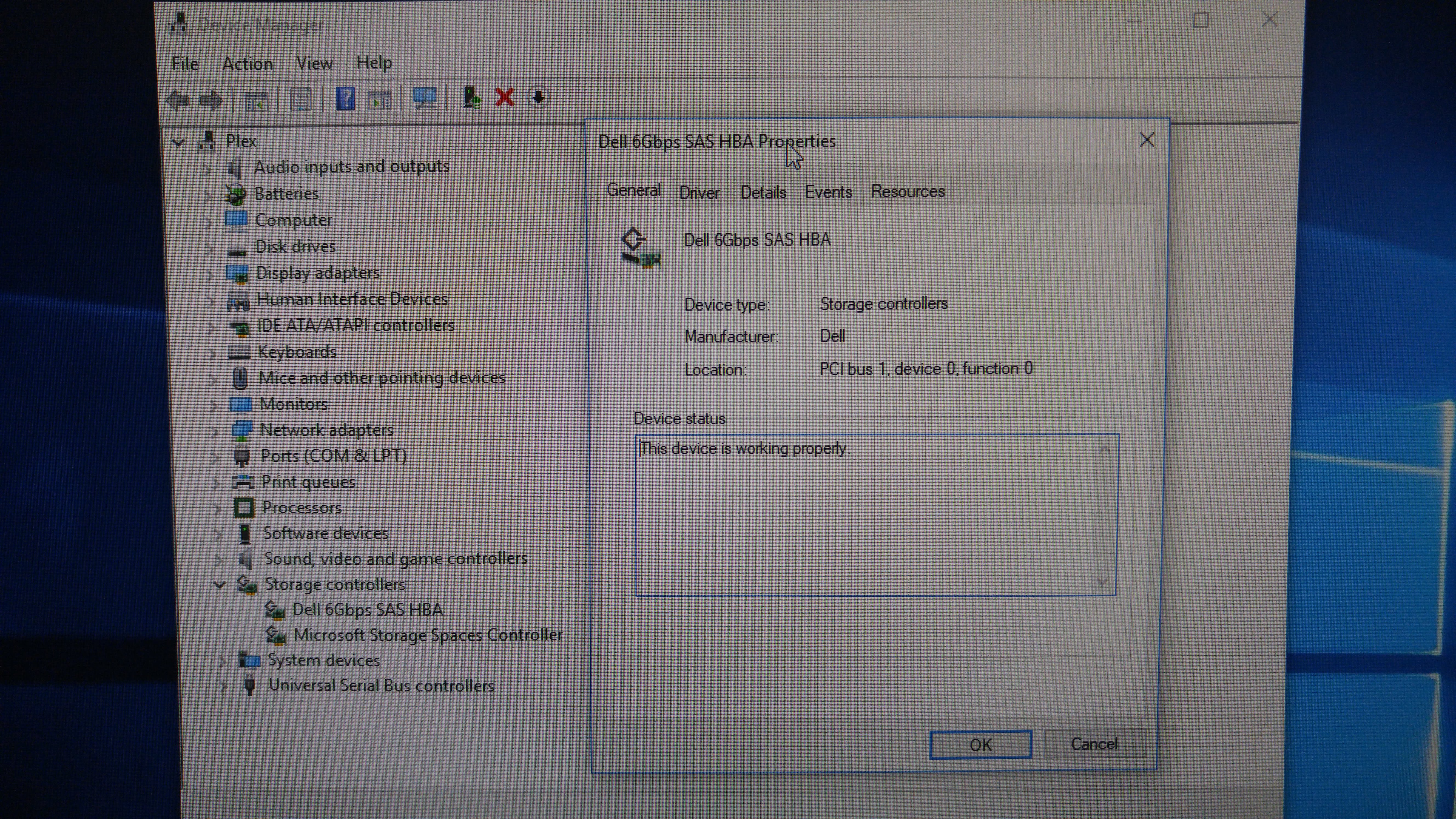

SUCCESS!!  I'm not sure what exactly did it this time because I had tried the -cleanflash previously several times and it always gave an error.  But, this time I did it first and, it actually completed.  Then -writesbr also completed and it allowed me to continue to flash the firmware!  Go figure.  Maybe it was the several reboots in between this time around?
Thanks nthu9280 for all of the help.  It is greatly appreciated!  It is now working extremely well in Windows 10 with the Samsung 860 Evo 1TB SSD.  I was getting 528 MB/s Write and 571 MB/s Read transfer rates.  I am definitely happy with that.  It was actually faster then my test machine's (Dell Optiplex 7010) internal SATA III ports with a Samsung 850 Evo 250GB SSD.
I did install the BIOS as I need to use it as my boot card on my older machine that I am moving it too.  I originally didn't install the BIOS on the card and it wasn't selectable as a boot device.  It works great now.  Here are some screens.  Thanks again!

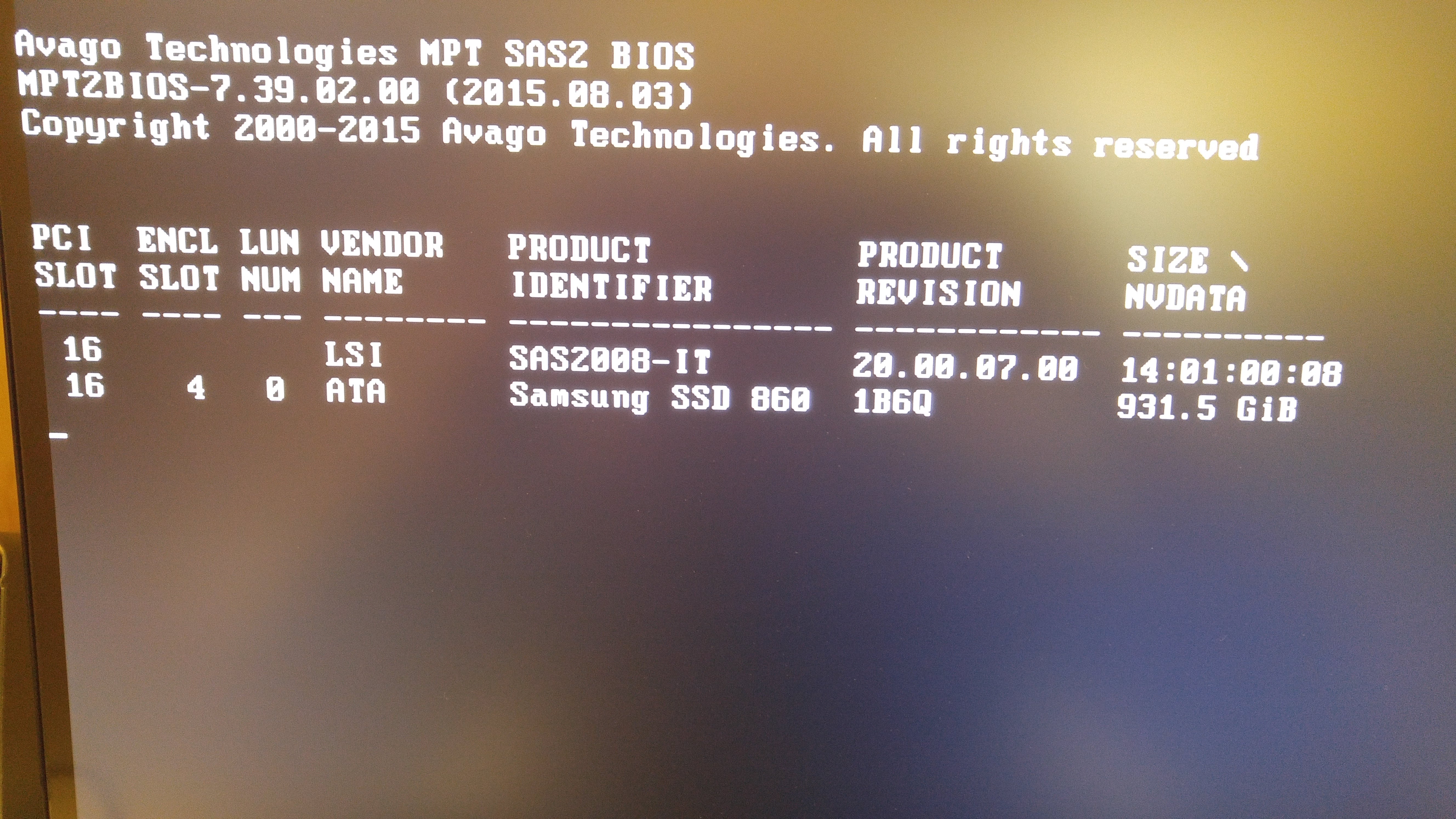

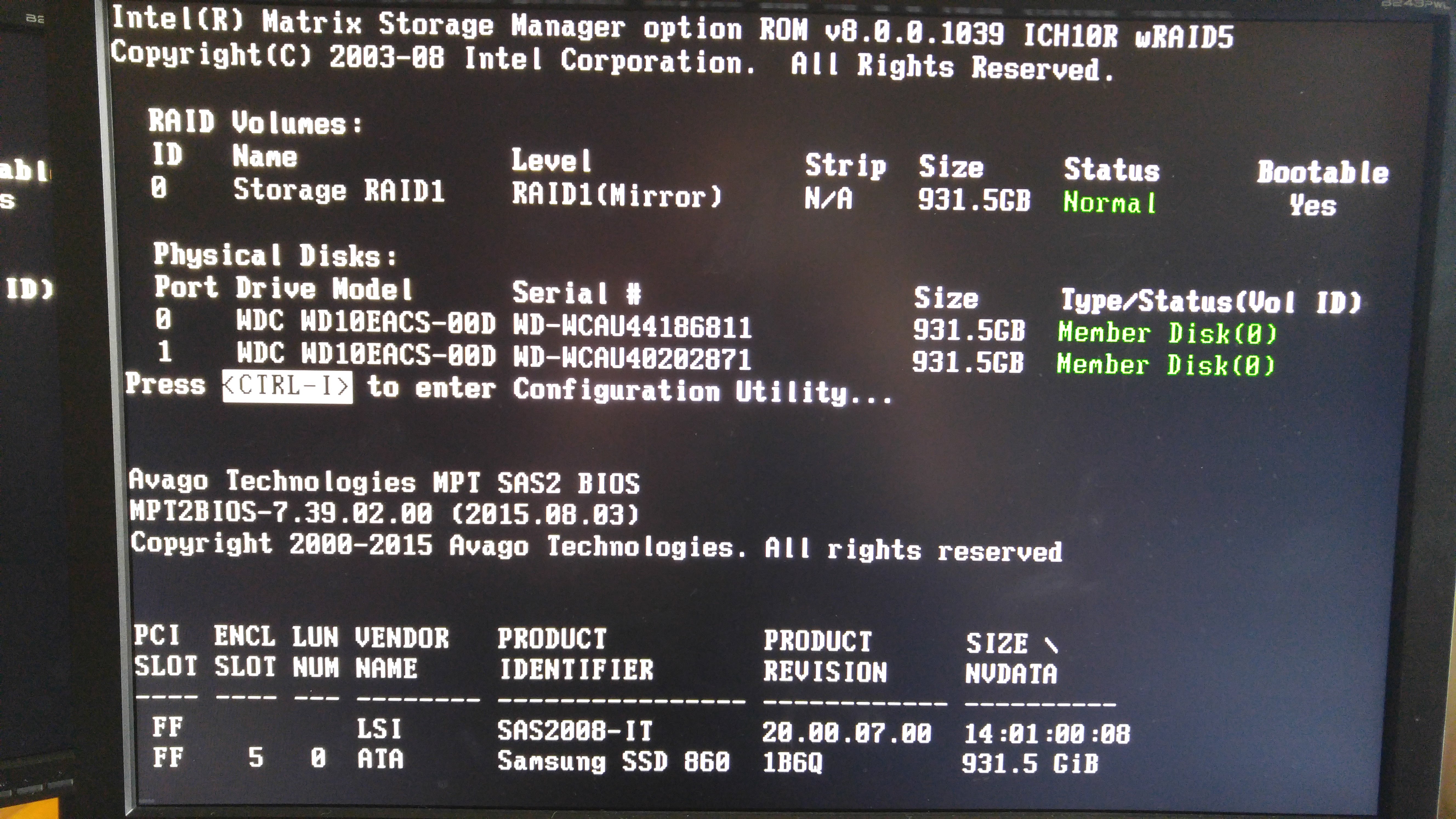

Last night, I put the flashed Dell H310 card in my old machine.  Its a Q6600 processor in a Gigabyte ep45-ud3p motherboard with 8GB DDR2.  The machine has been running perfectly with an old Adaptec 5405 RAID controller with 4 x 640GB WD drives in RAID 0 as a boot drive for over 10 years.  I removed the Adaptec card and the HDDs and put the H310 in the exact same PCIe x16 slot that was previously used for the old RAID card.
Unfortunately, The machine failed to boot at all with the H310 installed.  No video, no beeps, no BIOS, no splash screen, nothing.  The machine would just power cycle after 15 seconds over and over ad infinitum.  When I pulled the H310 card out, the machine booted up just fine.
Does anyone have any ideas on how to get this to boot with the H310 card in this setup??  Thanks in advance!

Thanks for the reply.  Taping off B5 and B6 worked perfectly to get the card to boot but another road block has arisen in my quest to get this card operational.  Now it just hangs after the H310 BIOS  Initialization screen.  Screen shot below:
If I unplug the Samsung SSD, it goes straight through to the next initialization process.  If I plug the SSD back in, it hangs again.  Any other thoughts?  I can get into the configuration utility for the card with a Control-C and have played with several different options, to no avail. Thanks!

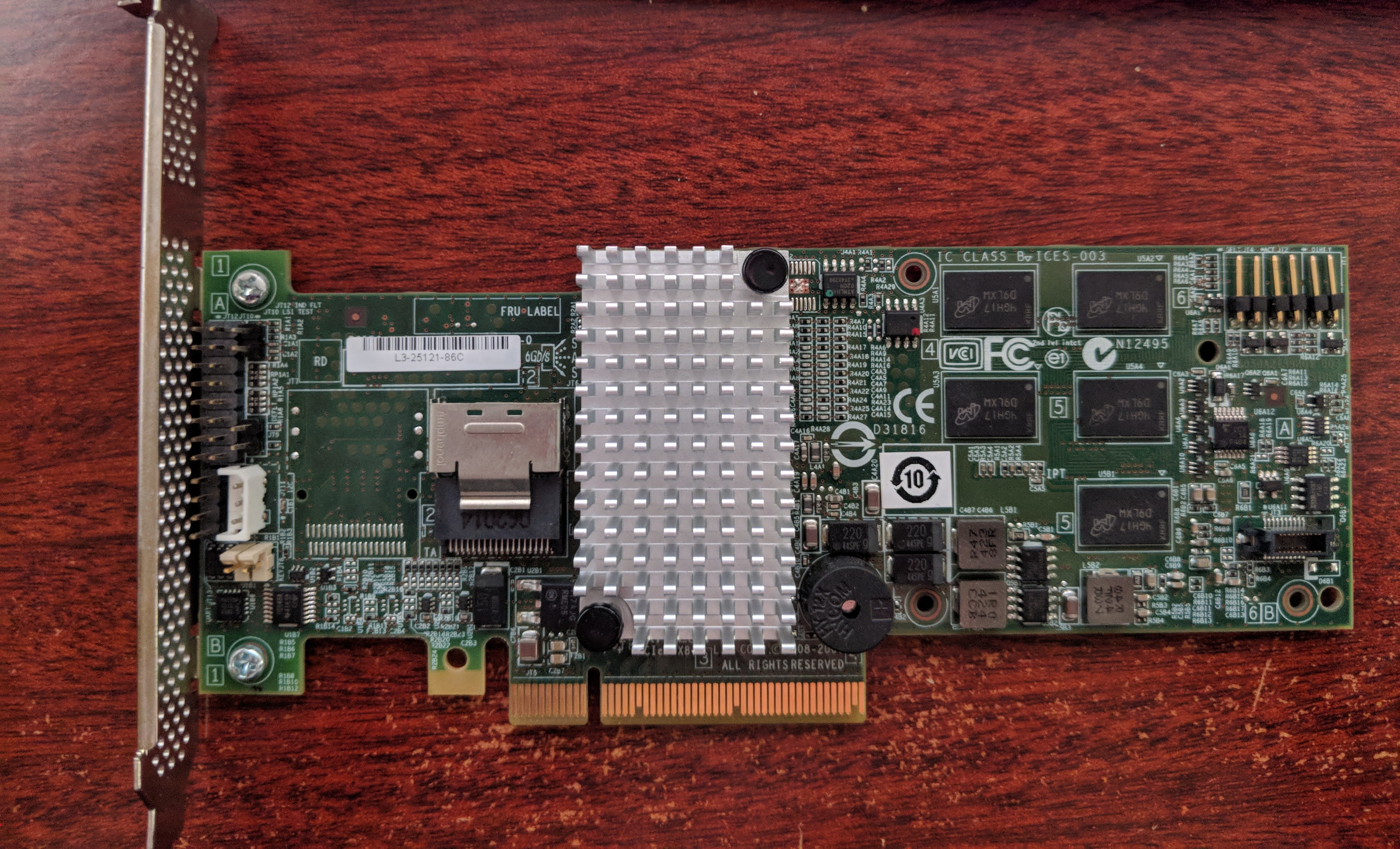

Can anyone help me identify the card i have below. I think it is a LSI SAS 9240-4i but i wanted to confirm. If it is, can i crossflash it? All of the stuff i see mentions the -8i but not the -4i. Can i still flash it to a 9211-8i IT (-4i?)
It's probably the best you plug the card into a board and query
MegaCli.exe -AdpAllInfo -aAll -ApplogFile mgcliad.txt
or
sas2flsh -o -listall -l sas2ad.txt

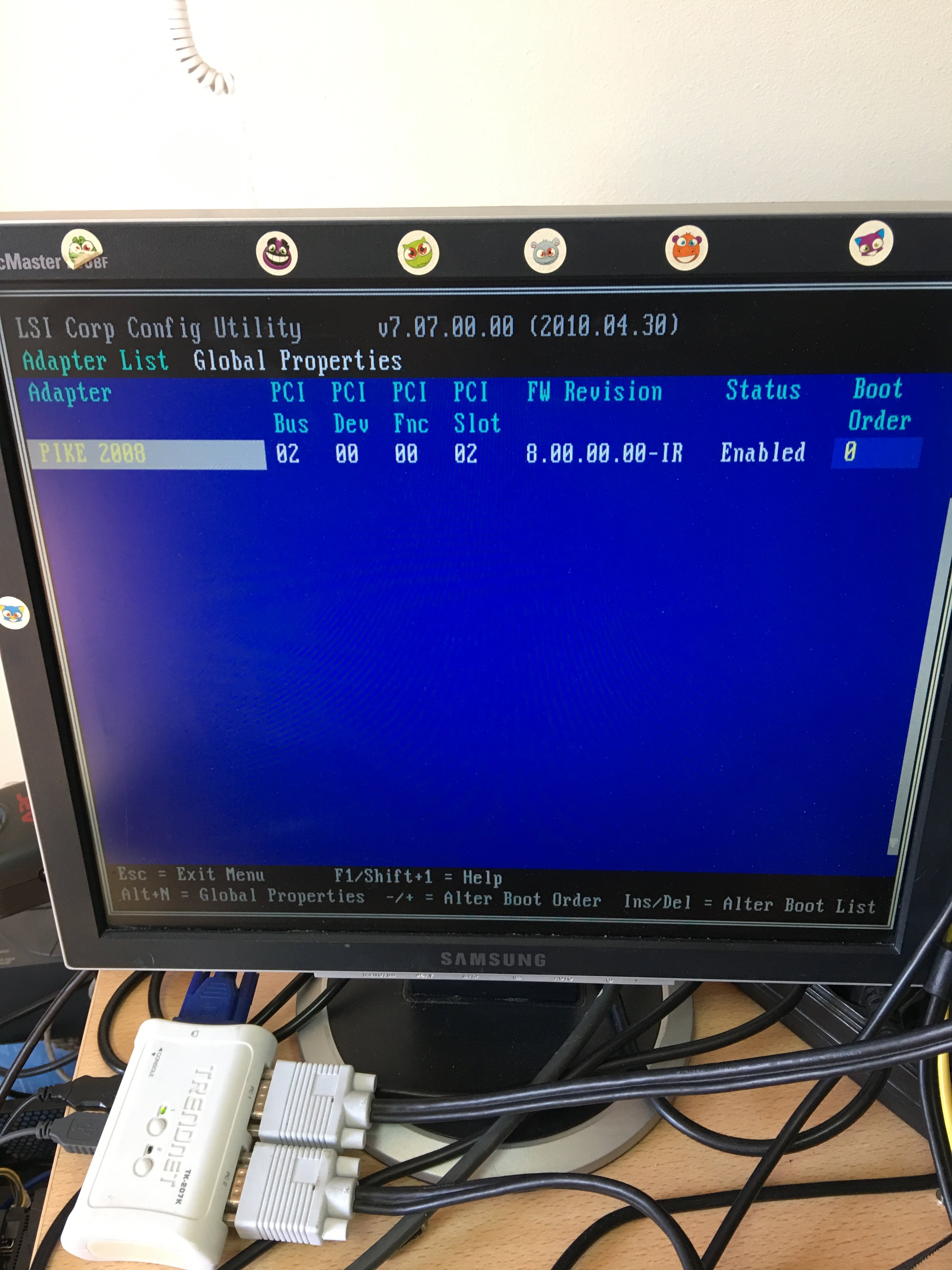

Hi i have ASUS Z9PA-D8, and Asus pike 2008(B2) - i think that this is sas 2008(see screenshots).
What i do:
1) Download package from first page LSI SAS2008 chipset LSI SAS2008 Controllers(P10)Linux.zip - 3.43 MB (unRAID)
2) Boot to linux
3) Run 1_ListAllAdaptors.sh and i see my controller
4) Back up old firmware and bios by 2_Backup_Current_Firmware_Bios.sh
5) Run 3_Flash_to_IT_mode.sh and get error "cannot Flash IT Firmware over IR Firmware"
6) I think that i need to Erase the old firmware. By this site chapter Overview i do
   Boot dos,
   megacli.exe -AdpAllInfo -aAll -page 20     (get error "Exit code 0x01")
   megarec.exe -readsbr 0 mega.sbr   (backup my old firmware)
   megarec.exe -writesbr 0 sbrempty.bin    (success)
   megarec.exe -cleanflash 0  (succsess)
7) Reboot to linux and do with package from 1):
Run 3_Flash_to_IT_mode.sh and get error, but error text i forget
8 ) Boot dos and sas2flash -o -e 7
9) Reboot to linux and do with package from 1):
3_Flash_to_IT_mode.sh and get error "No LSI SAS adapters found! Limited Command Set Available!"

I solved problem.
Hi i have ASUS Z9PA-D8, and Asus pike 2008(B2).
1 )Use guide
but a cant boot efi on my mobo
2) i get latest package from
 Update on 17.04.2017, v4
3) boot dos from 2) and use guide 1)
