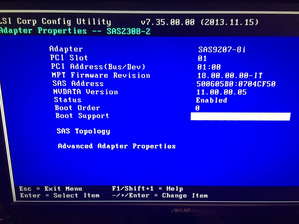

June 24, 20188 yr On 6/12/2018 at 9:58 AM, Fireball3 said: This card is a plain HBA. Firmware is available in that place and instructions should be there also, if you need more assistance, feel free to ask. I just got the same card I believe. Ordered from eBay and I did decide to try it out after looking in bios it was indeed it mode. I changed boot support to disable. And everything is working like normal. very impress with this little card and this speeds. If I ever felt the need to update are their any how to?
