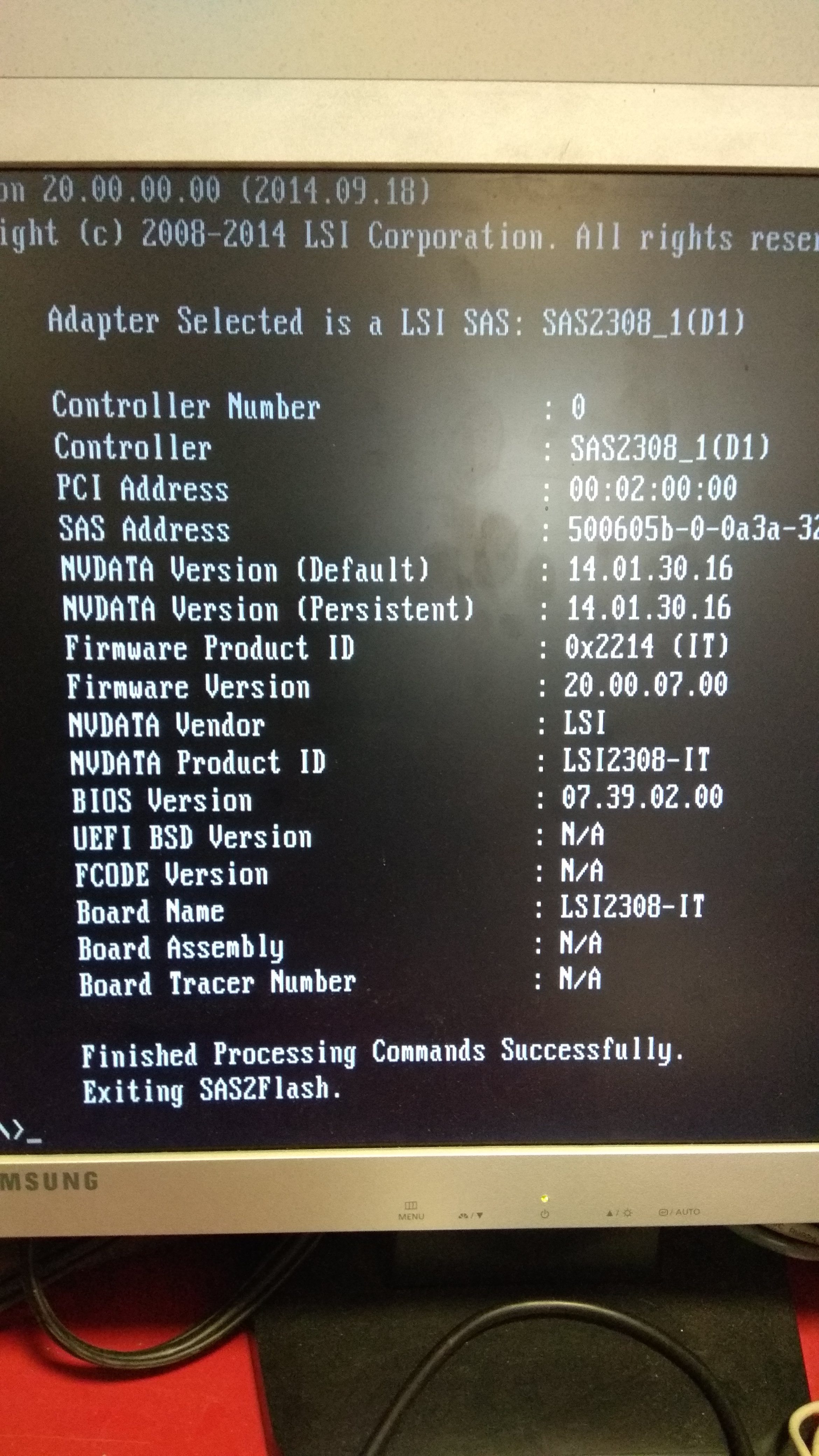

Hello all,
i need advice. I bought HP220 (LSI 2308) card in IT mode and i need it to flash to IR mode, can someone please provide me step by step instructions?
I try to erase firmware
sas2flsh -o -e 6
then i tried to flash IR firmware
sas2flsh -f 2308IR207.ROM
but i get an error NVSRAM is required to flash ir firmware.
p.s. sorry for my bad english
Hi @iwi, welcome to the unRAID forums.
My information is that the HP220 is a plain HBA with no other operation mode than IT!
The error you encountered also indicates that the necessary hardware (NVSRAM) is missing for IR mode.
If you have other intel, please feel free to post here.

I found out that the HP220 is an LSI 2308 based card which should be able to operate both modes IT or IR. Have anyone some information please?
Edited by iwi
Here is says it is a SAS2008 based card.
https://www.servethehome.com/lsi-sas-2008-raid-controller-hba-information/
Here it says SAS2308 card.
https://forums.servethehome.com/index.php?threads/lsi-raid-controller-and-hba-complete-listing-plus-oem-models.599/
Or maybe there are different versions of the H220 card out there (see willglynn-link)?
Here we have different reports.
https://forums.servethehome.com/index.php?threads/flashing-hp-h220-sas-card-to-latest-fw.13057/
Some work with SAS2008 firmware, others do with SAS2308 firmware.
Try flashing an IT mode firmware. Does it error with:
NVDATA Image does not match Controller Chip Revision
Also see here:
https://www.willglynn.com/2014/11/10/lsi-sas-firmware-nonsense/
Are there any labels on the PCB?
It's all about finding the right chipset at the moment.
Nobody want's to flash the card to IR mode in those threads.
Edited by Fireball3

On the card is a label
SAS9205-8i   H3-25278-05D
on another label is SAS adress
on 3rd label is
SP: 660088-001(which after googling says that is this HP 220 card)
CT: PBUHT0A8S8J0JT
AS: 638834-001
DG:: 638834
If you search the broadcom site for 9205 you will get results SAS9205-8e (external plugs).
The corresponding .zip files have no IR firmware inside.
That's why I'm concluding, that the SAS9205-8i/e aka HP H220 will not work in IR mode.
But, feel free to try the LSI SAS 9217-8i or LSI SAS 9207-8i files.
Start with the IT firmware to confirm the right chip and then try the IR firmware.

When i run sas2flsh -list a i get this
