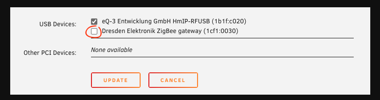

I uncheck the Conbee (Dresden Elektronik ZigBee gateway) from "USB devices" in the VM Edit menu and just pass through the serial entry.

Have you removed the device mapping in the VM template?
also name will be different in HA.

3 minutes ago, Todilo said:
Is this the device mapping you are referring to? I have tried both ways but doesn't seem to help. I can actually see the device in HA like this, now with a very weird name:
Yes that was the mapping, needs to be left unticked.

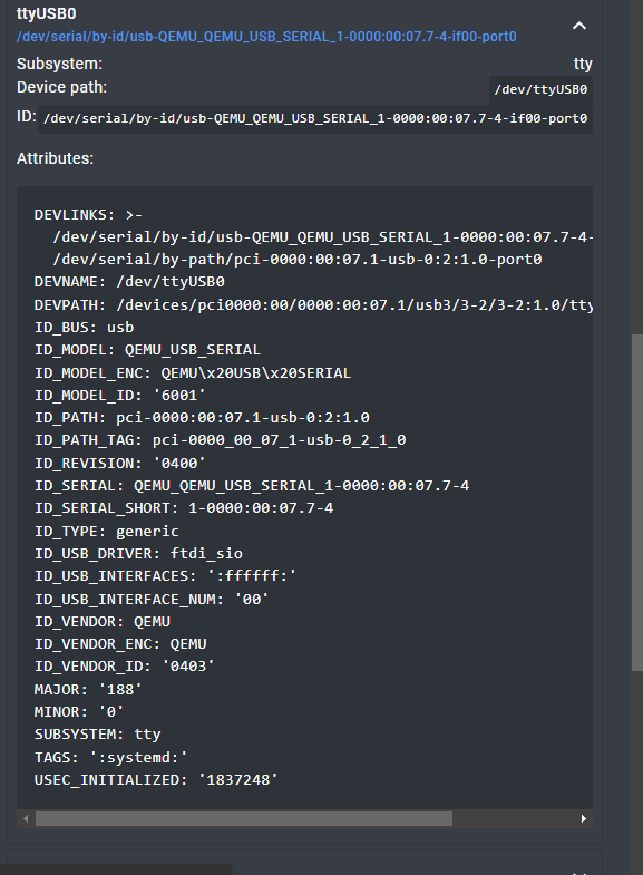

Thank you. It seems to be working now. Is there a way to actually see the mapped name in Unraid. I mean home assistant could find the tricky name
/dev/serial/by-id/usb-QEMU_QEMU_USB_SERIAL_1-0000:00:07.7-4-if00-port0
but if I go to command-line in unraid I will only see
/dev/serial/by-id/usb-dresden_elektronik_ingenieurtechnik_GmbH_ConBee_II_DE2132783-if00
I have also tried a reboot fully of the system now so that was awesome (last time I had a power outage and stuff stopped working)
Not that I know of, but you can see the attached USBs on the VM
root@computenode:~# virsh qemu-monitor-command HA --hmp info usb
  Device 0.2, Port 1, Speed 480 Mb/s, Product QEMU USB Tablet, ID: input0
  Device 0.2, Port 4, Speed 12 Mb/s, Product QEMU USB Serial, ID: ua-serial001016
  Device 0.2, Port 2, Speed 12 Mb/s, Product host:1.4, ID: hostdev0

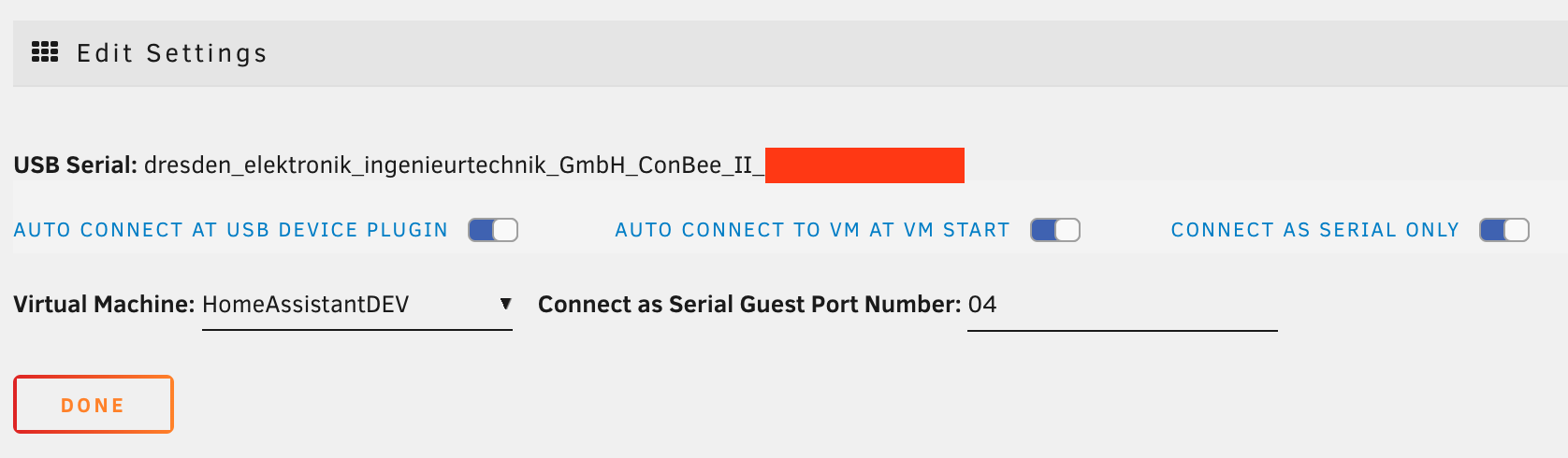

I followed instructions given by SimonF. I use USB manager but did not know that new feature has been added to pass device to VM in serial mode. So instead of modifying XML file, all you need to do is:
1) install USB manager plugin
2) Do not attach any device in the VM properties. Instead go to USB manager menu, locate the device you want to pass to VM, and click on device settings here:
3) Enable "connect as serial only"
You can also select auto connect if you want to.
Side note - if you did pass the device via USB manager before, then you probably did not use serial only mode. By checking this, mode will change.
4) Shut down your VM and start it again, it should attach device to your selected VM in serial mode:
Once that is done, all you need to do is change the path to device. I use Z2M - in Z2M configuration, I just changed path from /dev/serial/by-id/conbeeXYZ to /dev/serial/by-id/qemuXYZ
That is it. My Zigbee network works without any additional intervention needed, and I successfully upgraded to 6.10.3

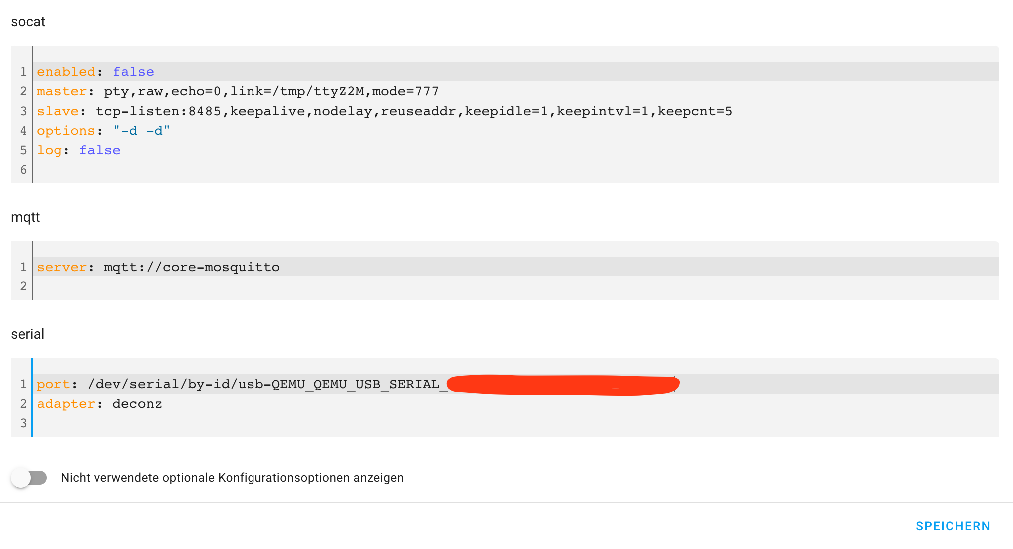

@stefan.tomko unfortunately, this does not work for me, as you have described it to me... How did you connect the stick to Z2M? I have always installed Z2M according to these instructions. But unfortunately the stick is not recognized correctly in Unraid.
Under port I used /dev/ttyUSB0.
Edit: These are my current settings:
751067428_Bildschirmfoto2022-09-23um18_52_41.thumb.png.3a327c5fef1ac5087475d80925a5f331.png
Home Assistant Hardware Infos (Settings -> System -> Hardware)
1550209035_Bildschirmfoto2022-09-23um18_58_06.thumb.png.2160a34306d737d0ad51dba60de035f7.png
Zigbee2MQTT Settings in HA:
1931270349_Bildschirmfoto2022-09-23um19_00_04.thumb.png.eae892624e1ff62ead5c97102e9301ed.png
And i only get this Messages in the error log from Z2M:

What surprises me the most: I have deactivated Z2M in Home Assistant and installed the ZHA integration. This works without problems and the stick is recognized correctly by ZHA. I did not change anything in the USB Manager settings.
Edited by Pixelpaule
Your issue is with MQTT setup. I responded to you in HA forum.
Here the Info for all Unraid user... This is my Post from the HA Forum
Okay, it works… It was a mistake in the configuration. In the first YouTube tutorial, the YouTuber did not specify a username or password in the Z2M configuration. In the updated version of the Video he does! So I had to put only the data from the mqtt-user in the configuration of Z2M! Now it seems to work!

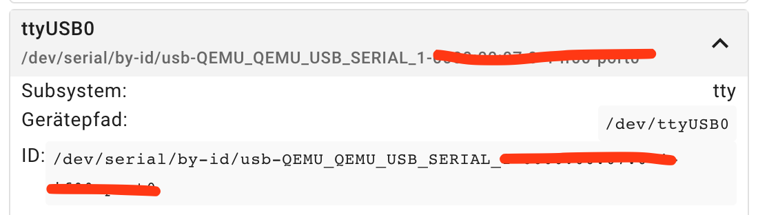

finally I update to unraid 6.11.0
It works great but, Do you know why my ConBeeII serial number change from DEXXXXXX in USB Manager to /dev/serial/by-id/usb-QEMU_QEMU_USB_SERIAL_1-0000:00:YYY? Do you keep your original serial number in Unraid VM with USB Manager?
thanks
thanks
No qemu creates a new virtual name for it in serial mode hence the new name. I use an alais on the config so i know the usb device.
