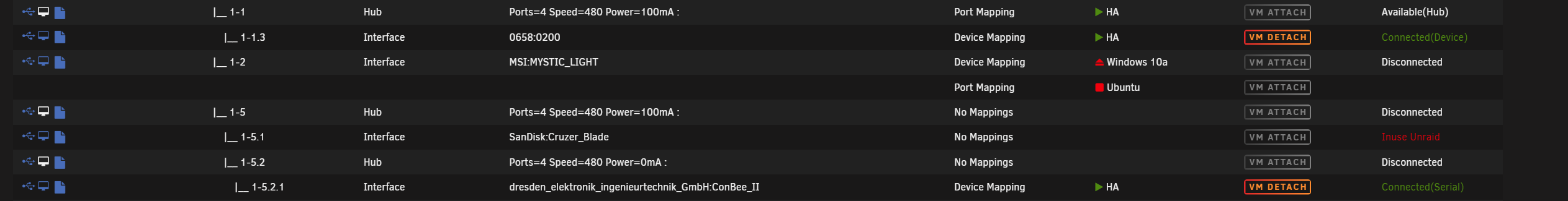

However, I toggled off 'Connect as Serial Only' for both USBs - to put them back into device mode - and it seems to be working ok now? unRAID shows "Connected(Device)" again for both USBs - see below. And as far as I can tell, Z-Wave JS and Zigbee2MQTT inside HA don't show any errors - and my Z-Wave and Zigbee devices seem to be all in working order and connected. What behavior/error should I be on the lookout for to determine if switching to 'Serial Only' is even required for me? Was that only needed for Conbee II, and doesn't apply to the types of USB devices I have?
In case it matters: In my specific case, my two USBs have the exact same controller/ID: "Silicon Labs CP210x UART Bridge". Does that preclude me from being able to run both as serial or something? Or does it mean I don't even need to bother with serial-only in the first place?

If you get a Virsh error if you hover over it will give more details.
Did you set each serial mapping to a unique device ID, defaults to 04 but they need to be different and also those need to be available on the guest.
Only device I know that needs to be serial is Conbee II

Can you expand on "needs to be available on the guest"? On one of my attempts, I thought I tried changing the 04 to 05 on one of the USBs, but it still didn't seem to work. Maybe there was an additional step I needed to take for the guest availability aspect?
Knowing that I'm not using Conbee II, are there other benefits of switching to serial-only? I'm starting to wonder if device-mode seems to work with my USBs in unRAID 6.10.3, should I just let it lie as-is?

The only benefit of serial and the reason I added it to the plugin is Conbee II doesnt seem to work correctly on later kernels if passed through as a device. My ZWAVE Stick is mapped as a device and works fine.
the following command will show the guest ports, replace Linux4 with your VM name.
root@computenode:/mnt/user/appdata# virsh qemu-monitor-command Linux4 --hmp info usb
  Device 0.2, Port 1, Speed 480 Mb/s, Product QEMU USB Tablet, ID: input0
  Device 0.0, Port 2, Speed 1.5 Mb/s, Product USB Host Device, ID: hostdev0
  Device 0.0, Port 3, Speed 1.5 Mb/s, Product USB Host Device, ID: hostdev1
root@computenode:/mnt/user/appdata# virsh qemu-monitor-command HA  --hmp info usb
  Device 0.2, Port 4, Speed 12 Mb/s, Product QEMU USB Serial, ID: ua-serial001011
  Device 0.2, Port 2, Speed 12 Mb/s, Product host:1.4, ID: hostdev0
If you have the USB option in the VM defined as
There are only 4 ports as I have on my HA vm. So Dev ID 5 will fail.
Hope that helps.
