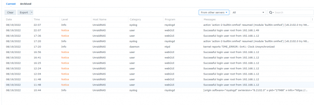

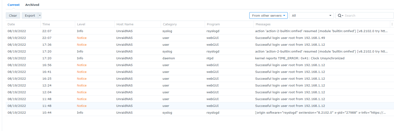

Dundee Posted August 20, 2022 Author Share Posted August 20, 2022 Thanks trurl! Yes, i was about to edit my post to add that i had setup syslog on my old synology but you have been faster I attached the diagnostics and also a screenshot of the syslog. unraidnas-diagnostics-20220819-2208.zip Quote Link to comment

Dundee Posted August 20, 2022 Author Share Posted August 20, 2022 It crashed during the night again after being up 2 hours. Almost nothing in the syslog. The TIME_ERROR came after ~30mins, but the server disappeared from the network 90mins later. I had the 3.0 bios version for my asrock motherboard. I saw that i should update, so i did 3 updates (3.0 --> 3.60 --> 5.30 --> 6.60). After a few problems, i now have the latest version. Hopefully it will fix everything All_2022-8-20-6_31_2.csv Quote Link to comment
