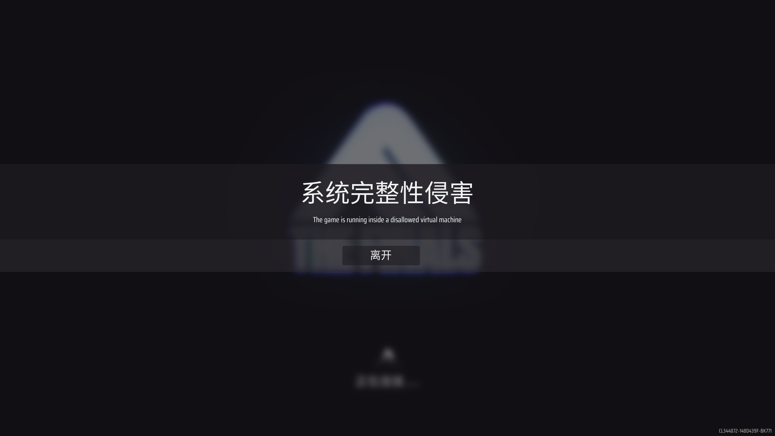

image.png?ex=654d5ab8&is=653ae5b8&hm=f92
I would like to add that i used the same fix outlined by everyone else in this thread and now i can play lost ark again!!! ( easy anti- cheat was keeping me from playing)
Thank you very much!

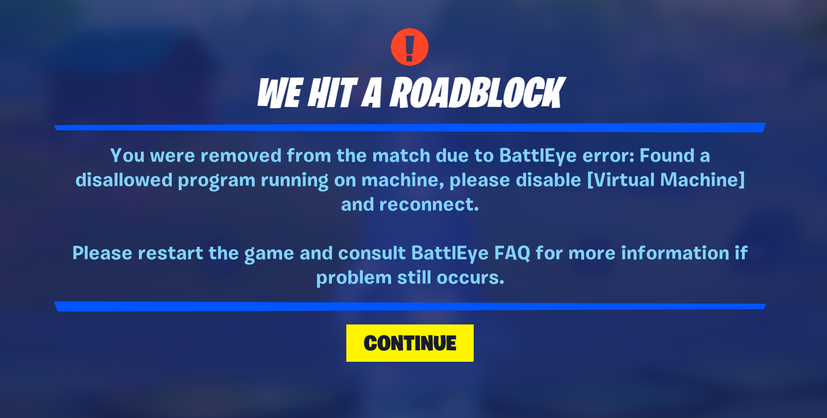

Hello guys,
I'm trying to play Fortnite and Rainbow six siege, but even with the solution you gave it's not working.
Is it still working for you ?
Thanks all 🙂
Edited by nwicone

The problem are games which are using BattleEye. With my current settings I cannot run games like PUBG. Games which use Easy Anticheat are working without issues.
Today I'm suddenly kicked out of the game again, while it has been working the last few days.
Indeed seems to be a BattleEye issue. Very annoying.
Trying to check how to force using Easy Anticheat.
