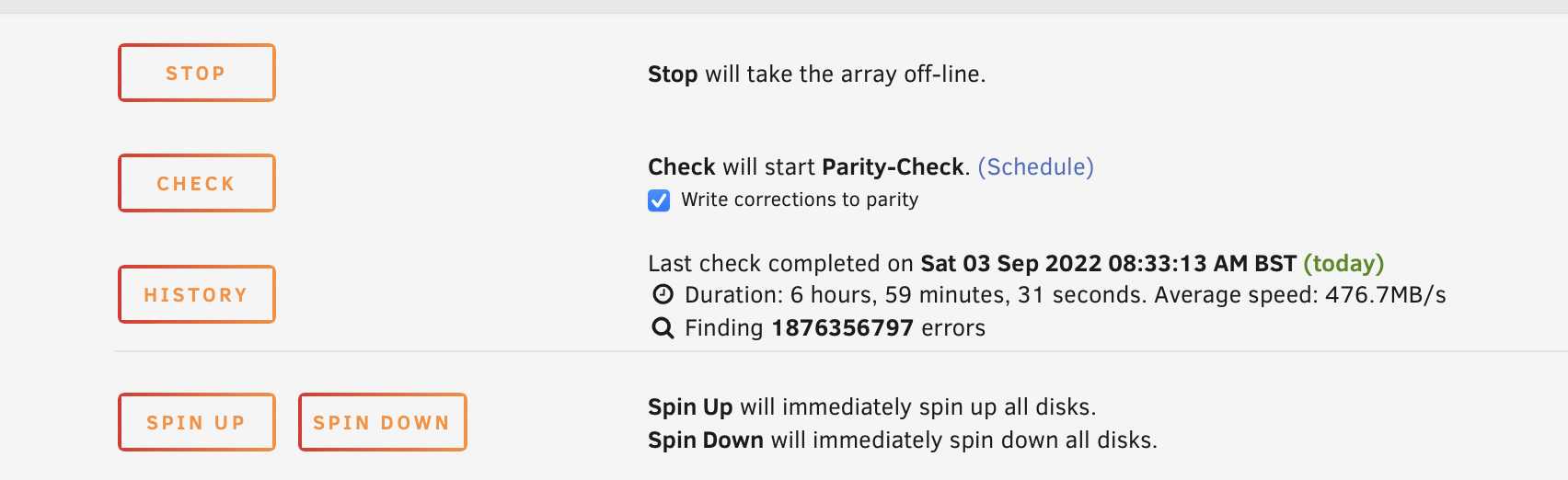

1,876,356,798 Parity Errors !?

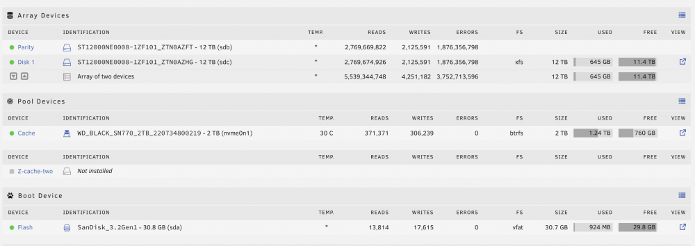

Fairly new build so no critical data.

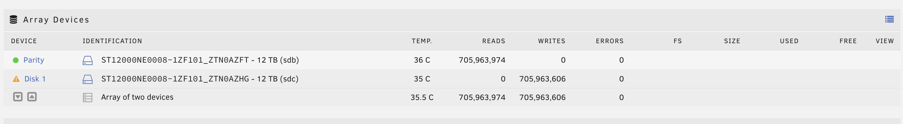

Ran 2nd parity check and it's showing 1,876,356,798 errors.
Same amount on the main disk1 & again on the parity drive...
Have I done something wrong?
Or is this normal for a new build?
Diagnostics attached

Those are read errors, not parity sync errors, there are issues with both disks:
Sep  3 06:41:20 Moulin-Rouge kernel: ata3: link is slow to respond, please be patient (ready=0)
Sep  3 06:41:20 Moulin-Rouge kernel: ata1: link is slow to respond, please be patient (ready=0)
Sep  3 06:41:24 Moulin-Rouge kernel: ata3: COMRESET failed (errno=-16)
Sep  3 06:41:24 Moulin-Rouge kernel: ata3: hard resetting link
Sep  3 06:41:24 Moulin-Rouge kernel: ata1: COMRESET failed (errno=-16)
Sep  3 06:41:24 Moulin-Rouge kernel: ata1: hard resetting link
Sep  3 06:41:29 Moulin-Rouge kernel: ata3: SATA link up 1.5 Gbps (SStatus 113 SControl 310)
Sep  3 06:41:29 Moulin-Rouge kernel: ata3.00: configured for UDMA/133
Sep  3 06:41:29 Moulin-Rouge kernel: ata3: EH complete
Sep  3 06:41:30 Moulin-Rouge kernel: ata1: SATA link up 6.0 Gbps (SStatus 133 SControl 300)
Sep  3 06:41:30 Moulin-Rouge kernel: ata1.00: configured for UDMA/133
Sep  3 06:41:30 Moulin-Rouge kernel: ata1: EH complete

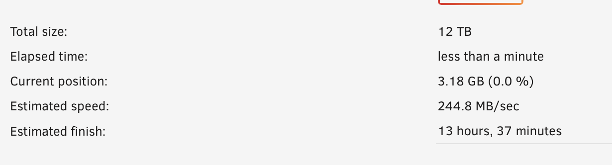

Looks like I will have to waste hours getting it to rebuild the drive (Rebuilding a drive onto itself)
https://wiki.unraid.net/Manual/Storage_Management#Rebuilding_a_drive_onto_itself

It's just completed the 13hour rebuild and was fine completed well. averaged 180MB/s.

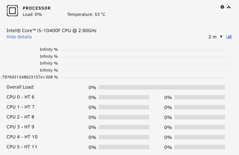

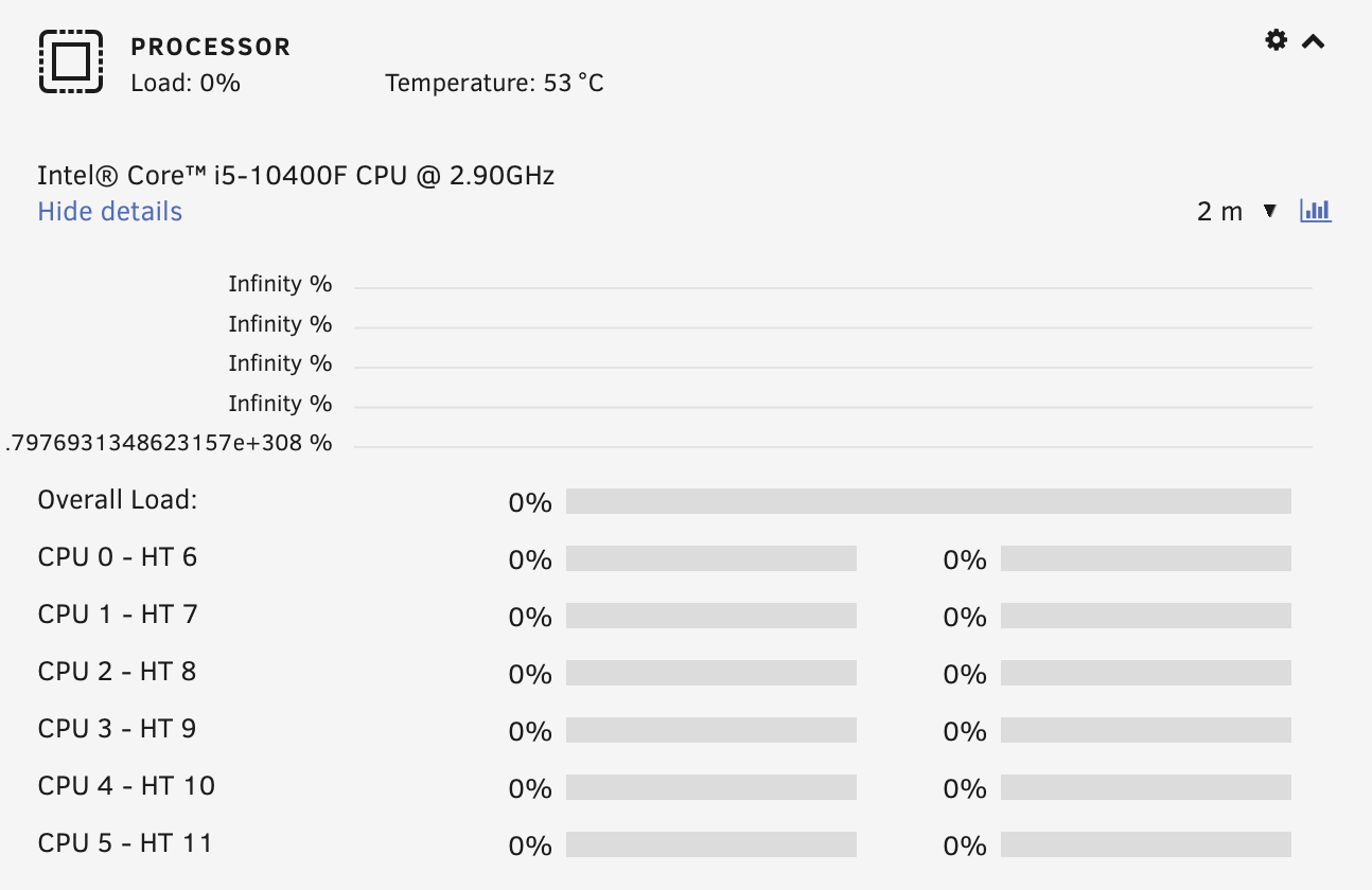

I then rebooted as I noticed on the dashboard it wasn't displaying the CPU usage.

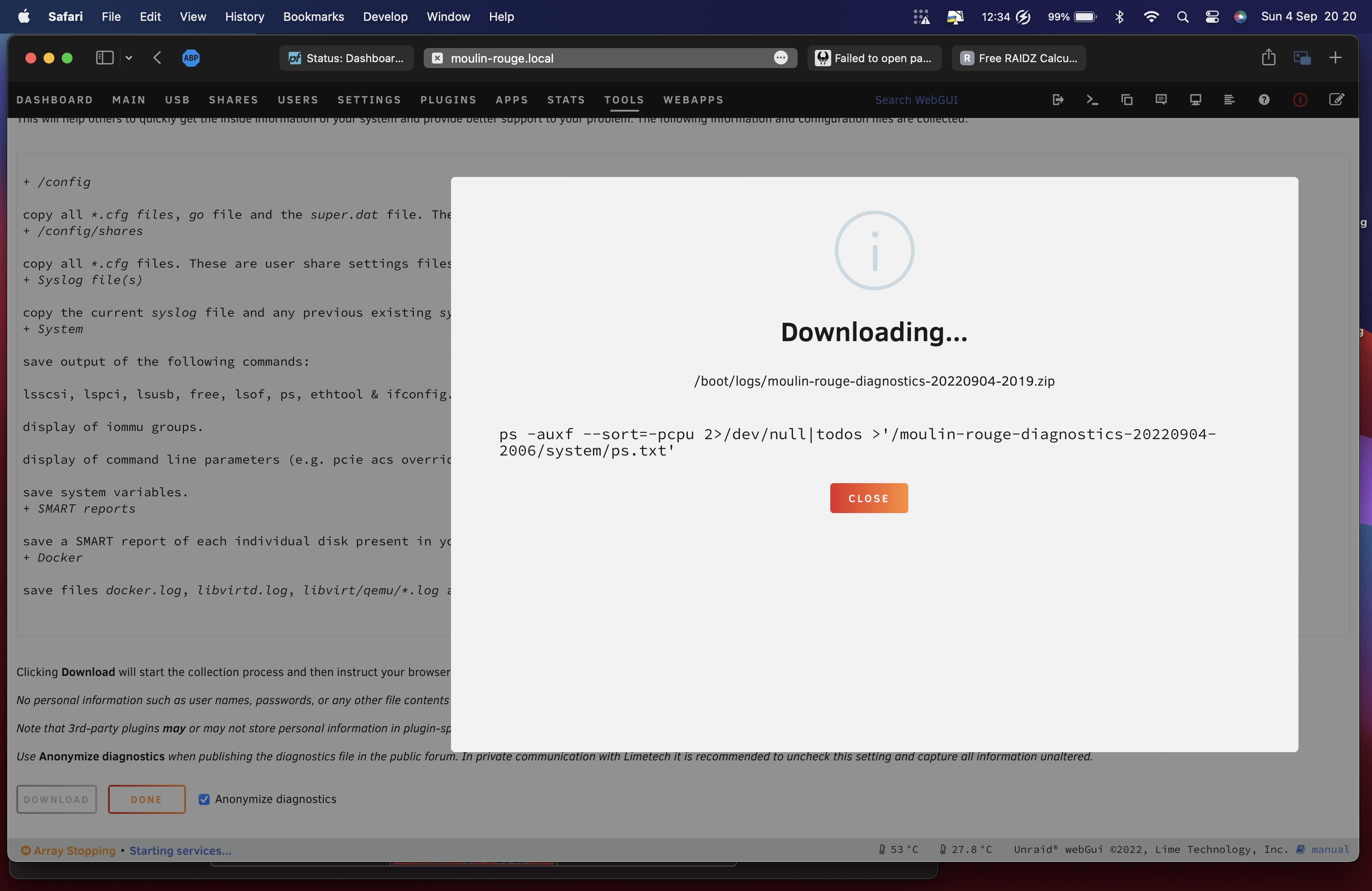

Now it says both disks are missing..
It won't do anything if I click to download the diagnostics.
Also it says bad gateway if I try to load the console..
I'm just attempting a boot via safe mode incase it is a plugin causing an issue.

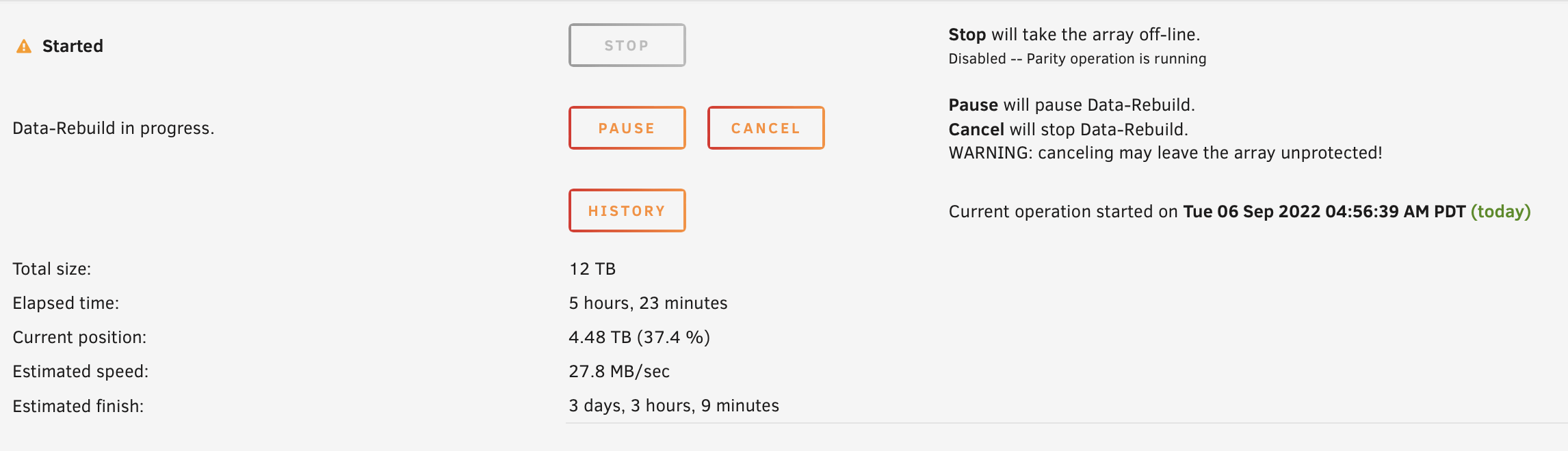

Urghhh.. It's halfway through the re-build.
Its at 37%.
Anyway right now noticing now in the logs it saying:
Sep  6 10:17:45 Tower kernel: ata4: COMRESET failed (errno=-16)
Sep  6 10:17:45 Tower kernel: ata1: COMRESET failed (errno=-16)
Sep  6 10:17:45 Tower kernel: ata1: hard resetting link
Sep  6 10:17:50 Tower kernel: ata4: SATA link up 3.0 Gbps (SStatus 123 SControl 320)
Sep  6 10:17:50 Tower kernel: ata4.00: configured for UDMA/133
Sep  6 10:17:50 Tower kernel: ata1: SATA link up 3.0 Gbps (SStatus 123 SControl 320)
rebuild has slowed down to 37MB/s from 240MB/s
422408079_Screenshot2022-09-06at18_28_52.thumb.png.9dc72222bb4043e040ca3be4e986731c.png

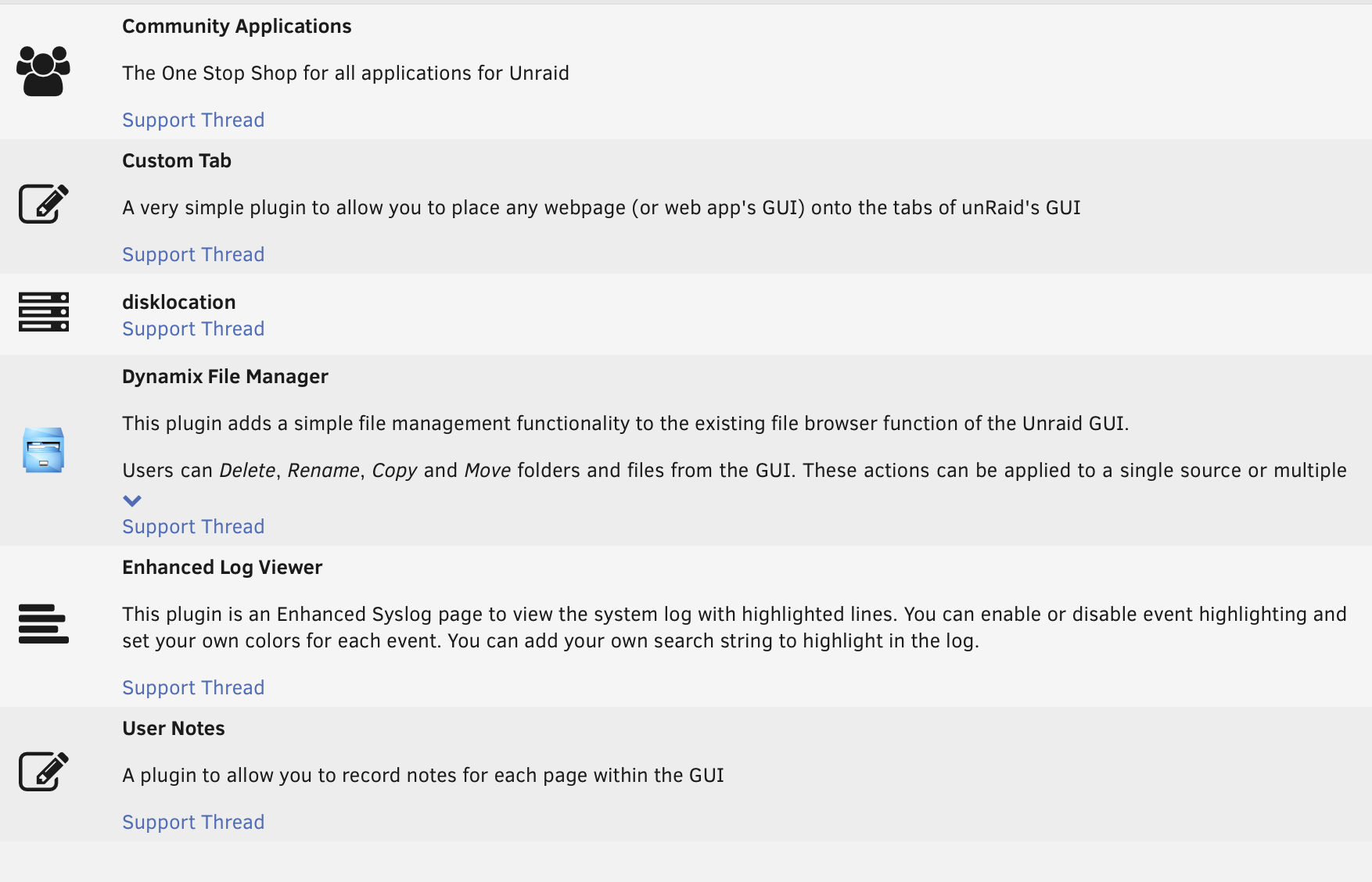

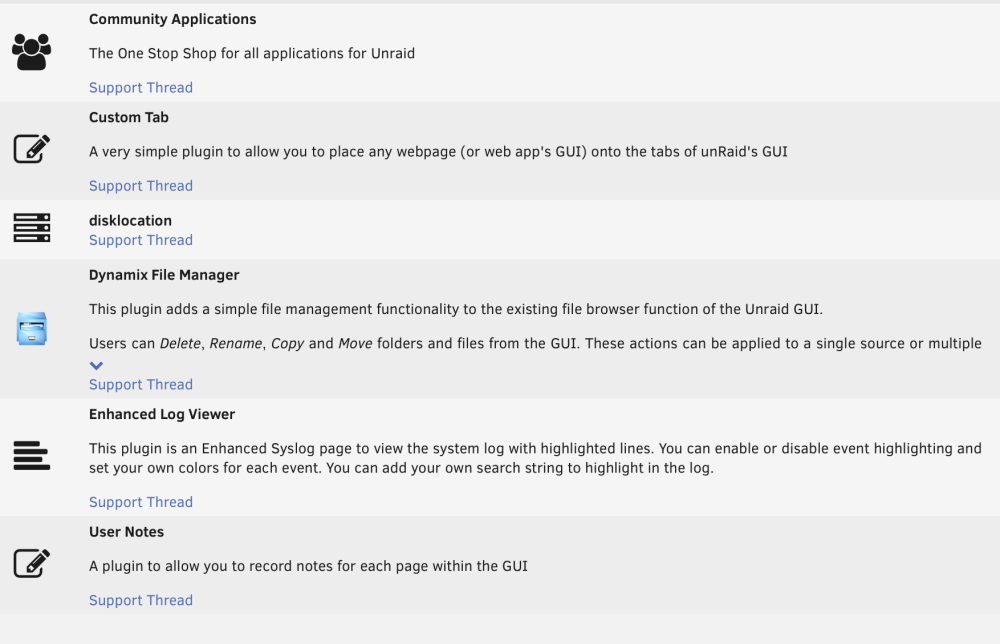

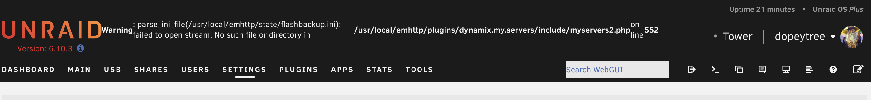

I think there is a bug in the latest my servers plugin... see screenshot.
