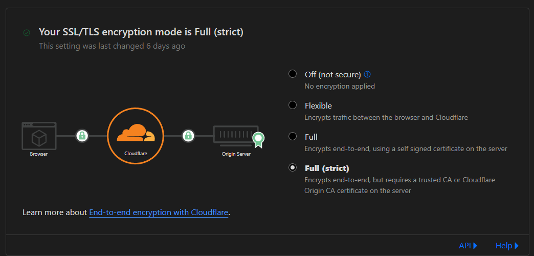

Hi
Just a little question (which isn't directly connected to your project)
when I set (public hostname) *.mydomain.com to (service) https://swag:443 it's working only if I check "No TLS Verify"
mydomain.com has a wildcard certificate by let's encrypt (which obviously isn't being used while using cloudflare proxy/tunnel)
my local host/ip (swag/192.168.X.X) doesn't have a certificate (do I need one? and if so, how to issue one?)
Thanks in advance
18 minutes ago, Omri said:
Hi
Thanks in advance

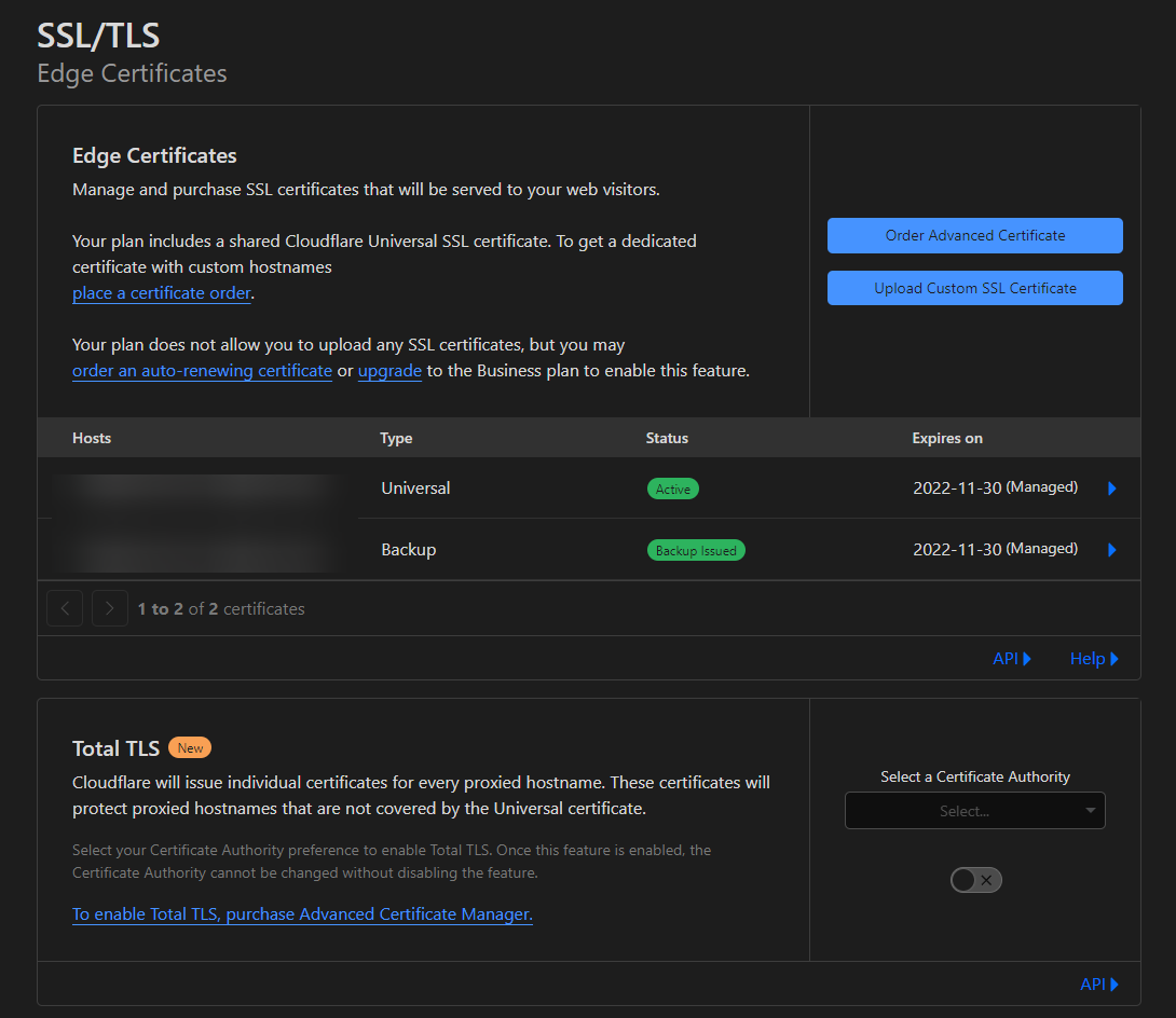

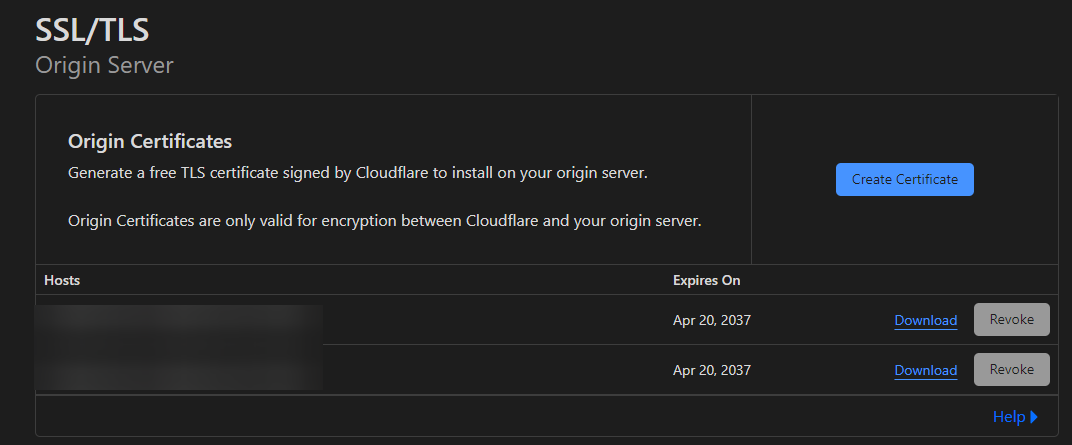

Hello, While I have not done this myself, I belive this can be done a couple of ways through cloudflares domain managment dashboard.
You can create or download existing certs as shown in the screenshot below and you can use these instead of the lets encrypt certs.
If you prefer to use the letsencrypt certs I believe you can also upload them to cloudflare, however it looks like this is a paid feature under cloudflare. (screenshot below)
You can also turn off SSL completly from cloudflare's side and only use letsencrpt however this will be globally across all subdomains (Not sure if thats what you are looking for)
The way I use the tunnel is by adding them without SSL with a HTTP connection and once you access through the subdomain cloudflare will encrpyt the connection via HTTPS with their certs. Hope this was helpful and if you have any more questions or need to clear anything up let me know :)

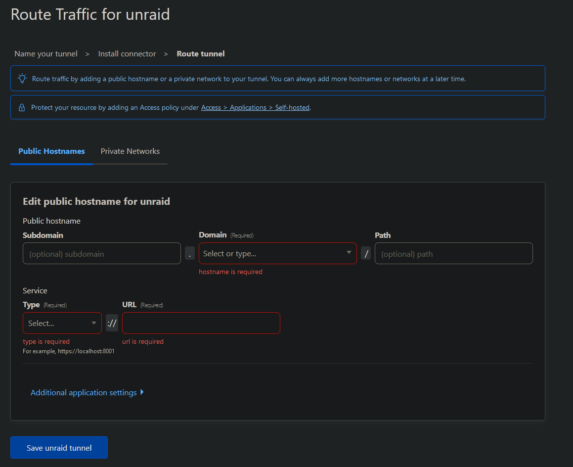

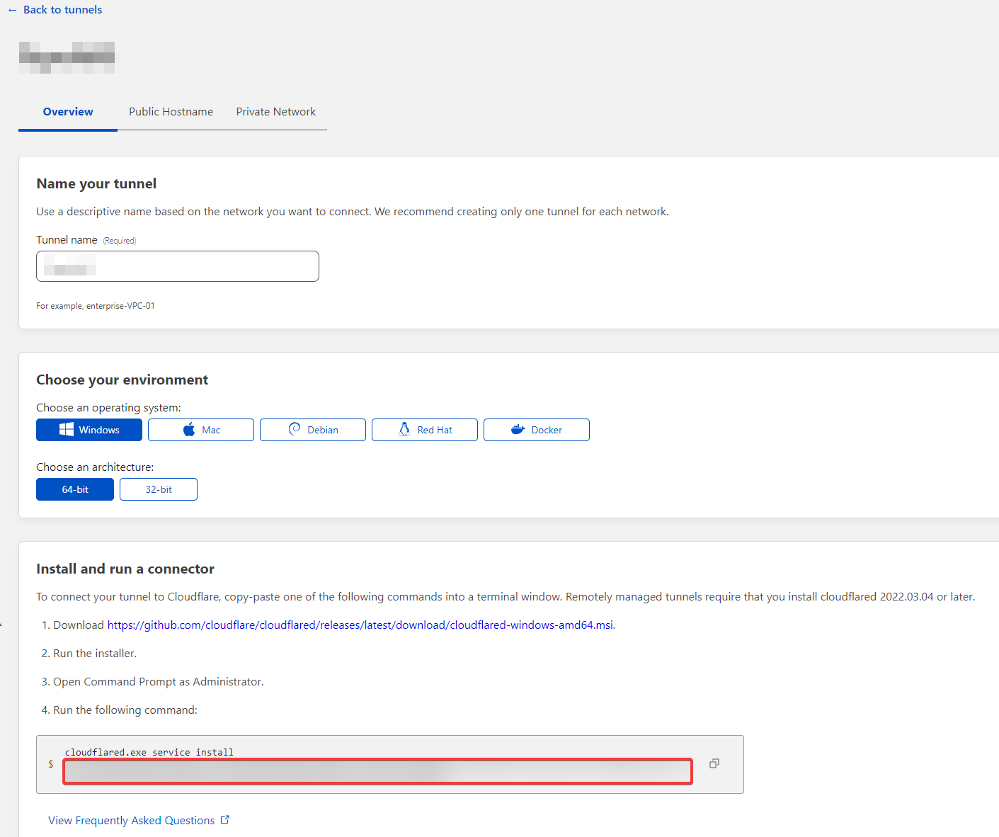

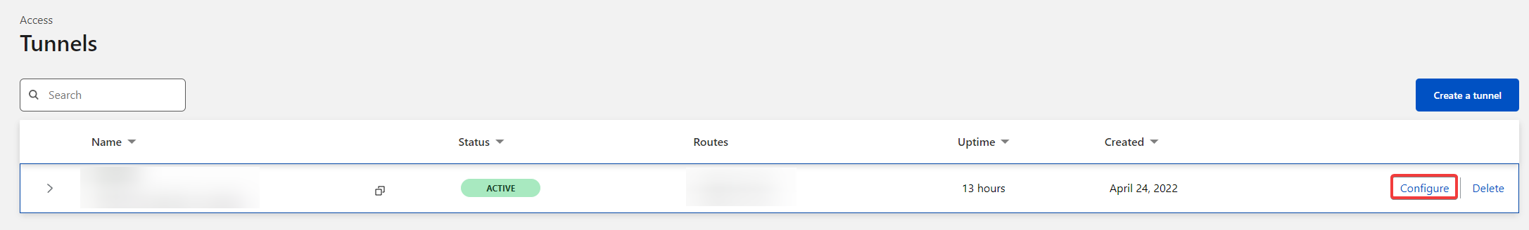

I'm assuming to get the token you go to setup docker tunnel in cloudflared first?
The next step is a bunch of inputs.  Apologies, but although I've gotten this working with a tunnel to my home assistant VM, I'm lost when it comes to setting this stuff correctly.
I got it working - in case it helps anyone else:
-the subdomain is what you want it to be to access publicly, domain is the selected path.
-the type can be http then the url to access your unraid instance locally (assumed static IP) e.g. 192.168.2.32
Glad you got it working just going to leave this here for other having issues finding their tokens. The token can be found in the blurred out portion in the second screenshot. You will need to get rid of the other text and make sure to only copy your token. It looks similar to the text in the first forum post here.

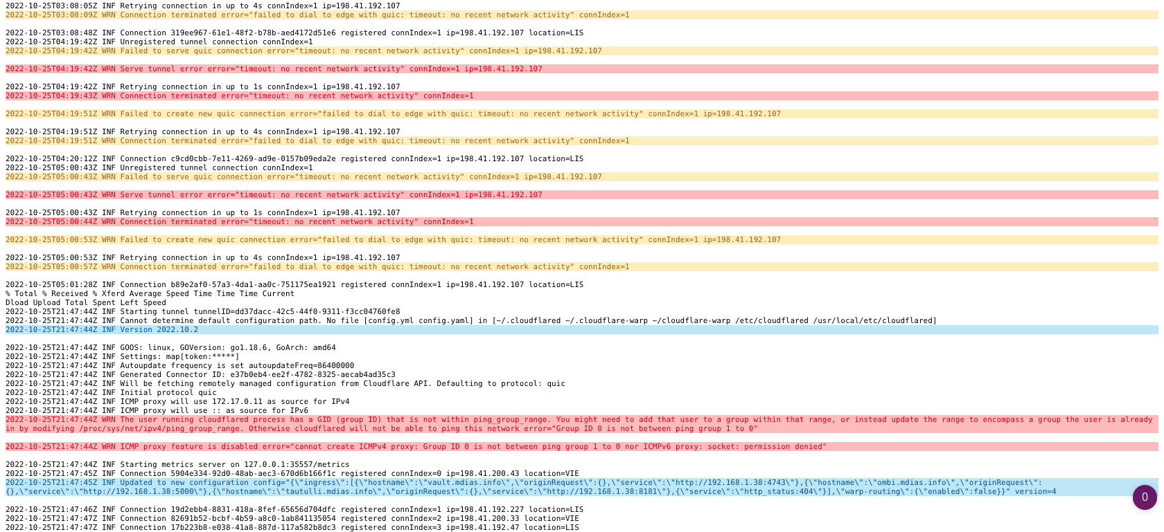

Hi @Figro, thank you for making this. I had this setup and it was working perfectly until a few hours ago. Now it's not loading the webpages at all.
I can still access the dockers locally, I didn't change anything on Cloudflare. The tunnel shows up as 'Active' and tunnel docker is up.
I restarted the docker and the logs now show what I've attached. But it still doesn't connect. They show some errors but I've really only noticed I couldn't connect a couple of hours ago. Any ideas?

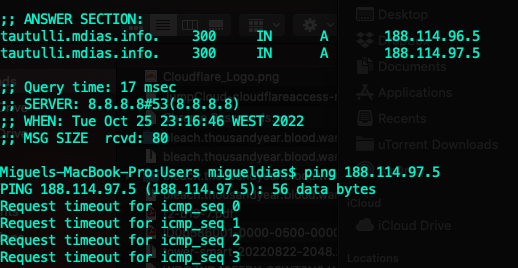

edit: Update. I can access the public hostnames fine outside of my home network. Still trying to figure it out.
edit2: So it seems I can't access the Cloudflare IPs of my tunnel endpoint from my home network. If I use my mobile connection, I am able to. I can't even ping.image.png.970ef2f916be740536a90683c0de9b8a.png
edit3: the IPs of the tunnel rotated and my DNS (Google) had stale entries. Updated to CF's DNS.
Edited by migueldias
Hello, Thanks for updating your post and sharing. Did the third edit fix your issue?
