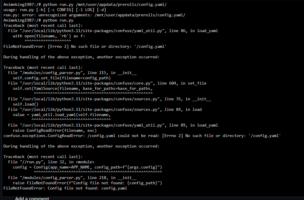

I cant get mine to work I get this error when I try to run it manually. My config file is there.
Edited by animeking1987
 As the error suggests, your command is incorrect. You need to provide the "-c" flag when providing a config file path. Use the following instead:
python run.py -c /mnt/user/appdata/prerolls/config.yaml
Also, please reserve this thread for discussion specifically about running this Community App as a Docker container on Unraid. For general questions about running the Python script directly, please open an issue on the project's GitHub page: https://github.com/nwithan8/plex-prerolls
Edited by grtgbln
