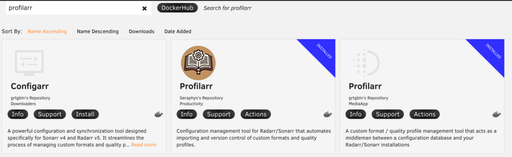

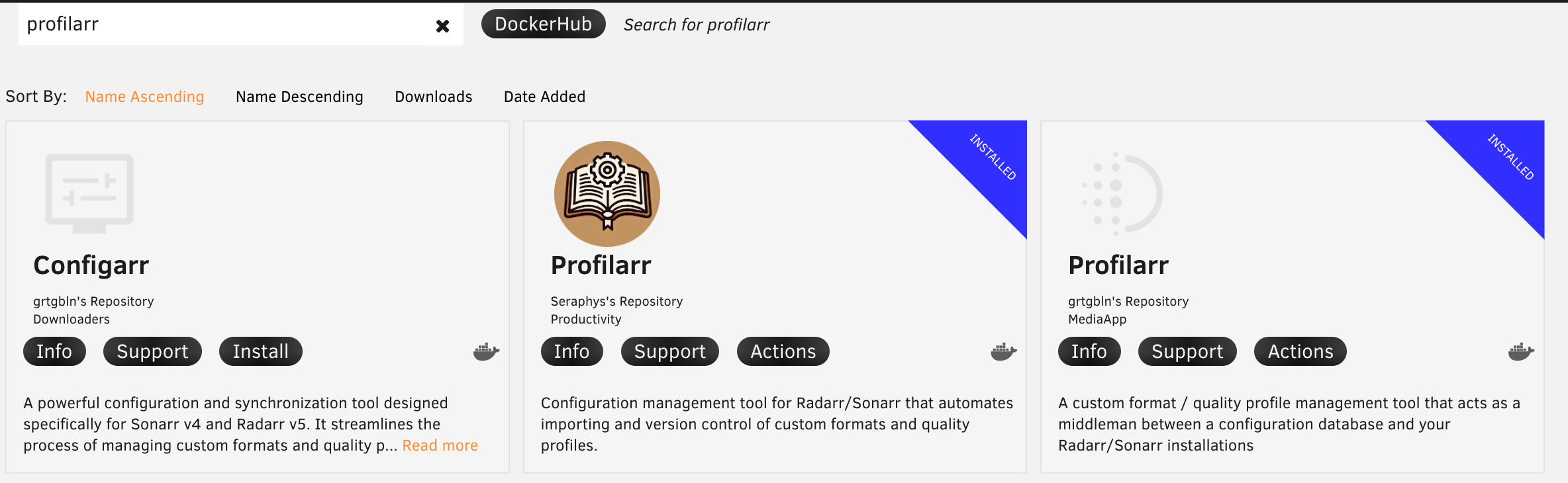

Hi @grtgbln,
When you have a moment, it appears that the configuration of your Community Apps Template for Profilarr utilizes the same configuration as the one from one of the Profilarr app developer's Seraphys.
After installing either instance, both show as installed even though only one has actually been installed (screenshot attached).
For context, I had no previous version of Profilarr installed when discovering this issue.
Let me know if you have any questions or need more information 😊
Edited by infiniterookie
8 hours ago, infiniterookie said:
Hi @grtgbln,
It looks like that other contributor published their template shortly after I published mine, but since they both use the same Docker image, the Community Apps store says both are installed on your system. The spirit of the CA Store is to not have duplicates of the same exact Docker image. Since Seraphys is one of the devs of Profilarr, I'll reach out to them about deprecating my version and handing over official control to them. Thanks for letting me know.
