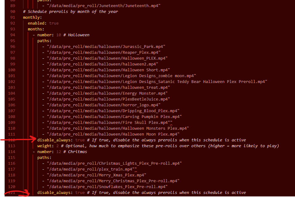

question for the plex pre-roll
i have a pre-roll setup and I'm trying to setup my normal pre-rolls to be removed when special holidays roll around (Halloween, Christmas, etc..._) but re-added after they end. how do I accomplish that?
Config Link: https://dpaste.org/xwK61
Use `disable_always` for those Holiday schedules: https://github.com/nwithan8/plex-prerolls?tab=readme-ov-file#disable-always

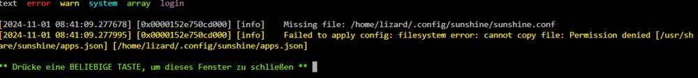

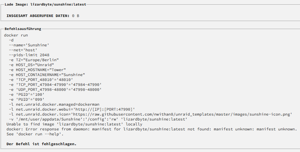

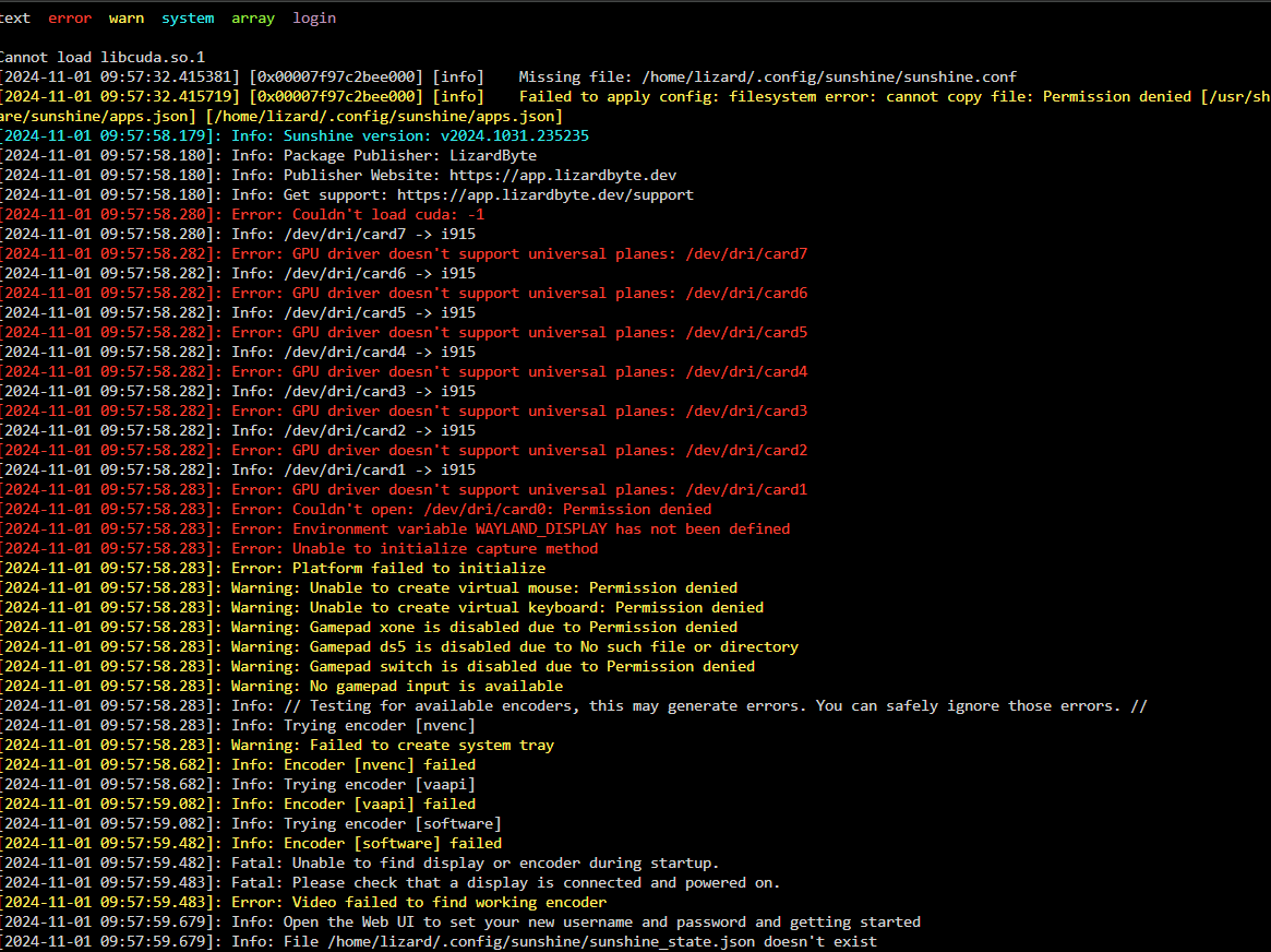

Hey i was very happy to see your sunshine docker in unraid. I have problems with downloading and starting it. Default template is even not downloadable. Can you check it again? I can help if needed.
I'm chatting with the Sunshine devs currently to investigate similar reports, although I haven't heard about issues with downloading the image, that's new to me. What tag is it attempting to download (which branch did you select)?
sorry for my late answer now. If im install lizardbyte/sunshine:latest thats the first then nothing will be downloaded. The other branches will be downloaded and info log says it is started, but if i go to the dockers its stopped. with this log:
On Main latest branch it looks like this:
There you can see latest not found
Edit: Sorry i saw i need to give permissions for the folder of Sunshine to read/save. Then the docker is started. But now i have this:
Edited by sam90

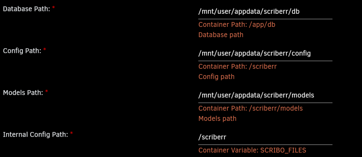

Not sure if you'd be able to assist on this or if it's more a question to the devs of scriberr, but since i updated, i was able to get it going, and it works after the inital install, but when i made some updates and restarted the container, it ended up not being able to find pyannote/whisper, it's almost like it's being deleted after restart but i could be wrong, as i don't have much knowledge on docker. I've also tried defining PUID/PGID/UMASK as extra variables but it didn't help.
I do have a cache drive that my appdata folder resides on, but i haven't had this issue with any of the other templates/containers i use.
Error:
DEV MODE -----> false
stderr: Traceback (most recent call last):
  File "/app/./diarize/local.py", line 2, in <module>
    from pyannote.audio import Pipeline
ModuleNotFoundError: No module named 'pyannote'
I'm not even sure where the /app/ directory is, i've tried looking for it in the setup directories but no luck. 9958492E-A5C2-49A9-A555-534FE1F8F7C0.thumb.png.18c9c0f5ae186eb069376410899984f0.png
Error:
Hmm, I don't immediately see any issue in terms of paths. The Docker mapped paths don't seem like they should be conflicting with any internal paths (although it is odd that the path of the Python file that's being called goes down a level into /app, only then to go back up a level and then down again into /diarize), so this might be something to take up with the Scriberr devs
