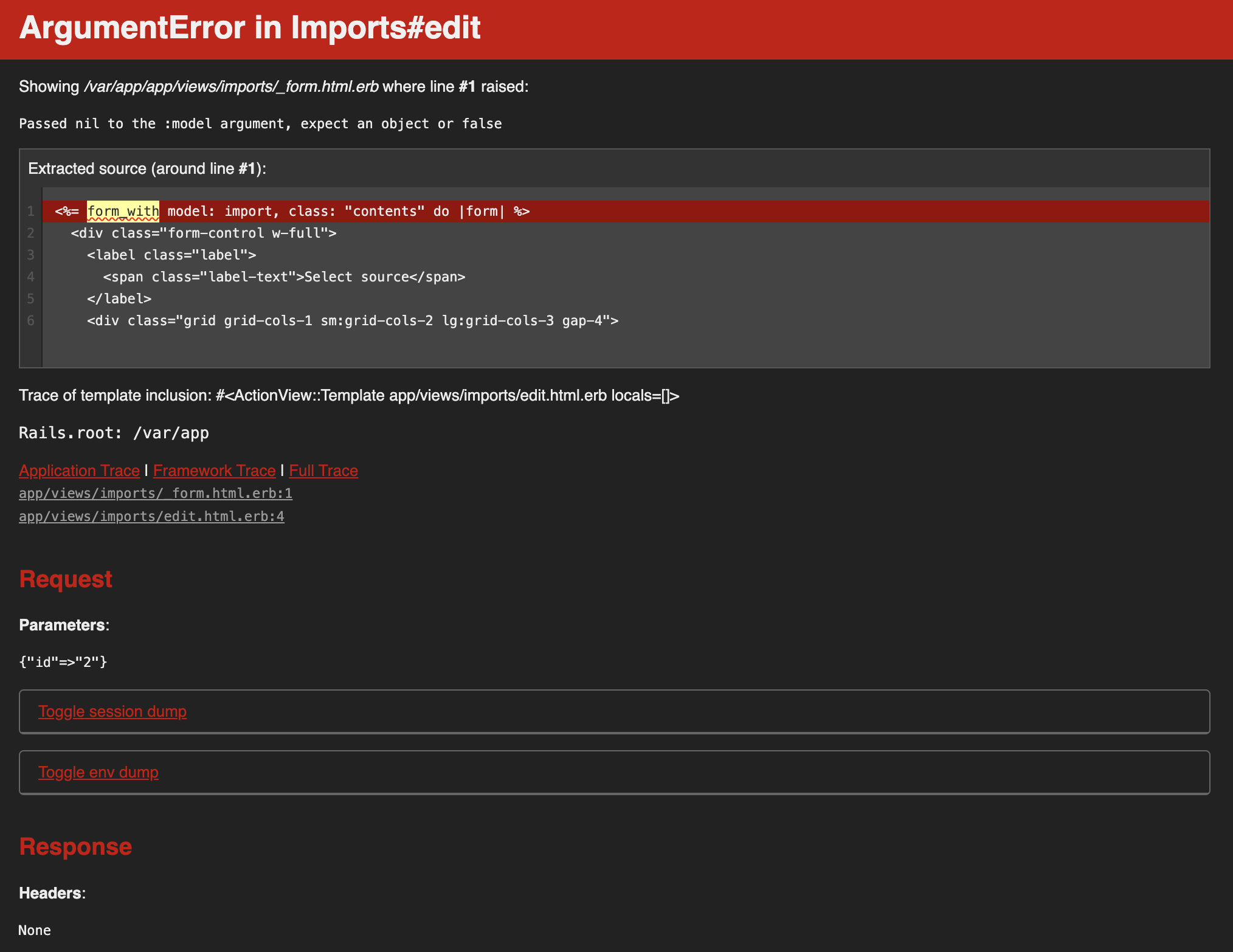

Hi all,
I am trying to get the dawarich template to work and it's really a tough one. As I was able to some parts if it to work it still seems pretty bumpy and on some areas I am stuck:
1. It seems that the sidekiq-docker is a mandatory part of the whole setup (without it, my installation didn't import any gpx-files) however I don't understand why it's to seperate unraid community templates which cover almost identical values. In the docker-compose from dawarich both applications are packaged into one file. While I have no idea about unraid community templates there's probably a reason for it. However it would be amazing to get a better understanding what the sidekiq-template is needed for.
2. The install has some flaws. E.g. after the installation some manual db migration needs to be triggered via the shell.. this is pretty straight forward but it's not documented anywhere.
3. The initial user (as mentioned in the dawarich instructions) seems to be missing. While I found a way to add a user via the console (https://github.com/Freika/dawarich/issues/660) it would be cool to fix it.
4. Once I was able to login and import data I would stll get a pretty ugly rail-error-message when I clicked on the Edit button within a gps import (https://mydawarich.domain/imports/2/edit). See attached screenshot.
In a nutshell: It could very well be that all this issues are caused by my lacking unraid-skills, but a short manual which highlights some specifics around this template would be amazing.
Thanks so much!
Cheers,
quicky
4 hours ago, quicky said:
Hi all,
Thanks so much!
Cheers,
quicky
1. The main application and the Sidekiq are very similar in terms of their environmental variables, and even use the same exact Docker image. The main difference between the two is the startup command (visible under "Post Arguments" in Advanced View), which trigger the container to either be a main server or a Sidekiq instance. The Docker Compose file for Dawarich has both containers configured, and in terms of Unraid, one template equates to one (and only one) Docker container. Hence, why both templates have to be installed as two separate "apps".
2-4. I understand that there have been some issues with the applications themselves in terms of the database setup process. As far as I can tell, this is not specific this Unraid template or running the Docker container on Unraid, and is an issue with the upstream application. I am keeping a close eye on various issue threads on the project's GitHub page for any updates, and am in communication with the developers about any changes needed for the template, including potentially transferring ownership of the Unraid template to the Dawarich team.
Thanks for the fast reply and thanks for the clarification. Just to make sure: I am absolutely happy to support the development and do some more testing if this helps. Also I can give some structured guidelines on how I got it to work (however I have no idea if most a the flaws that I saw were based on a lack of knowledge.
So currently I have it up and running and it looked as I overcame most of the mentioned issues apart from the last one (where I provided a screenshot) and another one which I forgot to mention in my initial post:
When you start the container for the first time and do the final steps like the creation of the db and setting up the user everything seems to work until you stop the container for the first time. After that it won't start up again. The logfile says that it won't start the server again because an instance is already running (it even gives me the PID of that server). After some research I found out that this is because the server wrote some file into a tmp-folder within the docker. However I can't delete this file as I can't access the content of the cointer because it doesn't start up.
Maybe this info also helps to get the template optimized... and again, feel free to PM me if I can be of any help with testing.

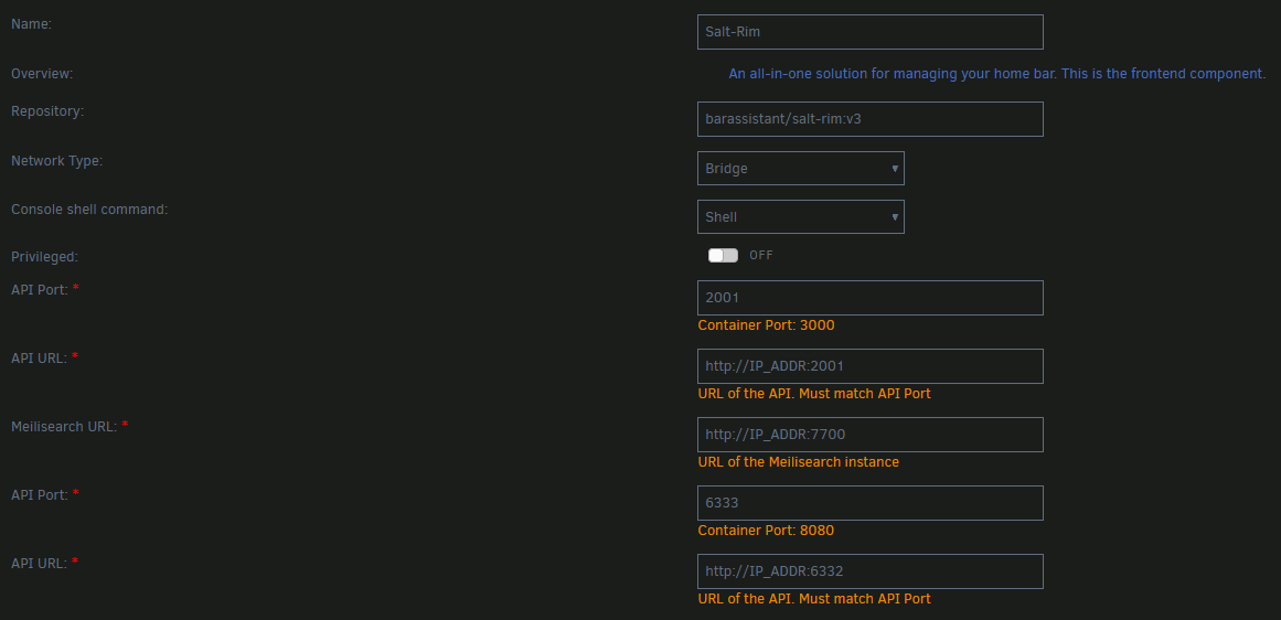

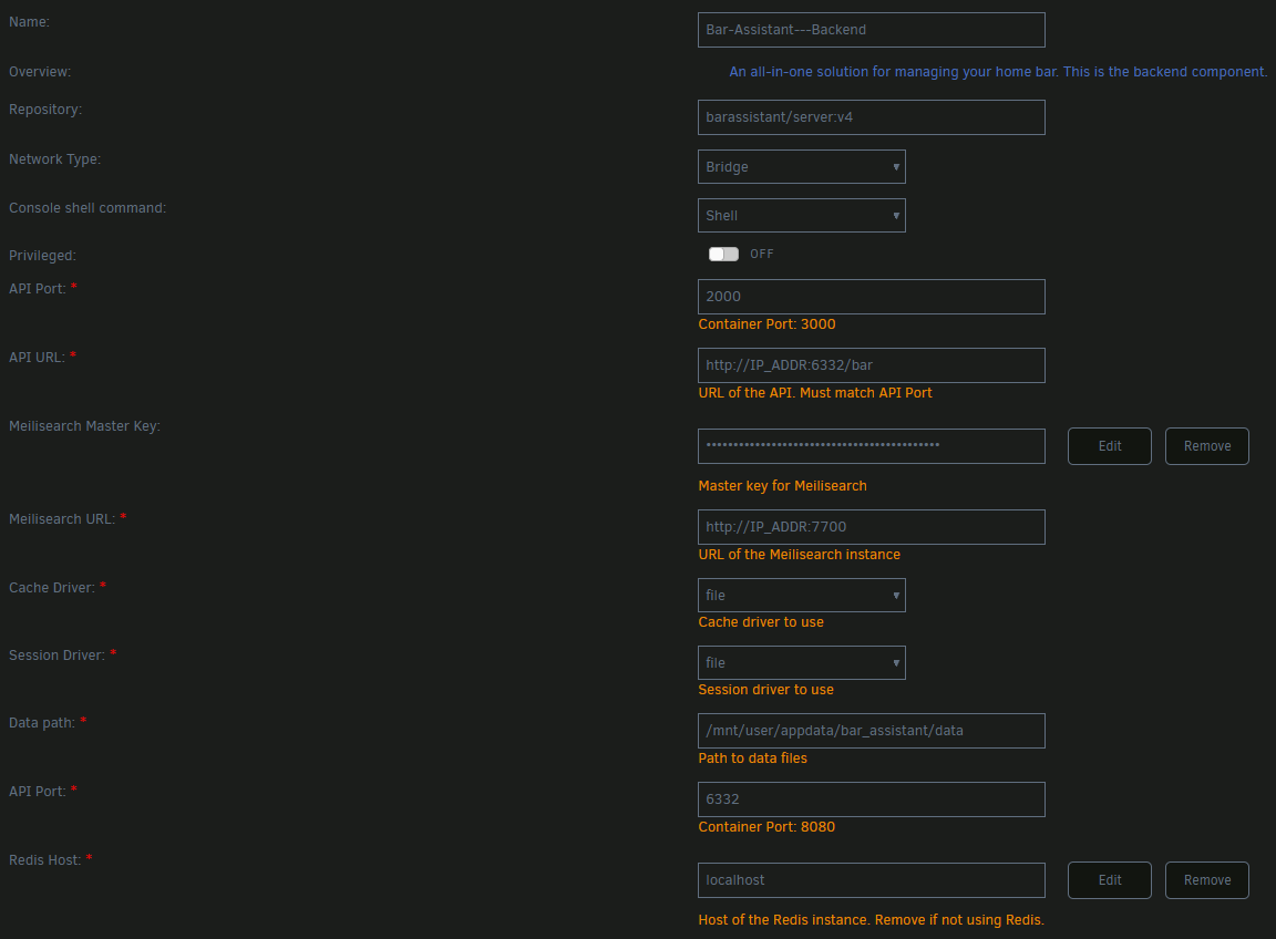

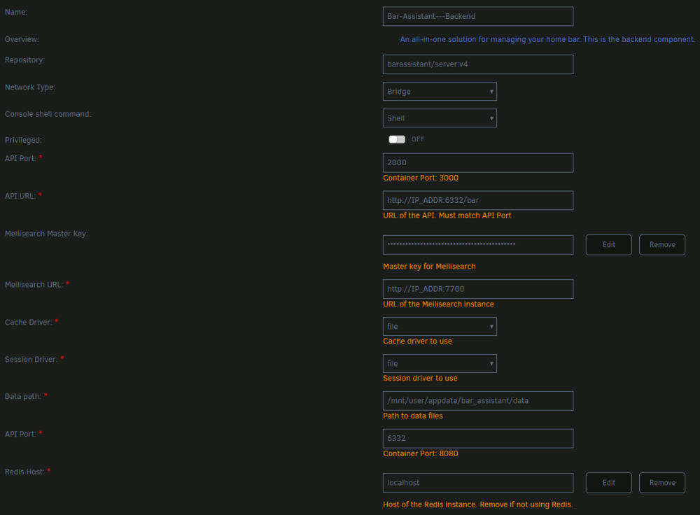

On 1/13/2025 at 5:25 PM, grtgbln said:
Looking at some issues on their GitHub, it looks like they switched from 3000 to 8080 for the API. To clarify, you made the following edits:
- Added Port 8080 mapping to Bar Assistant Backend to [B XXXX] (some unused host port)
- Changed API_URL to http://IP_ADDRESS:[B XXXX]/bar on Bar Assistant Backend
- Added API_URL variable (http://IP_ADDRESS:[B XXXX]/bar) to Salt-Rim
- Added Port 8080 mapping to Salt-Rim to [F XXXX] (some unused host port)
- Changed web UI port on Salt-Rim to map to 8080
If that is all correct, it seems like the backend is using port 8080 instead of 3000, and APP_URL on Salt-Rim should really be API_URL. And then the front-end Salt-Rim is using its own 8080 port as its web UI.
If you can confirm, I'll update the templates accordingly.
Sorry for the delay in confirming these, things got a bit busy. Your summations are correct, though I don't know if everything I did is necessary as I was just playing around and not really digging deep into container implementations; but I was able to get both the Bar-Assistant--Backend and Salt-Rim up and running and communicating with each other using those changes
Here is a screenshot of my backend config: image.thumb.png.3345cbc9fdad8dd95c558230a8a86524.pngand here is a screenshot of the Salt-Rim config: image.thumb.png.1674487205d870da0f84fcbe96f43c70.png

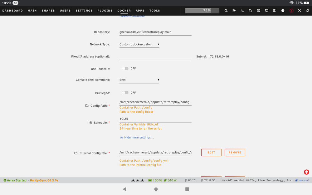

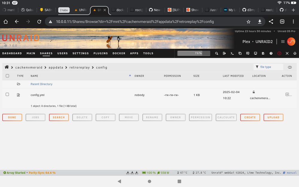

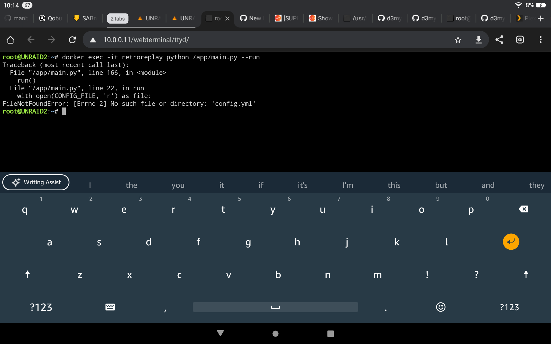

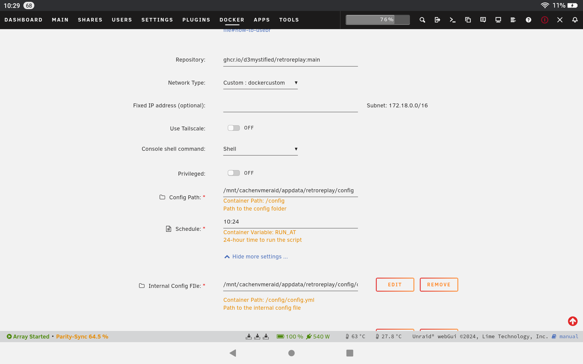

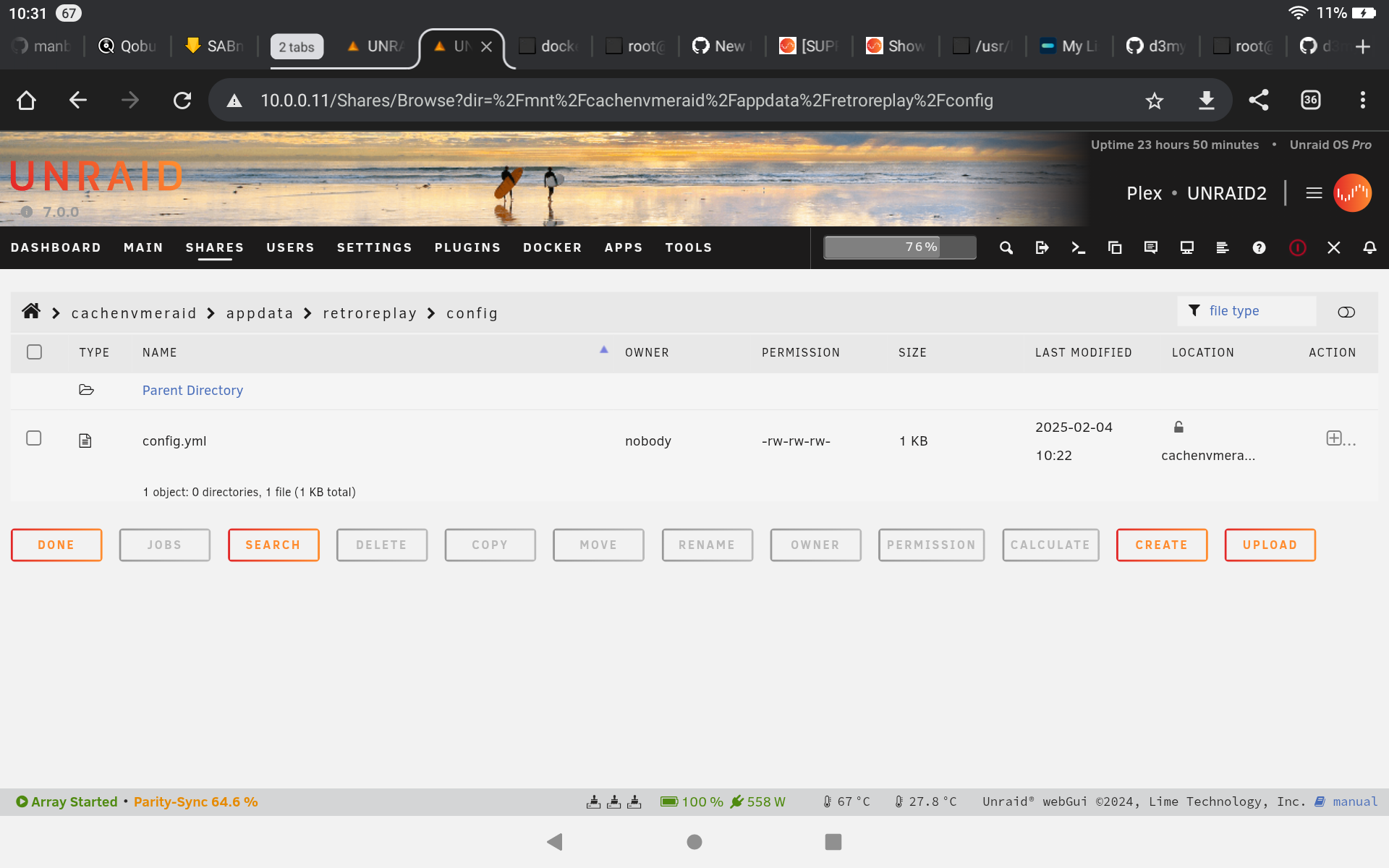

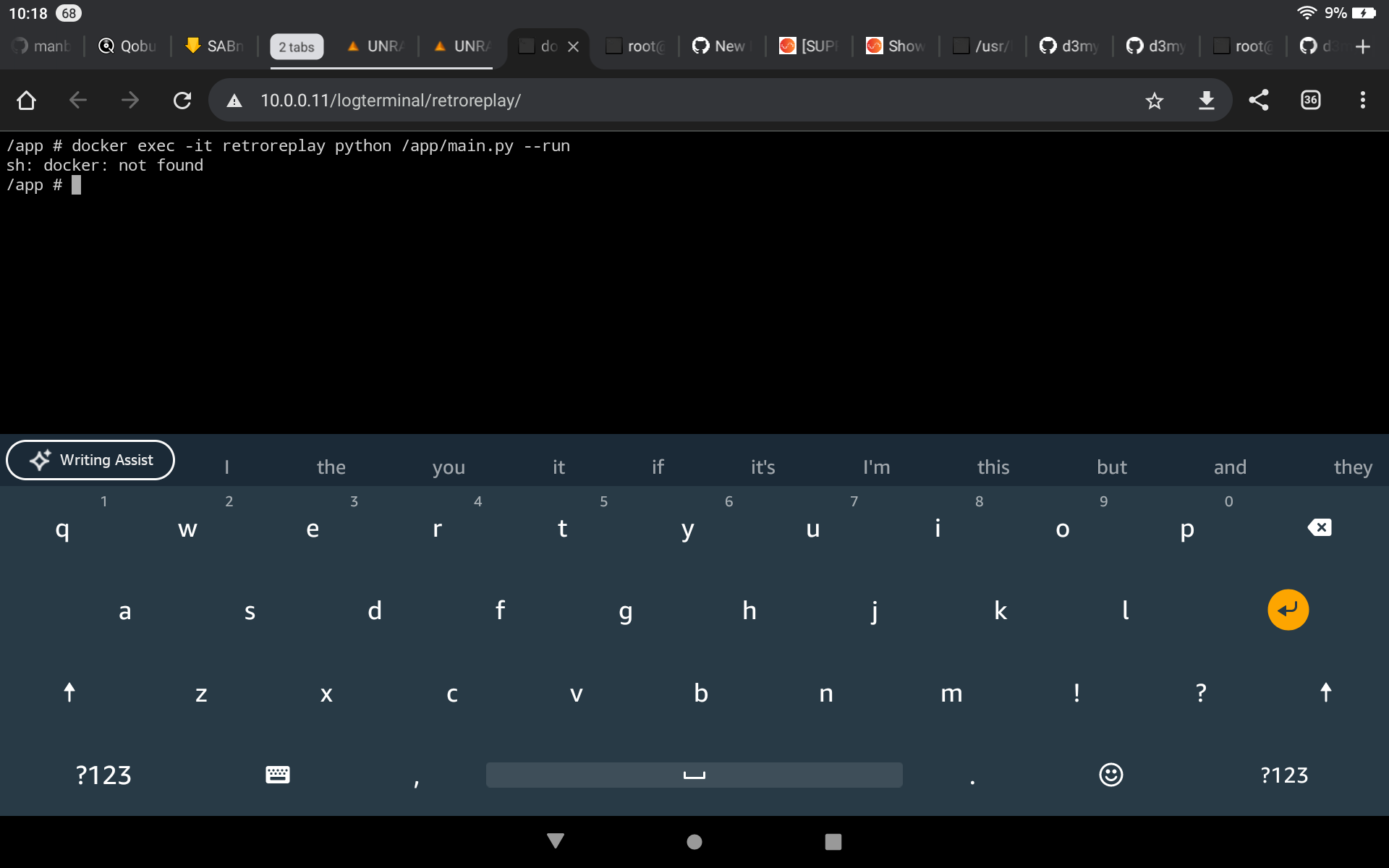

RetroReplay on unraid 7.0.0
I'm not having any luck installing this, could you give more instructions
Only thing log says. (I've set time in advance several times)
It's 09:43 AM. Waiting for next run at 09:44 AM
docker exec -it retroreplay python /app/main.py --run
Does not work (I changed my rocker name to all lower case like command)
tried in docker console and unraid console
Should plex url In config have port ? http://10.0.0.11:32400
I don't know what else to try

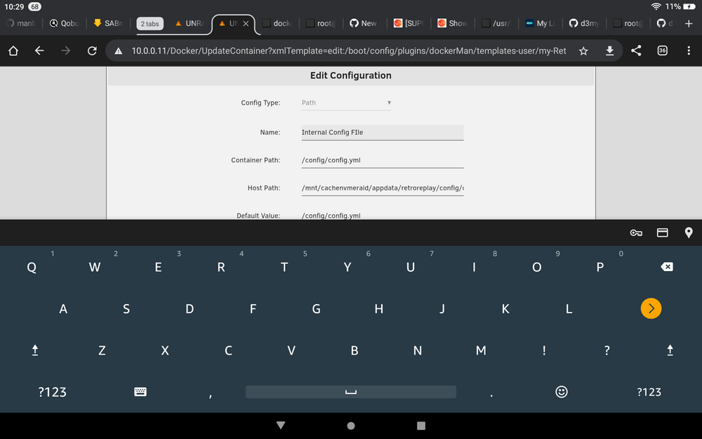

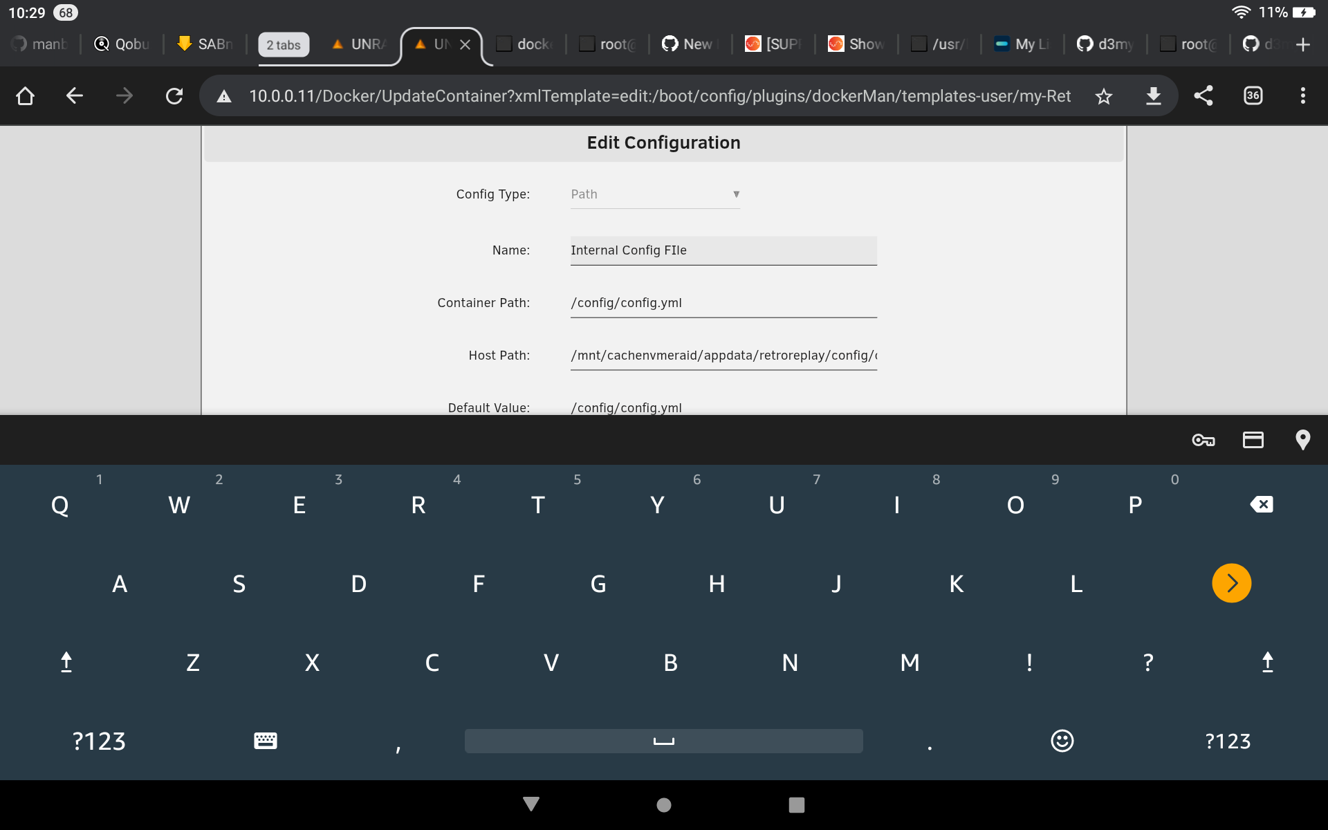

Sorry, bug in the template from a bad copy-pasta, pushing out an update.
If you'd like to fix it on your end in the meantime, delete the current "Internal Config File" entry and add a new one with the following details:
Notably, the "Config Type" needs to be a "Variable", not a "Path".
Edited by grtgbln
