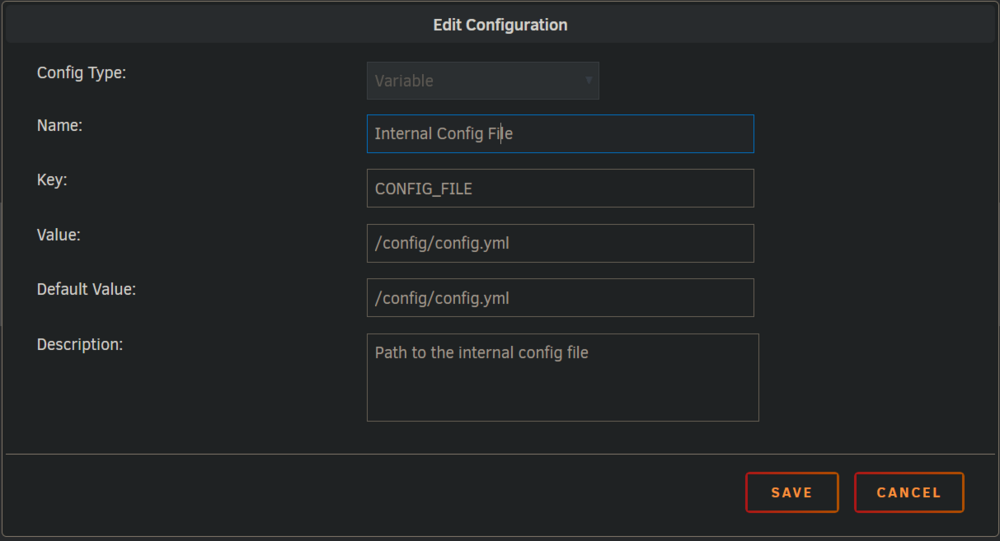

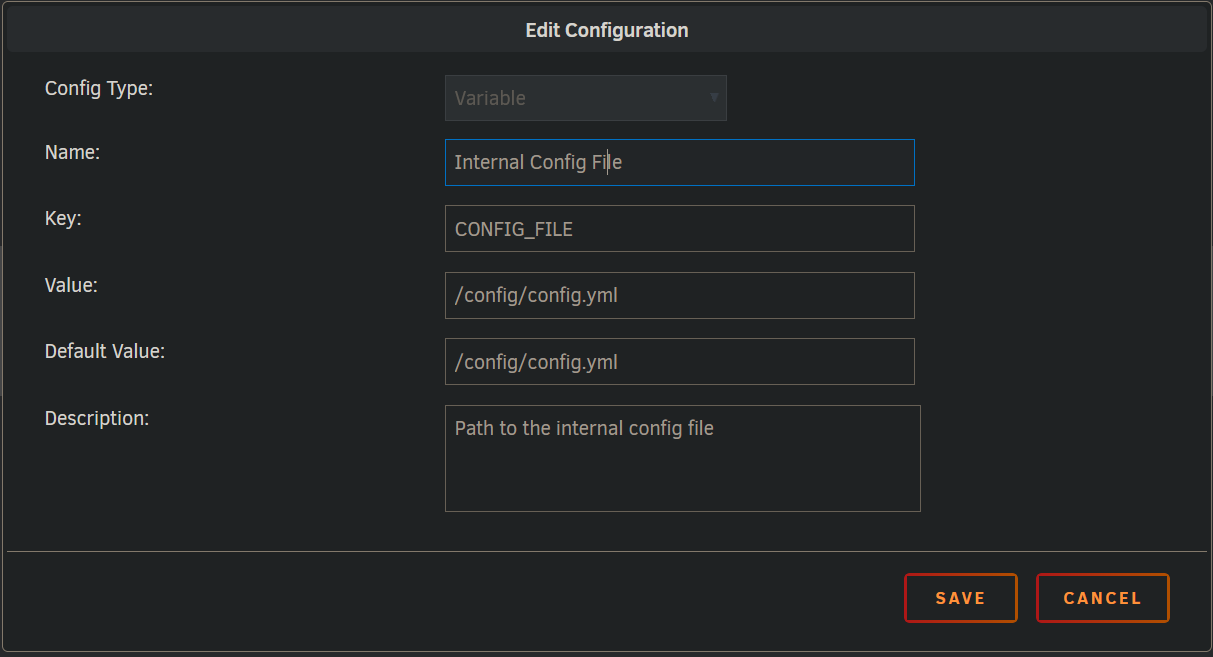

5 hours ago, grtgbln said:
Sorry, bug in the template from a bad copy-pasta, pushing out an update.
If you'd like to fix it on your end in the meantime, delete the current "Internal Config File" entry and add a new one with the following details:
Notably, the "Config Type" needs to be a "Variable", not a "Path".
Thanks, that was it. Working now

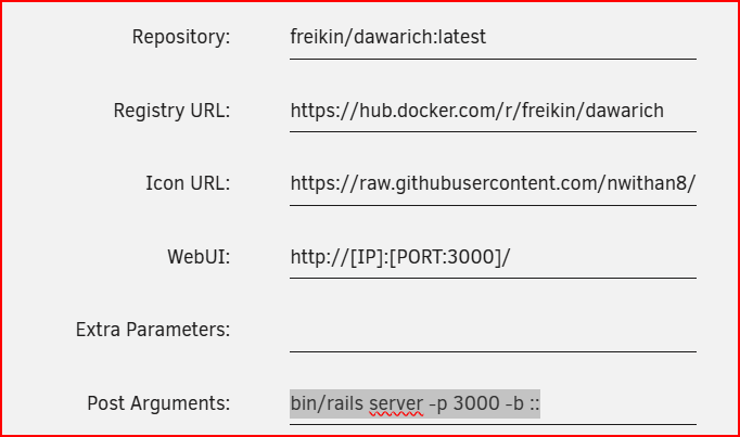

there was the issue with restarting the Dawarich Main container. Last week I tried out some settings and I think I got it running now. Maybe you could try out the "Post Arguments":
bin/rails server -p 3000 -b ::
with these settings restarting the container after it stopped is working for me. Maybe you could also update the Template accordingly.
Thanks 🙂

Fixed, updated template should be available soon, thanks for diagnosing this!

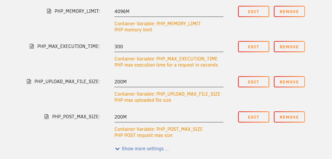

Help with the WebTrees Container
I am trying to add Geolocation data to the container and after uploading some CSV files from the application website for region USA, I run into the following error:
Allowed memory size of 134217728 bytes exhausted (tried to allocate 20480 bytes)
/var/www/html/vendor/illuminate/database/Connection.php: 414
I have tried adding PHP variables based on some information I have been able to dig up but those settings have not taken affect in the container. I believe the issue is because the MariaDB tables increase in size after adding all the location information and the PHP setting runs over the Max Limit.
Is there a way to increase the PHP configuration variables like Memory Limit and Max Execution time etc? I believe they are built at compile time and there may be an option to make these configurable.
@grtgbln, Can you please help?

2 hours ago, grtgbln said:
LimeTech is not involved in specific Docker container-related issues, so they are the wrong team to reach out to for that.
The source code for WebTrees is maintained by H2CK on GitHub, though the Docker container for it is published on Docker Hub by "dtjs48jkt", who I assume is a different user simply publishing the image on H2CK's behalf.
This sounds like an issue in the container itself in terms of PHP configuration and/or how the app interacts with the config. I would recommend reaching out to H2CK on the GitHub repository to report the issue. I am not personally a PHP dev, so unless there's something that needs to be changed on a Docker level, I am not going to be much help.
@grtgblnThanks for the response. On the docker level, is there a way to expose the PHP configuration used in the docker? I can see what the configuration is, but I do not yet know how to modify it.
I will reach out to both parties as you suggested. Also, for LimeTech, the question was not related to any docker but I had asked that in general, does UNRaid support user defined PHP configurations as that may be necessary for self hosting other apps etc.
You can map the php.ini file inside the container to a file on the host machine through a mapped path. Looks like it might be at `/etc/php/8.3/apache2/pho.ini` inside the container: https://github.com/H2CK/webtrees/blob/webtrees-2.2/Dockerfile#L95
Thanks for the suggestion, I finally got it to work.
I had tried mapping the apache2 folder before posting here, but it would not map for whatever reason. Based on your suggestion, I created a copy of the php.ini configuration file from inside the container and added it to the mounted apache2 folder. I then edited the file to reflect the changes I wanted to make.
It works now! Thanks again @grtgbln
