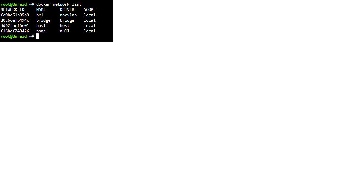

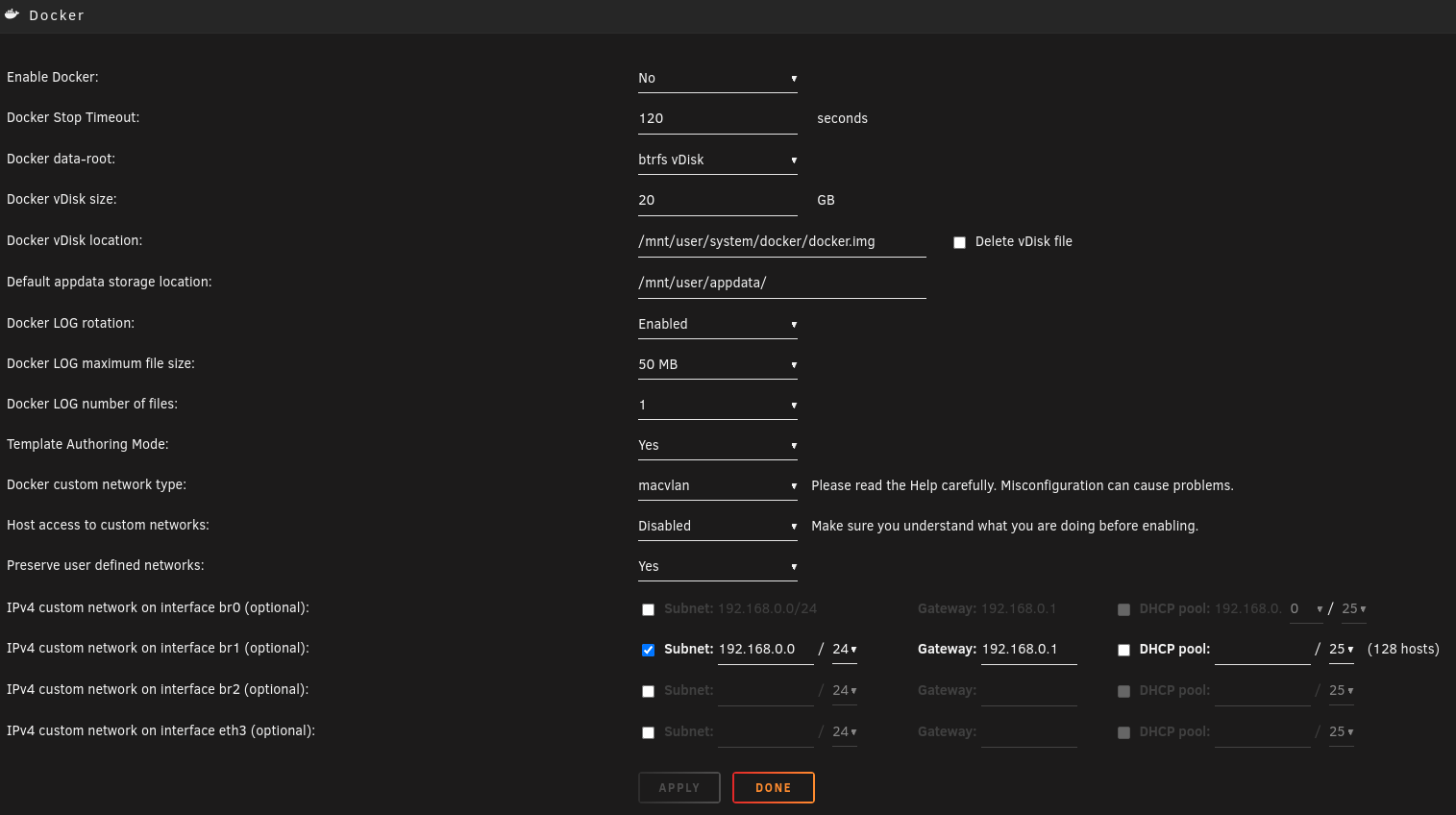

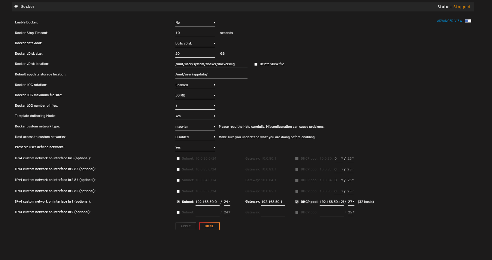

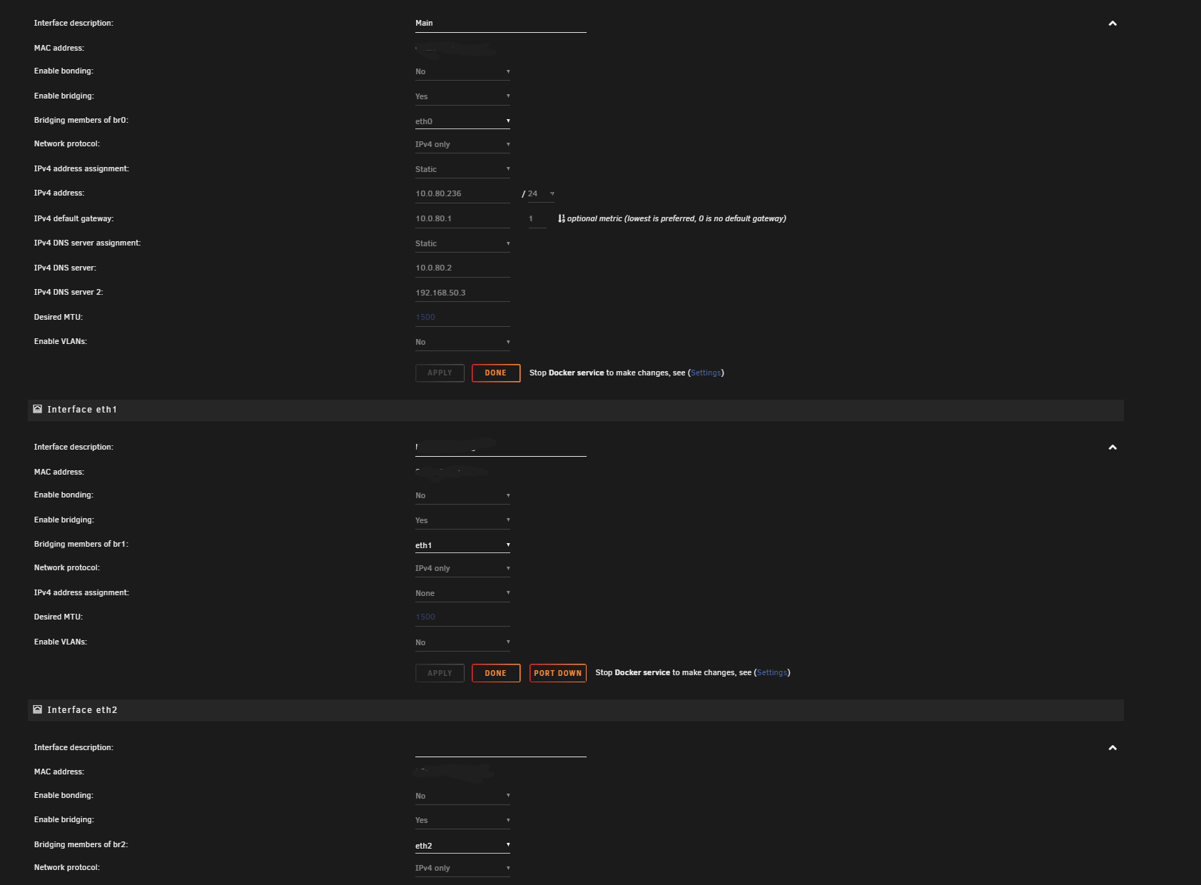

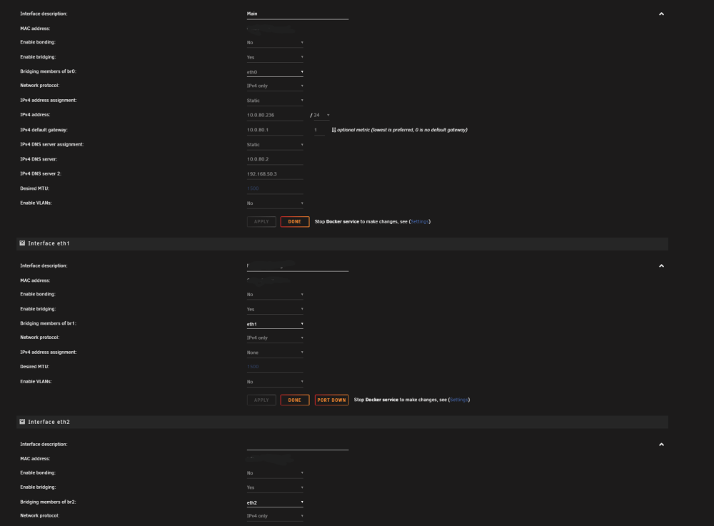

This are the settings I used
br1 working, all containers using it

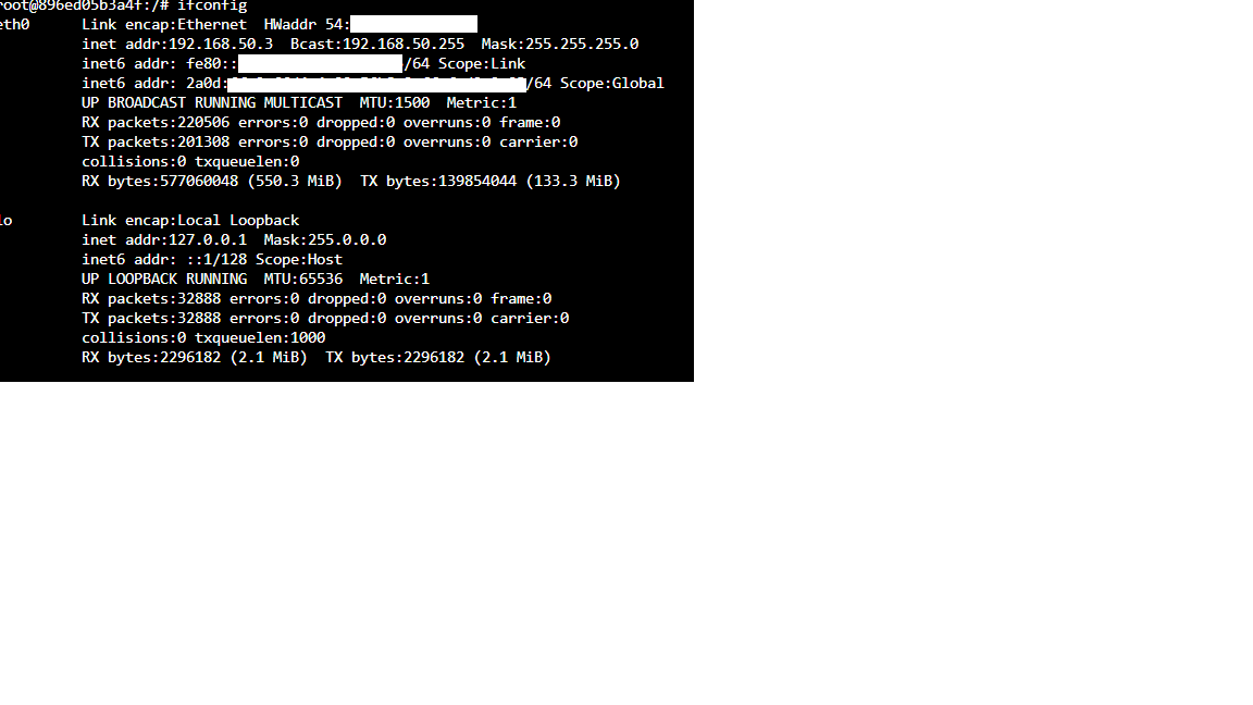

ipv6 on containers working using "--sysctl net.ipv6.conf.all.disable_ipv6=0" in extra paramaters of each container
so far, no macvlan traces (finger crossed)

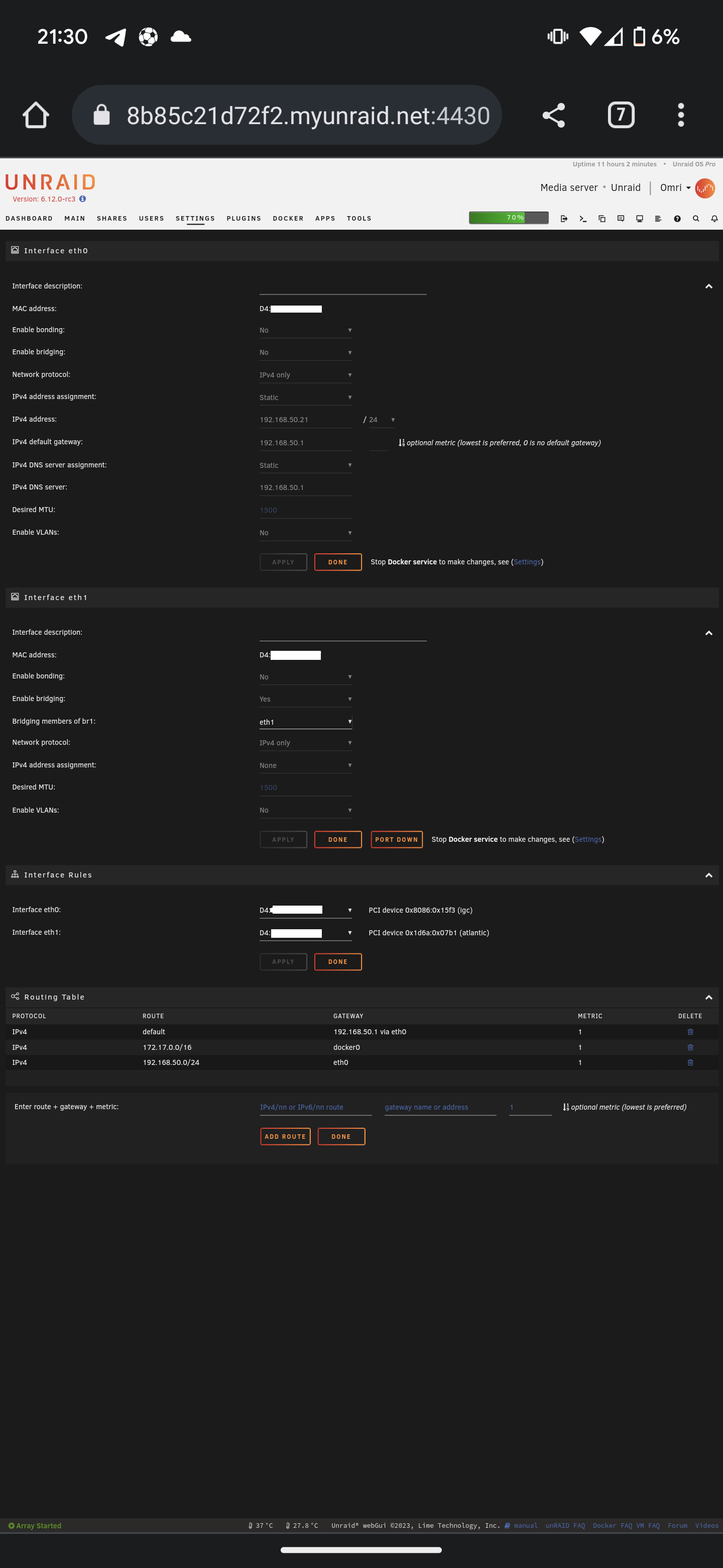

I have been using this setup for idk 2 months? I have not had any issues. I am running 6.11.5 Using Unifi UDMP pointing to pihole just for dns. Docker DHCP allows for labels
NIC on unraid and UDMP are in promiscuous mode. I add the flag --mac-address <mac address> to every container under Extra Parameters: I also add --dns. I let docker DHCP add the IP address, then i add that to pihole DNS and make it a fixed address in UDMP. Also set the DHCP that UDMP hands out really low like 10 ip's 192.168.x.20 to 30.

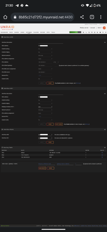

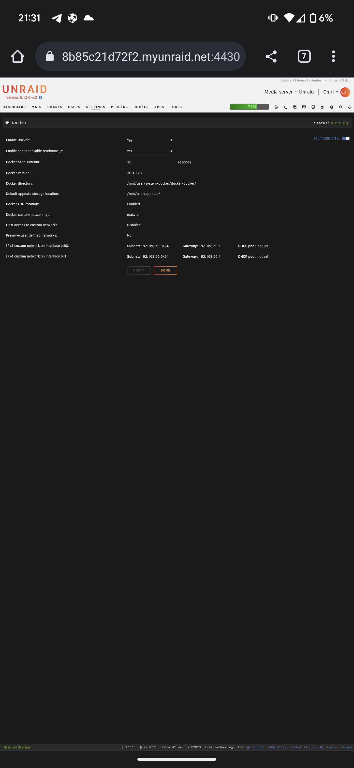

First up, I tried looking at the Unraid docs to try and figure it out myself but there is nothing there!
I followed along, like everyone else. But, I ran into something that confuses the heck out of me.
I have a second NIC, always have and on that NIC I had bridging turned off. Each container assigned to eth1 would be on network 168.202.x defined as vlan2 on my UDMProSE, and assigned an IP manually to each container. This would be the situation for any container that I want to expose to the internet via NPM. But, some containers are not exposed and don't need to have a dedicated IP so for those I stuck on the bridge for local and VPN access only (Radarr, Sonarr etc).
But once I turned on bridging for eth1, br1 showed up and eth1 disappeared! All the containers I had setup on eth1 were offline.
On a sidenote; 'Bridge' is still listed in the networks but choosing that is using the eth0 NIC network 168.200.x even though bridging is disabled for eth0. Why isn't that bridge using the eth1 NIC for the bridge mode since it IS enabled? Same for 'Host'

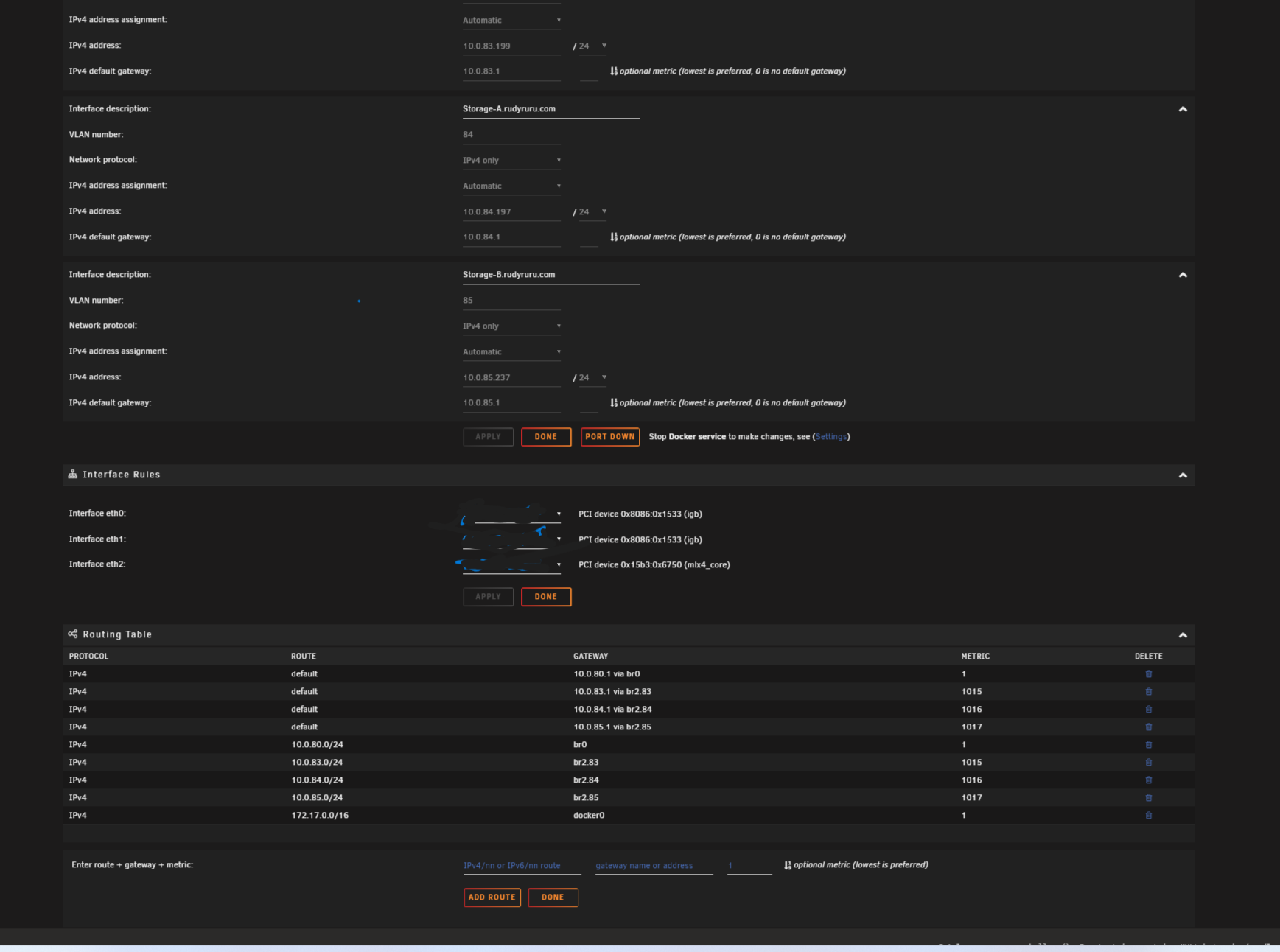

I always had this setup and has been working great, single 2.5G nic + vlans, Docker network as IPvlan. Putting it here if anyone having issue or similar setup.
