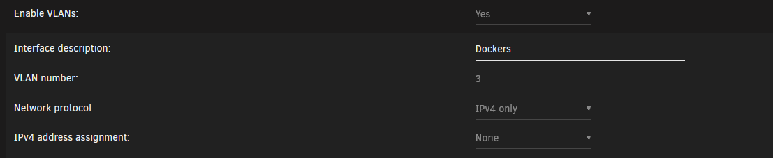

On 6/20/2023 at 5:38 PM, Hoopster said:
Personally, the problem for me with macvlan call traces went away completely when I moved docker containers to a VLAN with their own IP addresses on that VLAN instead of using br0.  It does not matter if I use macvlan or ipvlan for Docker since I created the VLAN.
it seems that disabling bridge really solves the macvlan problem but i ordered a cheap tp-link managed switch TL-SG108E to
forget it and to enable host access also.
so i just need to set docker on br1 (eth1) port to br1.10 (192.168.10.199) if br0 on 192.168.0.199 , but host can access to VLAN if i enable it ?
That depends on how you have the VLAN settings defined in Network Settings.
In my case, I have the Dockers VLAN assigned to VLAN number 3 on br0 so the custom network that appears in the docker container is Custom: br0.3 --Dockers
I followed this guide to get the VLAN setup in Unraid, the switch and the router.  I have a Ubiquiti Unifi switch and router but the principles are the same for other switches and routers that support VLANs.
