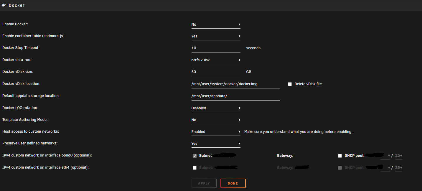

I was working through the change to eth0, I have already upgraded to 6.12.4, when my internet as a whole went out. Now when I go to make the change to ipvlan from macvlan, I do not see the option at all (yes, I am looking at Docker settings using the advanced view). I dod not use ipv6, is it possible that the option only shows up if both are selected?
I'm experiencing server crashes every 10-12 hours. I initially started using the on-board nic as well as my quad nic card as I thought the issue might be my nic card going out. I started working on the proposed solutions when I saw the macvlan errors and hit this forum. But as noted above, I now have no way to try to move from macvlan to ipvlanDocker_Settings_Screenshot.thumb.png.c594f0c8335d69da7f63f4220f07a608.png
That option is only available if bridging is enabled.
