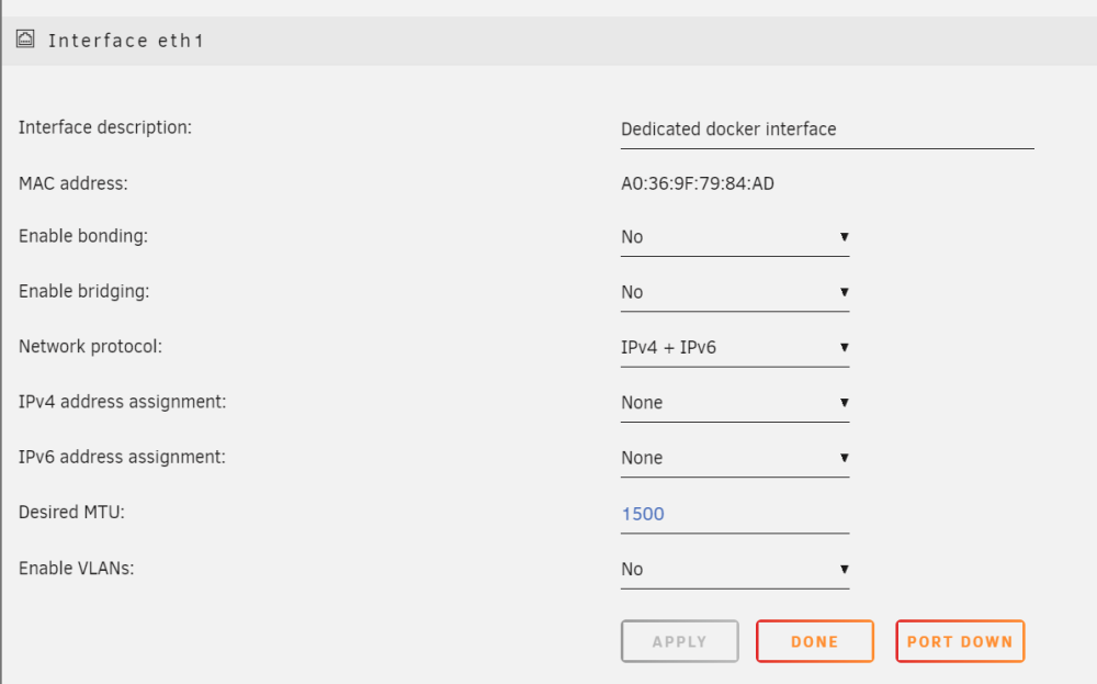

1. Configure the dedicated interface in network settings (array must be stopped).
    - Enable bridging for this interface
    - Use IPv4 only or IPv4 and IPv6 as per your case
    - No IP addresses are assigned to this interface

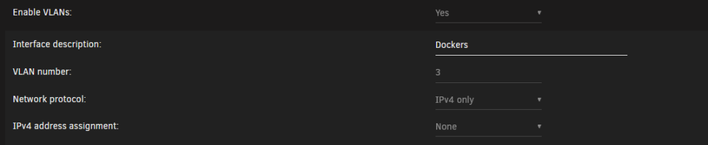

If these dockers will be using a VLAN network isn’t it also necessary to enable VLAN?

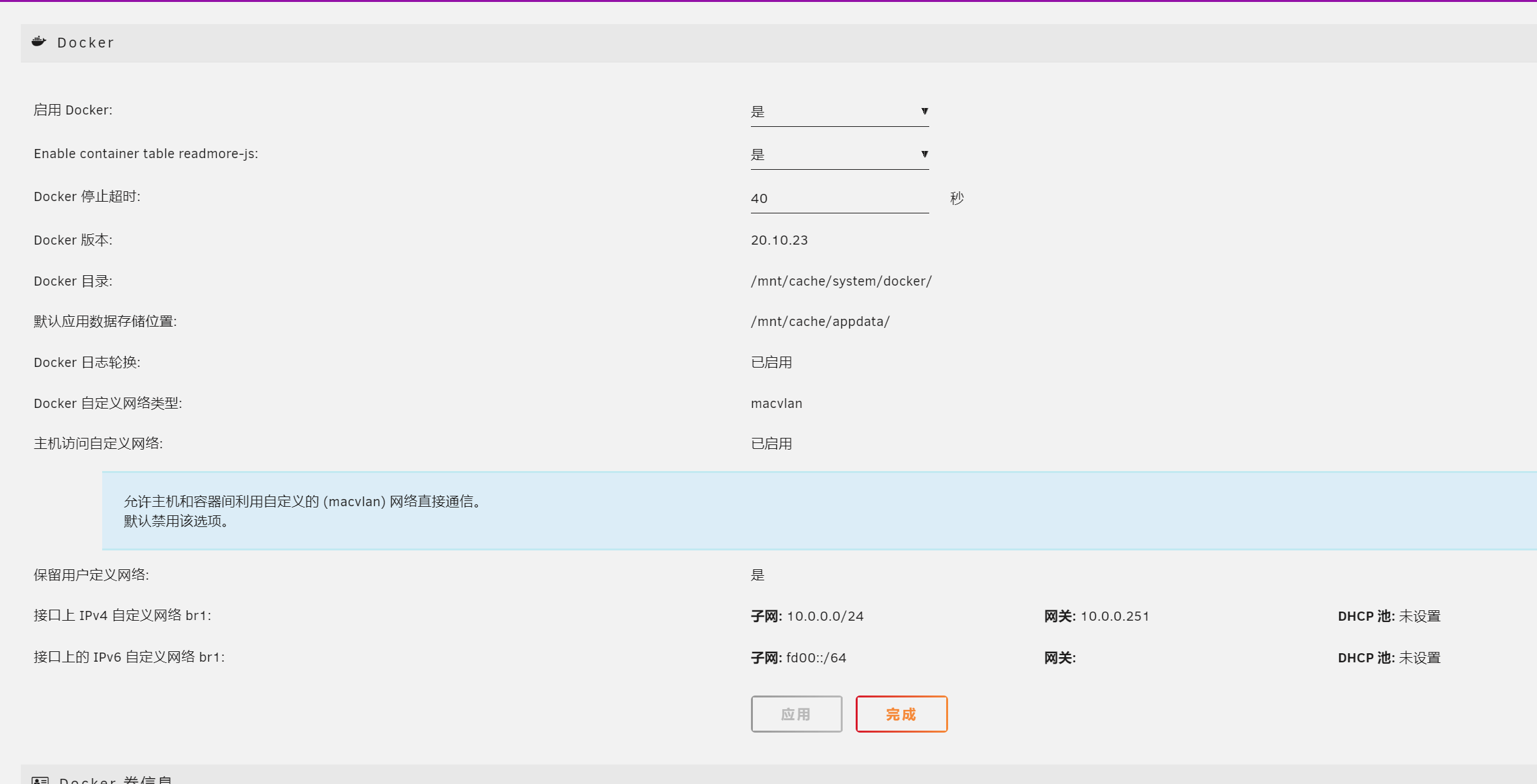

按照你的方法,我最近升级了6.12 rc5 rc6 , macvlan没有导致报错死机,但是,我用br1创建的br网络,与macvlan不能互相访问,已经开了主机自定义访问
yes, my english is not good , if u translate it , shoud understand my mind easy

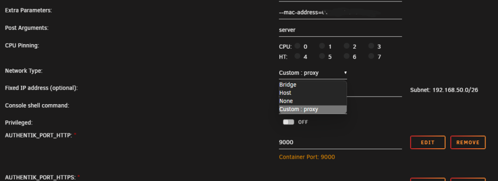

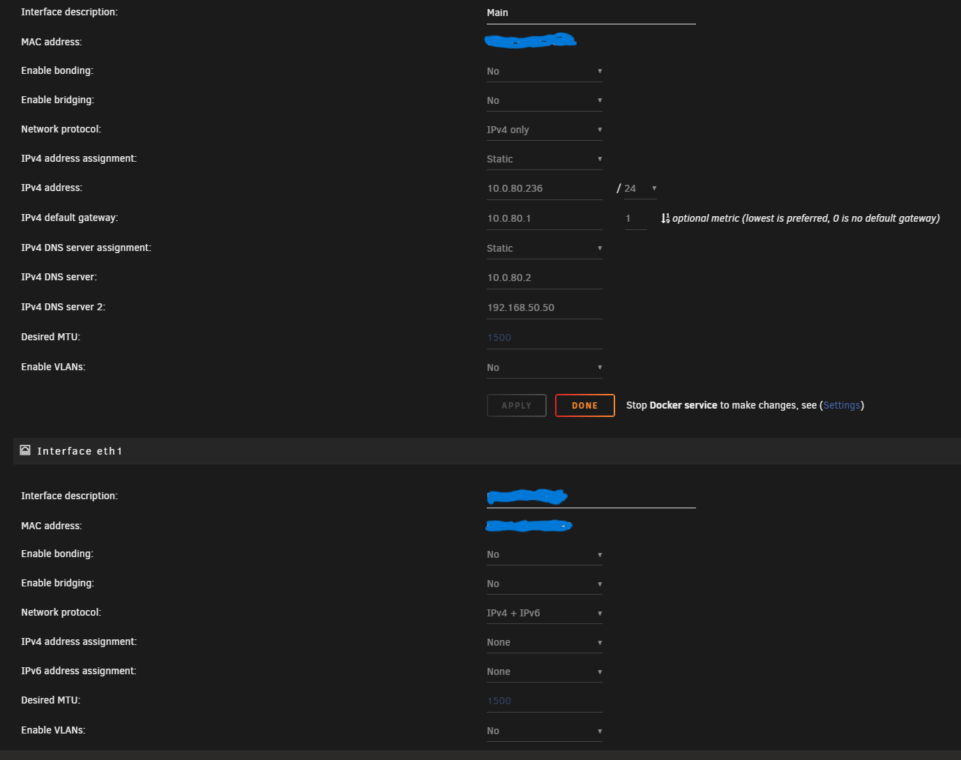

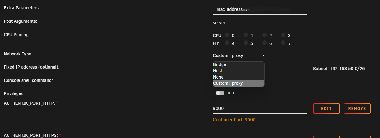

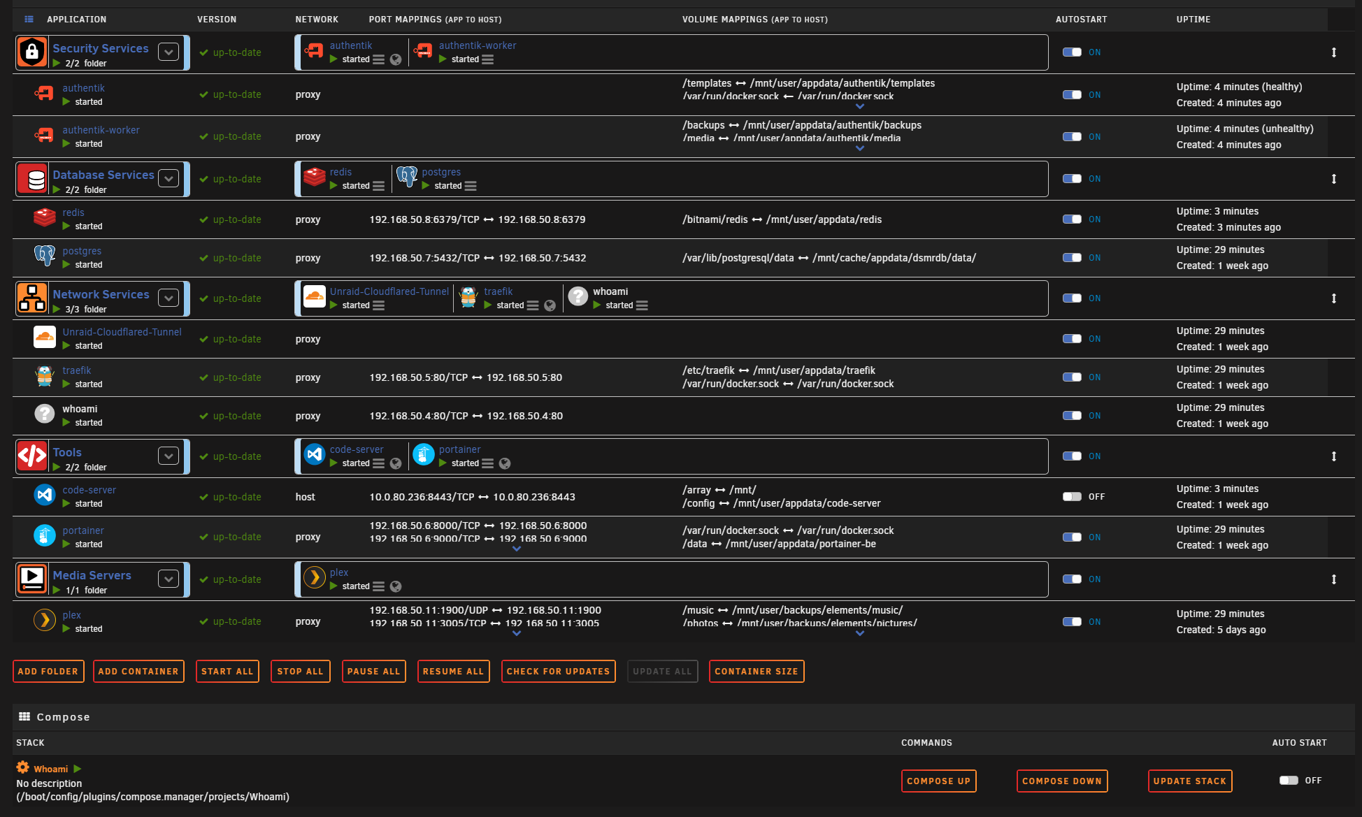

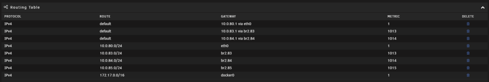

So every once in awhile I get O.C.D about something and this has turned into just that.
I had this running in the post I made on page 2 but i just kept messing with it..some of you know how that goes.
Anyway
Let me preface this ... This is a docker network on it's own network port separate from the host system.
Separate meaning: Unraid host and all network BUT one are under one router and THIS ONE docker network is under a separate switch and router. This is running atm using unraid 6.12.rc6 and Unifi UDMP 3.0.20. IF you are running VM's this is proably not for you.
The only thing I really did different is how I created this network vs on page 2 and turning off bridge on both eth0 AND eth1.
So first turn off bridging
Then I created the network using docker run
docker network create -d macvlan \
  --subnet=192.168.50.0/26 \
  --ip-range=192.168.50.0/27 \
  --gateway=192.168.50.1 \
  -o parent=eth1 proxy
Under the docker settings you see the eth1 network but I did NO configuring left it blank.
As I created containers I added
--mac-address
under "Extra Parameters" and gave them all a static IP
UDMP: I let the router handle DHCP and configured it to use the same gateway as above BUT to had out leases from .33 to .62
I also directed the router to use a Pi-Hole I have set up in the network to handle DNS.
As I created containers mac-address I configured DHCP reservations and DNS records in the router (even tho pi-hole does the DNS)
Reason: UDMP atm floats what it see's. UDMP has had DNS issues from creation so this just kind of locks it in you my not have to do this. I was messing with this in the middle of them upgrading from 1.0.1 to 3.0.20.
And of course DNS records in the pi-hole.
Thats it works great no errors.
Unraid Network
Docker-Network
Unraid routes
Docker container network
Docker Dash
Have fun!!

Make sure to have “IPv4 address assignment:” set to “none” for your eth1. (As well as for ipv6).

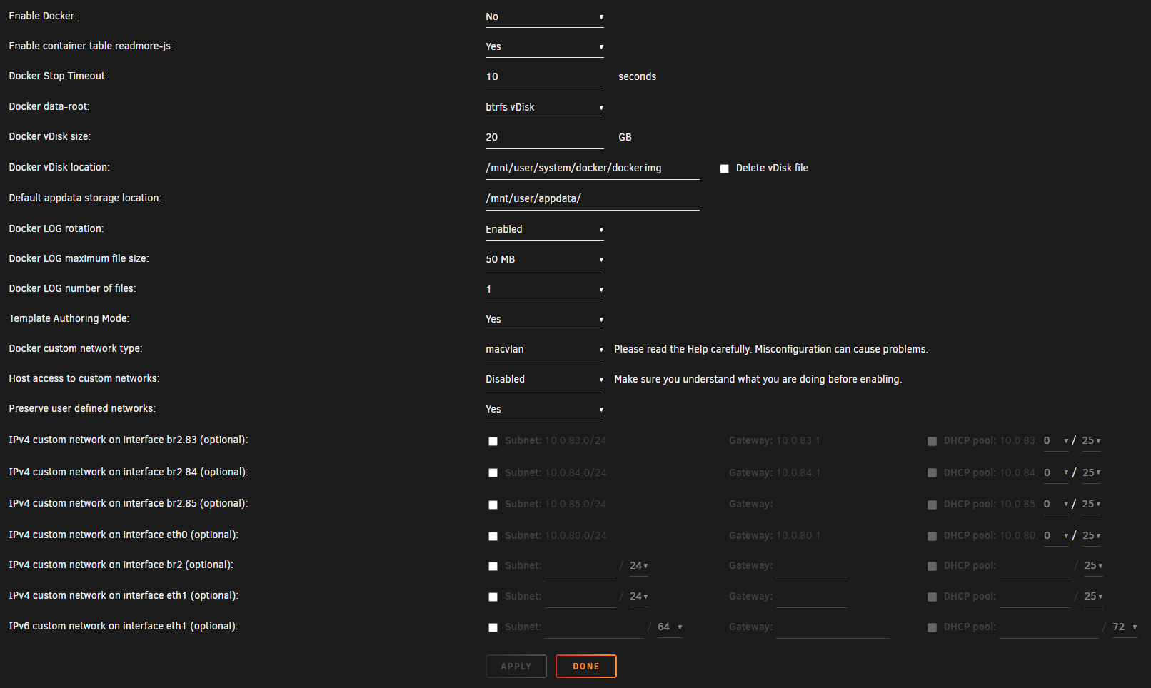

    --subnet=172.20.30.0/23 \
    --gateway=172.20.30.254 \
    --ip-range=172.20.30.100/27 \
    -o parent=br2 dockerlan
unraidserver-diagnostics-20230521-1454.zip

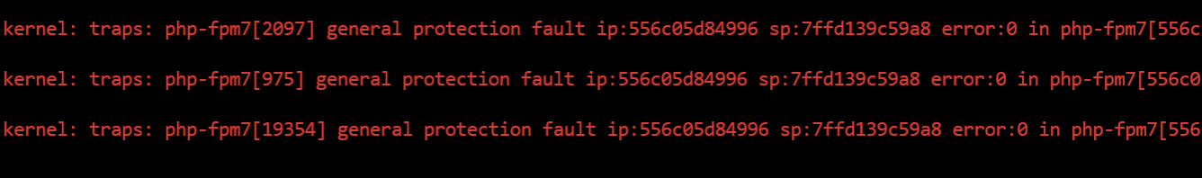

in my case on same hardware was no problems at all about 3 years ,but last month on 6.11.5 kernel traps on syslog with
macvlan + host access.
on 6.12 got server freeze and macvlan traps , so changed to ipvlan then to this fix (macvlan on br1 + no host access).
also got System_cache_ssd xfs filesystem broken with docker.img  btrfs error , maybe not related ...
so fixed xfs and deleted docker image ... :(

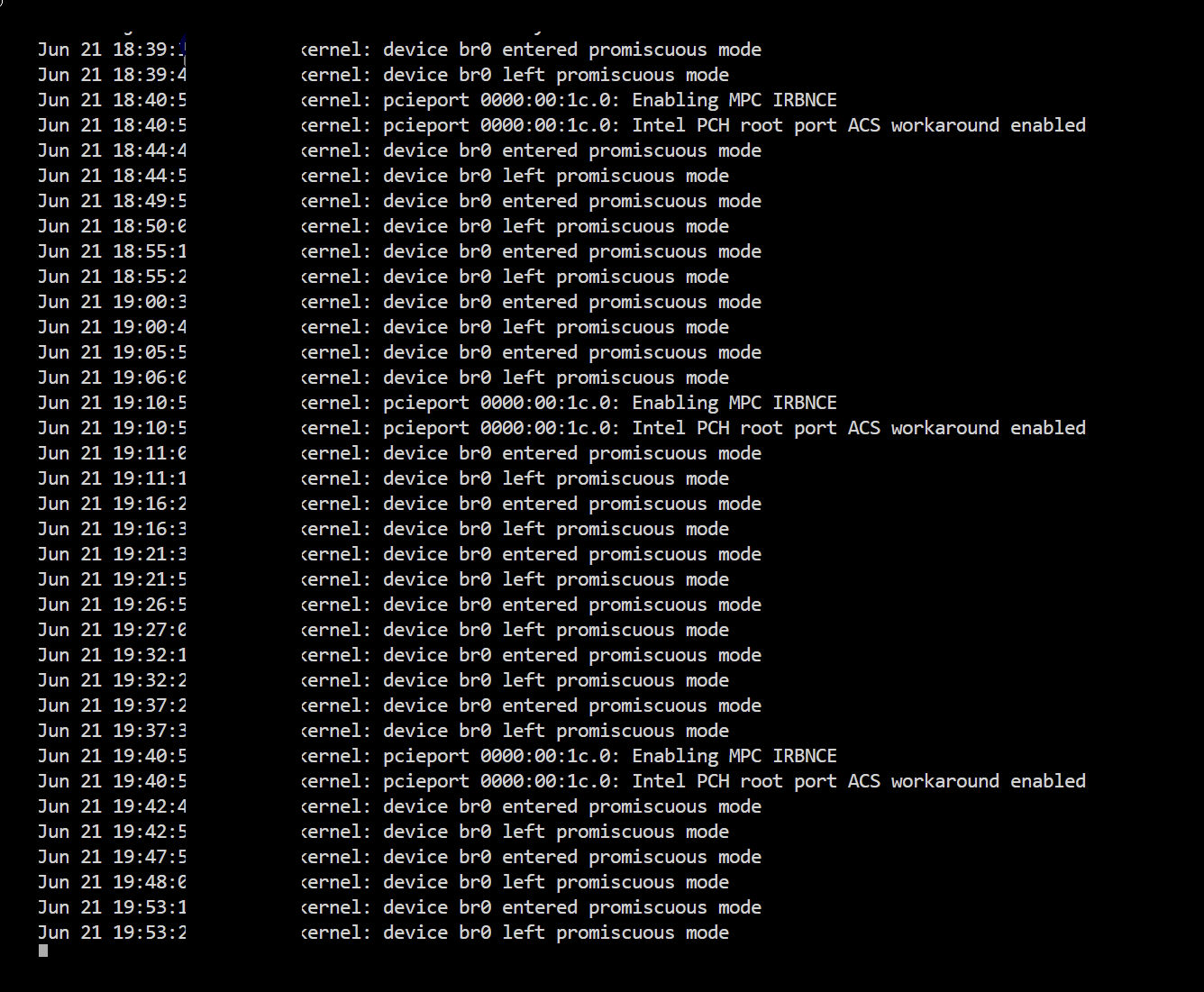

so now i have strange br0 behavior on syslog every some minutes :

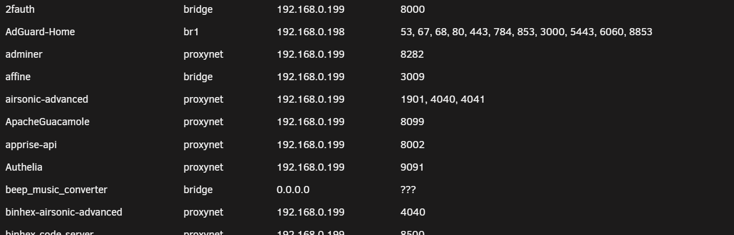

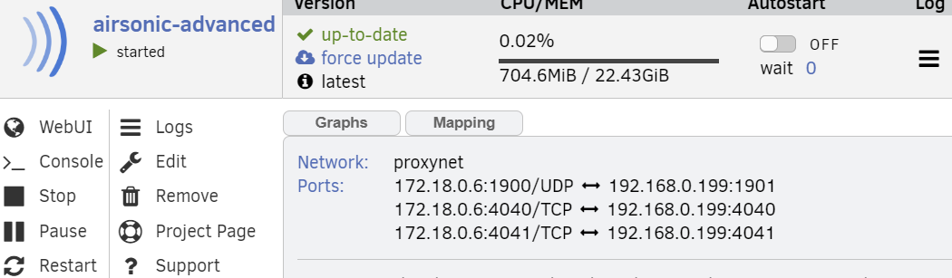

Also strange docker alocation of proxynet instead of 172.18.0.x , maybe this is just the bug of 6.12.1 ?

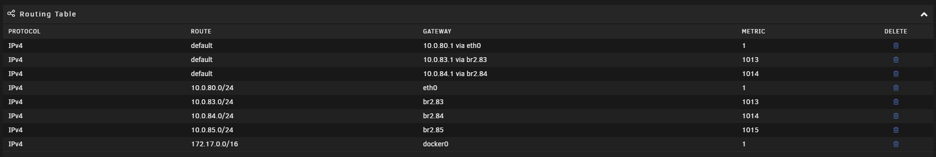

I also encountered the macvlan problem. I moved all containers from br0 to br2 as described (as ipvlan), but containers connected to the default bridge network cannot communicate with containers connected to br2.
br0/eth0 has 10.0.0.2/16
br2 has no IP but the subnet 10.100.0.0/24
The routing beetwen both networks is done by opnsense and works with all other networkdevices e.g. my PC (10.0.1.87/16) connects to Traefik Container (10.100.0.3) without any problems
 Any ideas?
