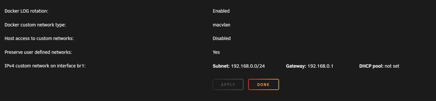

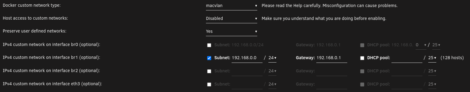

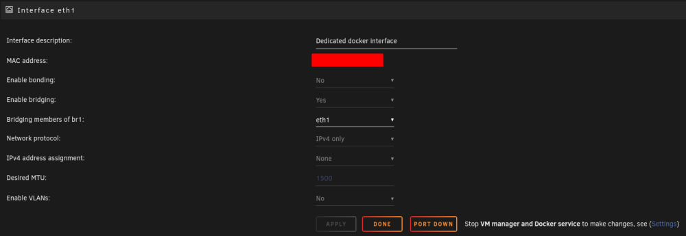

I've tried to get this to work on my system but I think I'm missing something. While I was not getting macvlan issues, I figured I'd configure it this way on a separate network in anticipation of going to 6.12.x. Plus my R710 has 4 network ports - may as well use 'em.
I configured my system as outlined in the original post. When I change my Swag container to use br1, I can't get to the webui. It seems with the old configuration using a custom docker network, it gives the container a different IP on a different network(172.18.0.3 443/80) that maps to the hosts network(192.168.0.100 1443/180).
With proxynet custom docker network:
172.18.0.3:443/TCP <-> 192.168.0.100:1443
172.18.0.3:80/TCP <-> 192.168.0.100:180
With br1 configured as in this post:
192.168.0.2:443/TCP <-> 192.168.0.2:443
192.168.0.2:80/TCP <-> 192.168.0.2:80
Relative noob here. Hope someone can steer me in the right direction.

On 6/28/2023 at 8:08 AM, nraygun said:
Can anyone help me? I think I'm missing something here but can't figure it out.
I think I got it!
I had to turn off bridging on eth0 and change a few ports here and there.
Everything seems to work except for qbittorrentvpn - I can't get to the webgui nor can the -arr's get to it.
I can get to webgui of other containers just fine, just not this one. Nextcloud+Mariadb+Swag works fine on the new br1 too.
If anyone has any suggestions, I'd appreciate it. I'll go pursue this in the binhex-qbittorrentvpn forum.

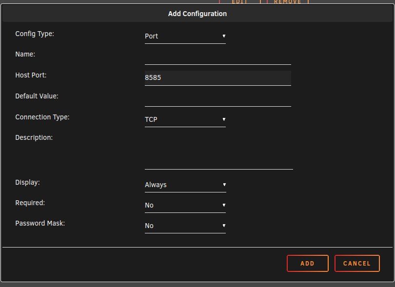

18 hours ago, nraygun said:
I think I got it!
Got qbittorrentvpn working after a long night. Had to change the webgui port. I had to turn on the proxy in a browser, then go to the webgui and change it in the app. One odd thing, even though I changed the webgui port to 8585, unRaid's port mapping still shows 8080. But hey, it works.
Edited by nraygun

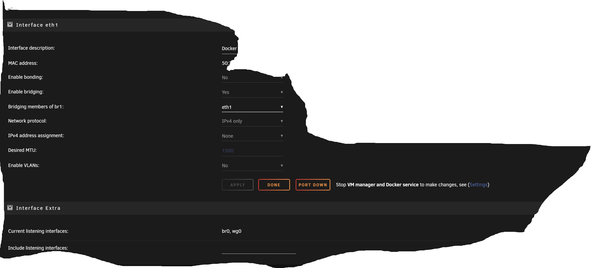

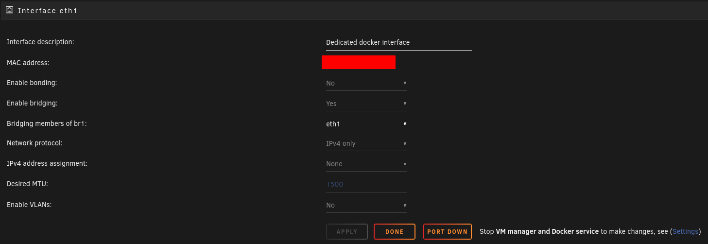

What is bridging for? I disabled this (because I still get kernel panics) and created a custom network eth1 for my docker containers.
It's working like when I'm using br1.
So what is the difference here?!
I assume this fix will not allow VLANs on eth1?
5 hours ago, wgstarks said:
You probably needed to change it in the docker config-
https://github.com/binhex/documentation/blob/master/docker/faq/qbittorrentvpn.md
Scroll down to Q4.
Well, I tried that and there is no container port field when I click add. If I edit one of the existing ports, it shows a container port. I might just leave well enough alone.
Edited by nraygun
I guess the deal is there is no container port when on a custom network. Things are weird when using this new br1 I created on eth1.
I noticed when I changed the WEBGUI_PORT to 8585, it does show up this way in the app - I just can't get to it without going through the proxy. The only thing that seems to work is leaving WEBGUI_PORT at 8080, configure Firefox to use the proxy, and then go into the app with 192.168.0.6:8080 and changing to 8585 in the app. If I do it any other way, I can't get to the ui without going through the proxy.
I also see that my Host Port 3 is set to 8585 with the container port set to 8081 but 8081 doesnt show up in the port mappings.

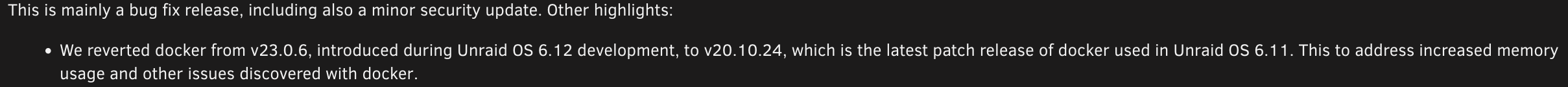

Does anyone know if this roll-back in the latest update (2023-06-29) has anything to do with the here discussed mcvlan situation?
unfortunately no, this rollback has nothing to do with the macvlan problem
