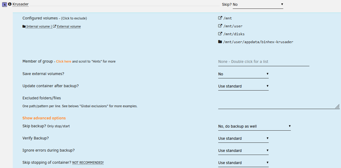

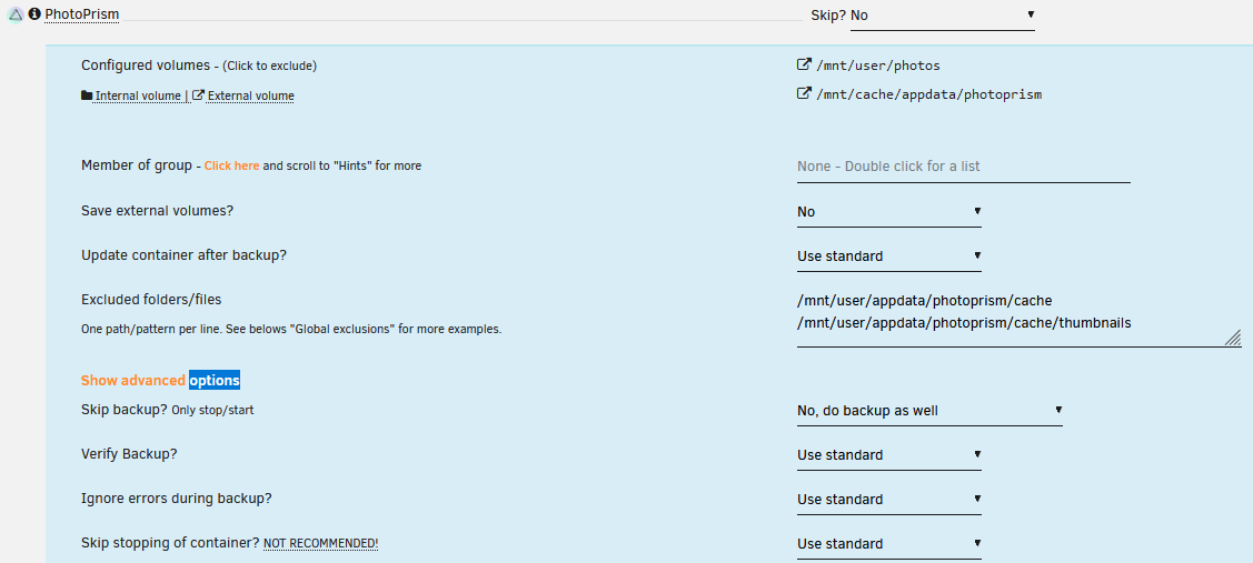

Getting 1 warning and 1 error that I can't figure out.
First the warning:
[20.10.2024 03:07:18][⚠️][PhotoPrism] PhotoPrism does not have any volume to back up! Skipping. Please consider ignoring this container.
But it does have a volume to back up?
So I'm not sure why it's saying there isn't one.
Second the error:
[20.10.2024 03:07:18][][Krusader] 'binhex-shared' does NOT exist! Please check your mappings! Skipping it for now.
There's no `binhex-shared` on my Krusader docker config either. So I'm not sure what it's referring to.
Edited by s449
Link to comment
It doesn't, 2 are recognized as external and backing up external volumes is not enabled. If the appdata one isn't meant to be external then it's because it directly refers to /mnt/cache instead of /mnt/user, you're missing /mnt/cache/appdata in the plugin's backup sources.
It's probably hidden in "show more" in the docker template. You can set it to ignore.
Edited by Kilrah

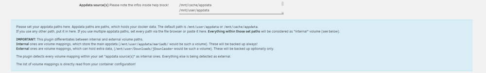

You're right! I just had /mnt/user/appdata/, so I added /mnt/cache/appdata/:
You're also right, binhex-shared was also hidden under "show more" in the docker compose. I just added it to the excluded list for Krusader:
I also just found another thread about this issue: https://www.reddit.com/r/unRAID/comments/1f0z4zl/backup_warning_for_binhexshared/
I'll have to wait for the next scheduled backup to test if this works but I'm optimistic this will solve these issues. Thank you so much for the help! :)
Edited by s449

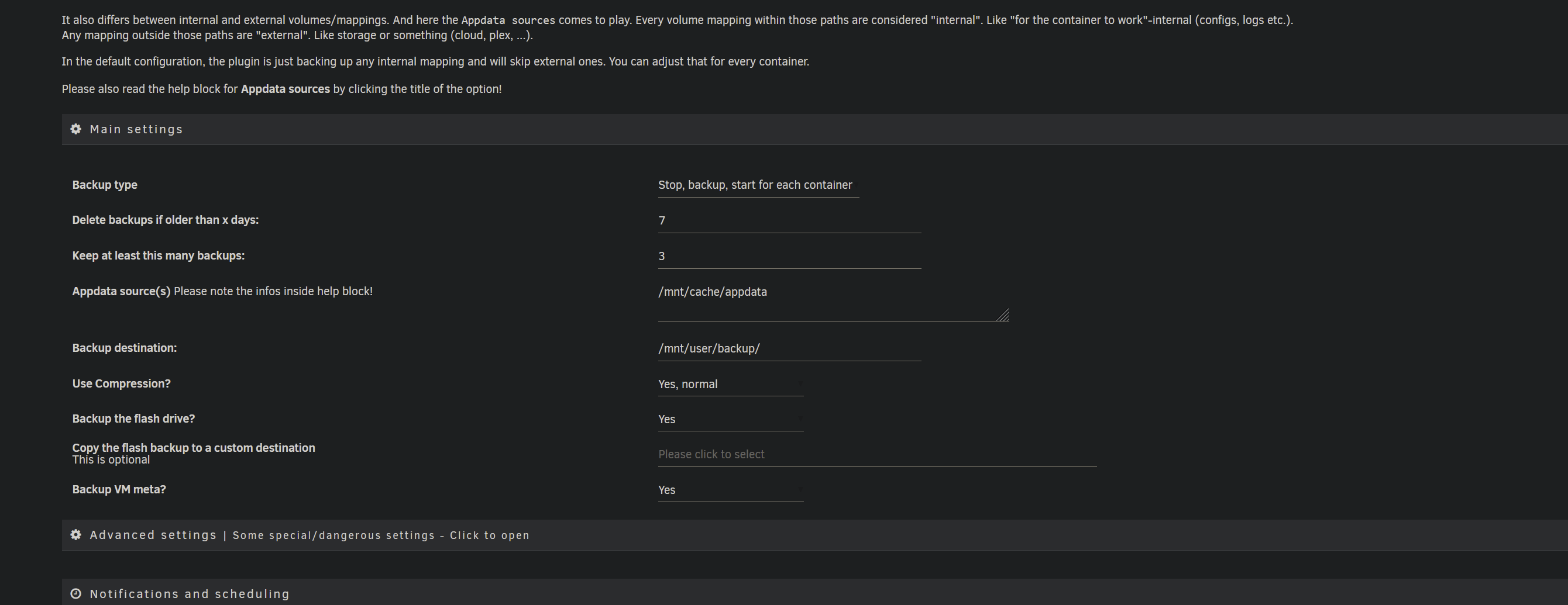

I have a question on your plugin backup regarding appdata sources
TO make htis work as a few backups had issues with volumes and missing data path I have moved off the array in beta 3 to zfs only and had to add this to my sources
/mnt/cache/appdata
/mnt/user/appdata
/mnt/user/Dockers
/mnt/vm-zfs/Dockers
/mnt/vm-zfs/Dockers/ClamAV
/mnt/vm-zfs/Dockers/FastAPI-DLS
/mnt/vm-zfs/Dockers/Grafana
/mnt/vm-zfs/Dockers/LocalAI
/mnt/vm-zfs/Dockers/MakeMKV
/mnt/vm-zfs/Dockers/MariaDB-Mysql
/mnt/vm-zfs/Dockers/netprobe_lite
/mnt/vm-zfs/Dockers/PBS
/mnt/vm-zfs/Dockers/PhotoPrism
/mnt/vm-zfs/Dockers/Plex
/mnt/vm-zfs/Dockers/SFTP
So when i run the backup manual its now grabs the voulmes. Great!
Except 2 dockers have large data volumes in teh backup i want it to backup its core runing files.
in example My plex media libary is 6 TB in size if not more, I want to skip the libary backup , but want ot backup the volume of my plex install, database , etc...
example of that folder tree:
I only want the plugin to grab and backup the appdata folder.
I also have something simlar for my photo prism docker where i want to keep the docker iamge contets and data but the actual data
For Me, I rather use and acquire my plex media libary and Photo prism photo restored form a different method to speed up the backup and not have 6TB file for one item... The backup i want is the application settings and data that currently are running to function as the library can change and be updated, but library data can vary and change...
Is there a way to add a skip volume to the plugin path?
a wild card or another box to add a exclude volume?

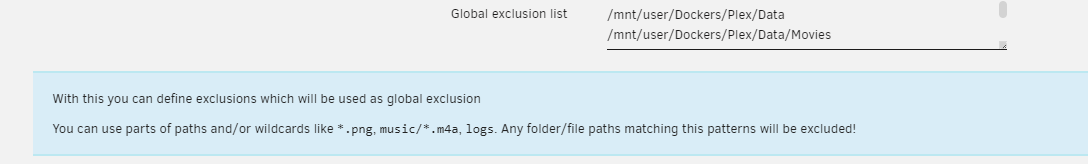

mainly was looking for clarfication on how to use the exclusion list system. I think I have it working, now...
my list to exclude:
/mnt/user/Dockers/Plex/Data
/mnt/user/Dockers/Plex/Data/Movies
/mnt/user/Dockers/Plex/Data/TV_Shows
"/mnt/user/Dockers/Plex/Data/Personal Family Home Videos"
/mnt/user/Dockers/PhotoPrism
/mnt/user/Dockers/PhotoPrism/import
/mnt/user/Dockers/PhotoPrism/originals
/mnt/user/Dockers/PhotoPrism/storage
