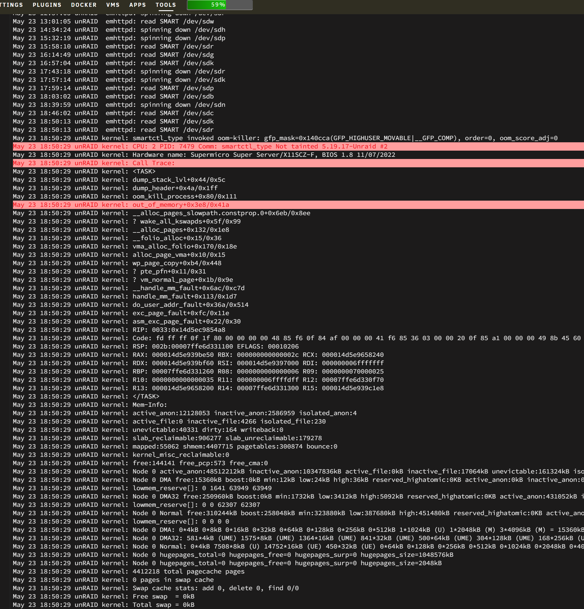

I was out of town for a few days on business and came home to find this.  I have never run out of memory before and always have plenty free.  The only difference in the server over the past month is that we have been running PLEX DVR as our primary DVR after I removed the TiVo's from our house.  I do run the Folder Caching app with cache pressure set to zero, but I have done that for like 10+ years on multiple server versions with plenty of memory without issue.  The first instance appears to have been on May 23rd 18:50:29, but there are more after that:
Attached is my diagnostics.  It seems my windows 11 VM is very activce for some unknown reason (go Microsoft), but it has memory limited to 32GB so I don't see how that could cause an issue with the 32GB dedicated to unRAID and the Dockers?

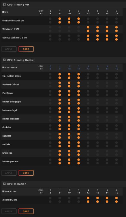

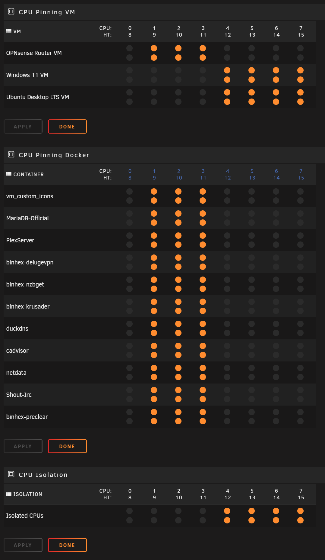

FWIW I have Docker's CPU cores Pinned to 1/9, 2/10 ,3/11.  unRAID has CPU 0/8 all to itself.
