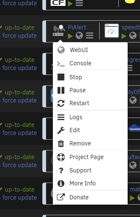

Strange but i have same context menu as was befor :
There is an option when you edit the folder.

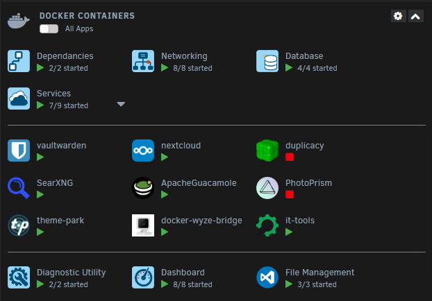

@Linguafoeda Getting close with this css:
.folder-showcase-outer[expanded="true"],
.folder-showcase-outer[expanded="true"] .folder-showcase {
  float: left;
  display: block;
  width: 100%;
.folder-showcase-outer[expanded="true"] .folder-docker {
  position: relative;
.folder-showcase-outer[expanded="true"] .folder-docker::after {
  position: absolute;
  content: "\f0d7";
  display: inline-block;
  font: normal normal normal 14px/1 FontAwesome;
  font-size: 2rem;
  right: 10px;
  bottom: 0;
  border-top: 1px solid gray;
  border-bottom: 1px solid gray;
  padding-top: 2rem;
  margin-bottom: 2rem;
#docker_view .folder-element-docker .state {
  display: none;
Edited by Mattaton

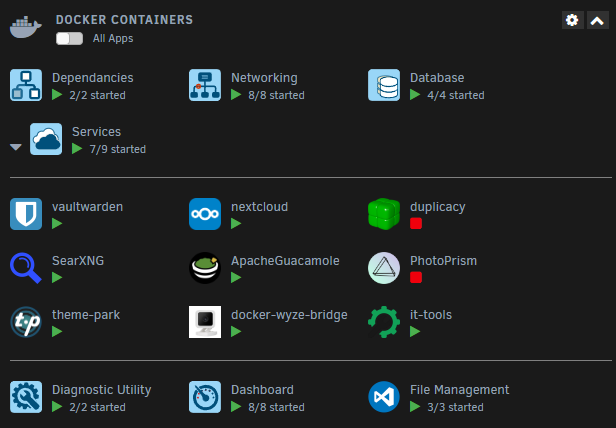

Could also put the open arrow before the folder icon, like this:
After Update:

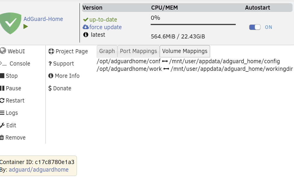

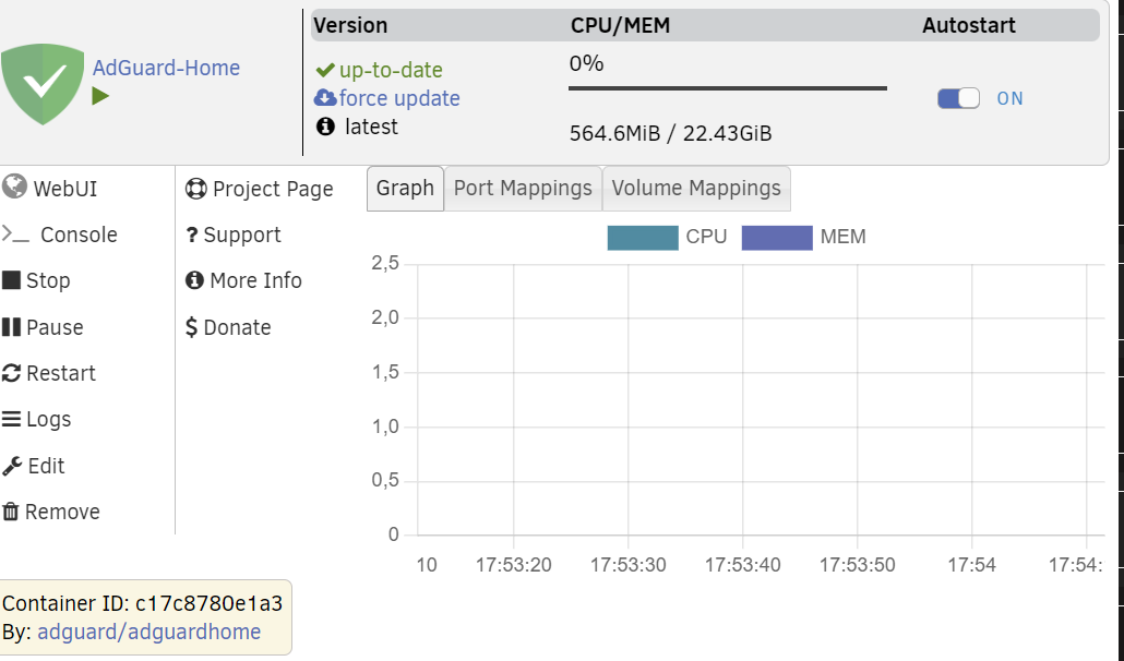

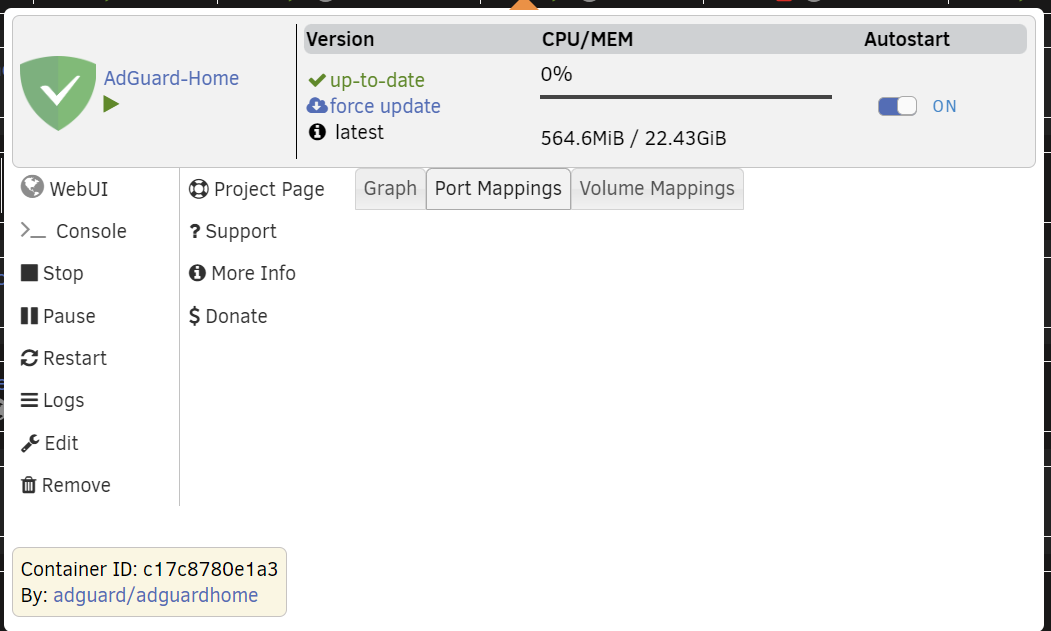

1. Click on Globe open about:blank#blocked page in docker page for all containers. also in advanced context.
Advanced menu:
not shown cpu/mem lines update (blank ) , no ports , only volume mapping is shows.
 It would look better if that grey down arrow be on the right side and bigger…. This way all icons would line up. I would also place the top horizontal border above the folder icon. Also give the expanded folder icon and label their own class. This way, in custom.css, one could make the folder icon and name larger to show better hierarchy between folders and the folder contents…. Background of a wrapper for the folder icon and label should run full width as well. This way one could apply a custom background color, and radius corners - again to do better visual distinction between folder and its containers.
i would leave all the non-expanded folders as shown above.

30 minutes ago, Masterwishx said:
After Update:
Advanced menu:
I am getting the CPU MEM graph, but I do not get Port Mappings, and the Web UI comes up about:blank#blocked.
33 minutes ago, Masterwishx said:
After Update:
Advanced menu:
I pushed an update, now should be fixed.
