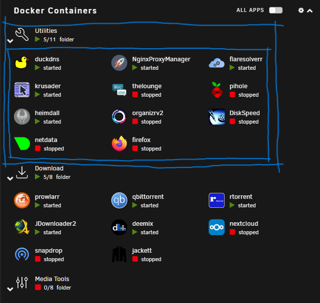

thank you @Mattaton and @scolcipitato. Any idea / guide on how to use custom CSS to replicate the dashboard as shown below vs. the stock version? This is an incredible add-on, thank you for updating it for 6.12. I just need to figure out how to get my custom icons back as well as changing the CSS of the dashboard and i'm a happy camper :)
I gave a try to make the Docker Folders behave like the above screen…. Did not have much luck… @scolcipitato I think there needs to be some code to separate Folders from Dockers. I assume the challenge is how to put folders together continuously, when the docker lists are closed, and separate them when some/all Folders are expanded (like image above..
I would keep trying but my server is in bad shape. I had three drives fail within days. One of them being a parity… two of the drives well within warranty. I fear data loss of about 20TB…. ; (
I managed to get something, not the exactly what you have, but it's something.
.folder-docker:has([expanded="true"]) {
  display: block;
  width: 100%;
Note that this work only of chrome, in Firefox you have to enable an option to even get the :has pseudo-class, but still, it won't work, it won't update when you expand the folders.

Can a wrapper element be added around the children container elements?
Knowing nothing about how this plugin was assembled, how much control do you have over the elements that are generated here?
If you can put a wrapper around each folder and its container children, and then a wrapper around just the children, we'd have a lot more to play with using CSS.
The display: block you're adding to the .folder-docker element is pushing the children down to the next row but not really grouping them. If all the folders weren't all expanded, the next folder element would be right inline with the previous container element.
This wouldn't be too difficult if you have any control over the html elements spit out in this area.
I can do that, but then the problem would be the reverse, would end up with something like this.
Even when a folder is collapsed, if you are fine with this you can do it even now with a minor modification to the CSS I have made before.
Outer wrapper wouldn't be a block element. So it wouldn't clear the elements beside it. It'd just be something used to group the folder element with its container children.
The wrapper around the children would be display:none and then display:block when expanded. Which would allow it to look more like @Linguafoeda showed.
This can work, I'll see if this won't mean major code changes and if not implement it.
