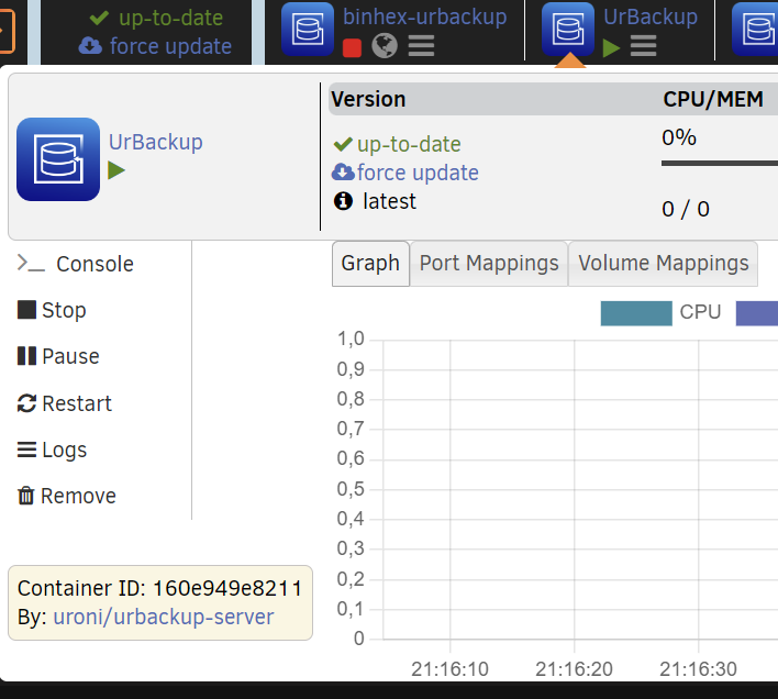

On 9/15/2023 at 8:25 PM, Masterwishx said:
i have also missing globe icon for urBackup,Krusader
Mostly webui now link ip:port is working but still have piAlert,Home-Assistant-Core ... no link (about:blank#blocked)

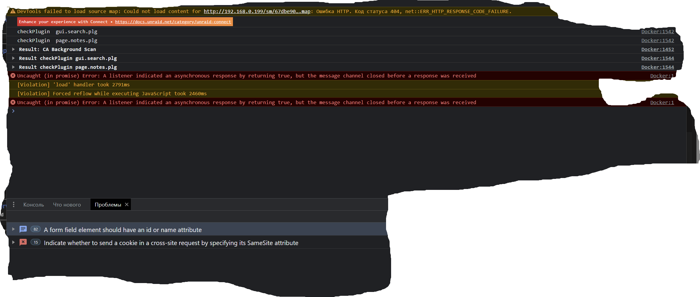

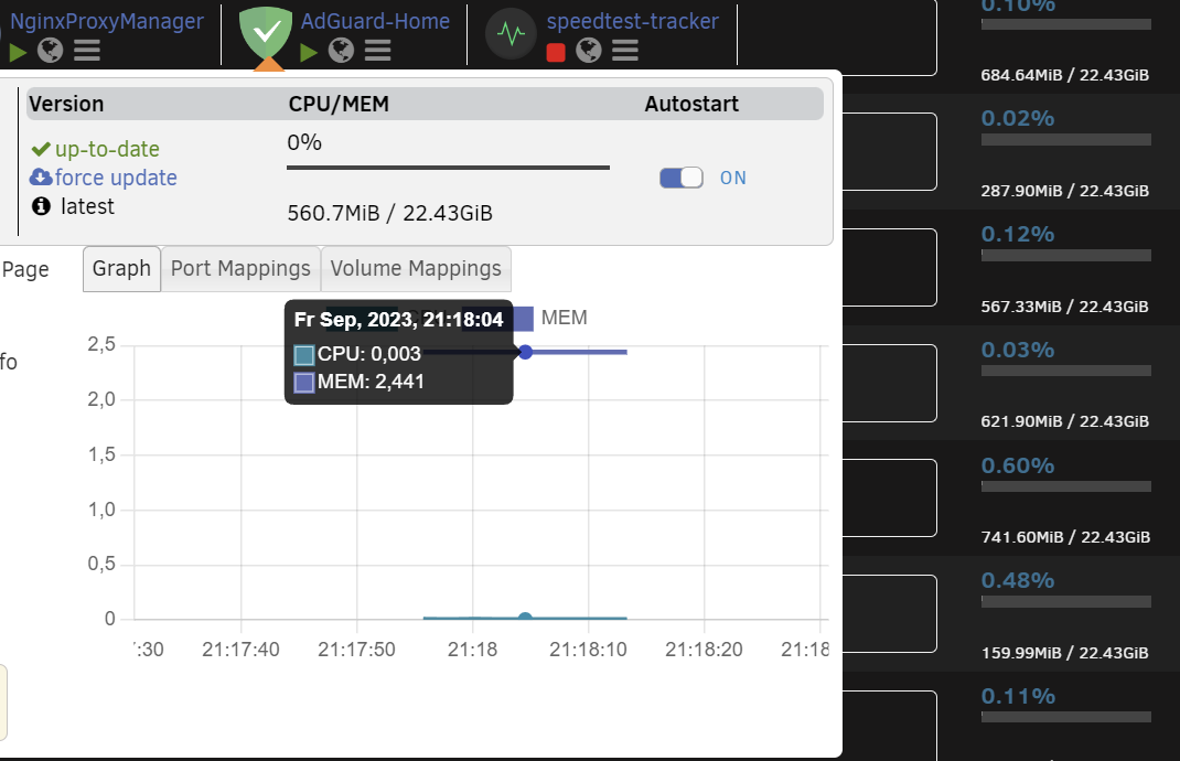

Moslty i dont have lines of CPU/MEM but after refresh i have it for couple sec then it stuck /stop :
I left the webui open for a couple of days now, and I don't have this problem.
What I think is happening is that the web socket is stopping sending data, this means my code won't get triggered and consequently won't update the values in the webui.
You can check on that by opening the dev tools and going to the network section and searching for dockerload clicking on the only row you see and going to the Messages section, here you can see the messages that the socket receives.
Either way I don't know how to proceed, if the socket stops receiving data the problem is on the server, if the socket continues receiving data, but you don't see it updating the webui then the problem is on the client, but again, I used standard JS event listener
so if it doesn't work, I don't even know where to begin.
35 minutes ago, scolcipitato said:
I have made an update, hopefully this fixes it.
Thanks for your amazing work , its fixed all links and missed globs icons for me
i will send your in pm ...
Sorry but still one left without globe :
The problem is fixed:
Removed value of 60s time frame in first folder, then apply.
Now all working fine.
What is mean time frame by the way?
How much time is shown in the graph.
This is the final fix, if this won't work I need to rework a big chunk of the code, try to update and let me know.
Thanks, working now
All seems to be working well on my end. Thanks!

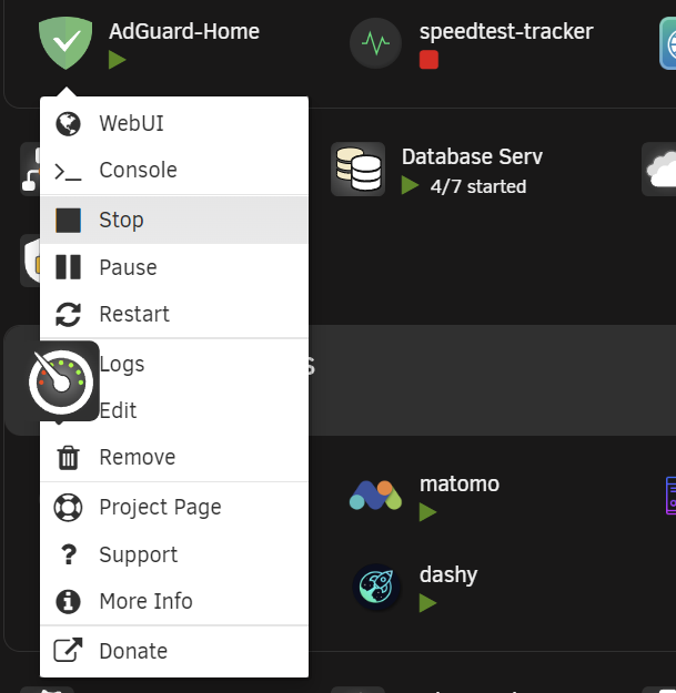

I know you just got done with some big fixing and sweet new updates, but a feature request for when you have a moment...
Can you add a css class to the containers that are set to autostart (both on the dashboard and docker tab)?
That way we can add some custom css to make the autostart setting obvious without opening the folders on the docker tab. And on the dashboard, I could add another icon to denote autostart status.
Thanks!!!

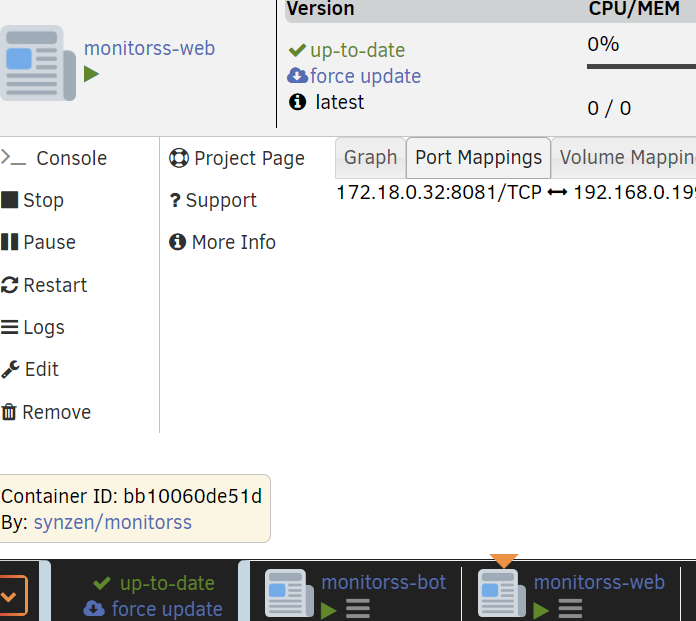

Hi - sorry for missing the past few pages of great work by the dev members in this thread. Quick questions:
1. I have updated my plugin to "2023.09.17.1", but i don't have the detailed graph/CPU usage etc. info on the main docker page. How do i get that (do i need to force restart the entire server or is there a command line to restart just the plugin etc.)?
2. A lot of members have done some incredible work regarding tweaks to the CSS for the dashboard to add spacing / making it look like the old Docker Folders. What are the steps to copy and paste their CSS to make mine look similar?
In the edit page, change the "Preview Context" to advanced.
HOLY COW - How is that not in the main Dockers page for the rest of them?
