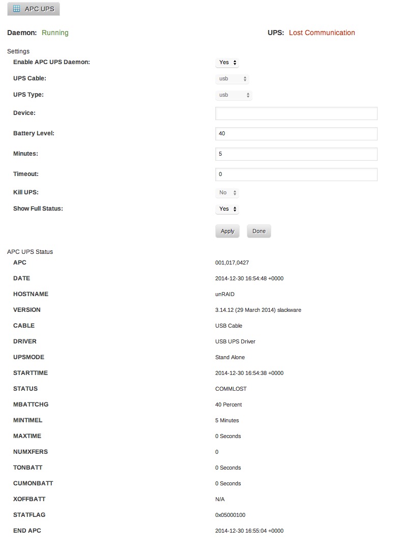

Having issues with getting this running.
My setup is as follows:
Unraid connected to UPS via USB (master)
iMac connected to UPS via ethernet (slave)
UPS has both USB and ethernet plugged in (using a SmartSlot 9617 for ethernet connection)
unRAID Config (Master, plugged into UPS via USB cable, ethernet cable also configured)
UPSCABLE: USB
UPSTYPE: USB
Device: (empty)
Battery level: 40
Minutes: 5
Timeout: 0
iMac Config (Slave, uses ethernet)
UPSCABLE: ether
UPSTYPE: net
Device: 192.168.1.80:3551
Battery level: 50
Minutes: 10
Timeout: 0
UPSCLASS: standalone
UPSMODE: disable
POLLTIME: 0
However Unraid constantly says lost communication.
Checked all connections and cable and all ok. Have tried shutting down everything including UPS then booting it all back up however still has same message.
Running Apcupsd-3.14.12-i486-7_nr-aw.plg
Anyone got any ideas?
I'm no expert, but you do not need an ethernet connection to the UPS.  In a master-slave setup the slave gets the status over the LAN from the master (which is your unRAID box).  So they must both be on the LAN but the UPS only needs the USB or serial connection to the unRAID box.  It might be that the use of the ethernet connection in the UPS is preventing its USB from working.  The IP address for the slave setting must be the address of the unRAID box, obviously.

You are really going to have to read your manual on this configuration and find if this configuration is really going to work.  Usually only one computer is tied to the UPS and it controls the UPS.  Any slave devices are then controlled by that computer, running the software that is provided by the UPS manufacturer.  This type of setup can be difficult to setup.  Most people prefer just to use two UPSs...  (The cost of two small UPSs is not that much greater the cost of larger capacity UPS that can really handle two computers.)
Thank you for the replies.
I have tried removing the ethernet connection from the UPS and then restarted everything but still saying lost communication.
The frustrating thing is that is use to work and then suddenly stopped working with nothing changed (no software updates, no hardware changes)!
I believe that this config will work due to using the NIS available in ACPUPSD. My Unraid provides the UPS details that my iMac will then read.
OK, I am a bit confused by what you wrote.  First thing, I assume that the screen shot (in your post #432 in this thread) is still valid for this sentence quoted above for the condition where you have only the USB cable between the UPS and your server connected.
If that is true, then what is being display indicates that there is no communication between the UPS and your server.  (The comment about NIS and the LAN connection to your iMac is simply confusing the issue.)  What you have is a hardware failure-- a bad USB cable, Bad USB port in the server, or a failed USB controller in the UPS.  You have to eliminate each possibility one-at-a-time.  (I am also assuming that you are still using that UPS that worked sometime in the past.  It is important to realize That the ACPUSPD software was written by APC to work with their UPS's.  It does work with some UPS's from other vendors but only on a case-by-case basis!)
