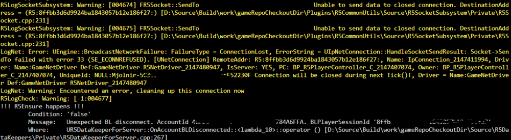

Just started the container after a few weeks because I'm about to travel for work and wanted to test it out. However, it's now in some sort of loop. Spits out these error messages and then re-starts... spits out the same error messages, re-starts... etc..
I've nuked the /appdata/Windrose folder. Pulled down the windrose folder again fresh. Starts fine. The error occurs when I copy over my world folder now from my localPC to the /appdata/Windrose folder and try to start the container.
Maybe some permission error or something?

I've read from someone in the thread that had same problem when copying over. There's a procedure on the official website on how more the world.
Yes. It's the same procedure I've used in the past to move over the world.

I sent in a bug report with what I posted earlier, the errors.

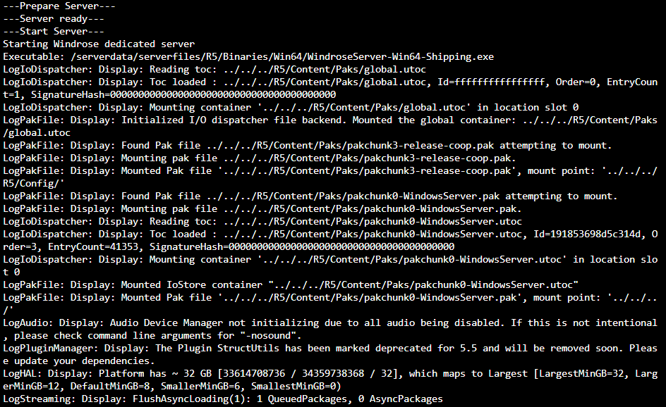

They aren't making it easy for us - they keep introducing breaking changes. Now for instance, since today's update, they've changed the location of the "world / save" folder.
I've fixed the crashing on the container start. I've figured out the new format for copying over a single player to the dedicated server with no crashes.
However, now I'm unable to connect anymore to the dedicated server as I could before with just the invite code. It's back to dropping me back into the main loading screen. Sigh. LoL
The worst is they don't update their doc. They have like 3 places for the doc and each says different thing.
