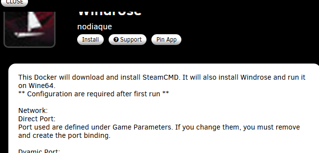

The docker container run on port 7777, but you expose those port for outside connection as port 7779. That mean now to connect to the server, you specify port 7779 instead of 7777. Your screenshot clearly show container port 7777. The server still listen on port 7777. So if it doesn't work when you change the exposed port to 7777, it means it's a you problem, something is in conflict on your unraid server or network.
Instruction clearly state to use the exact same port mapping as the game parameters you use. Yes, you can "cheat" and only change the exposed port and then firewall outside connection to that expose port, I've done it many time which is a very lazy way of doing things and could lead to problem (like game showing in the server list with the wrong port, unless you also forward port 7777 externally to 7779 internally). Also you must change the port in the conf if you change it.
In the end, if it's working now, it means your other thing you put on port 7777 that you talked earlier is causing problem. You might have firewall rules in place or other configuration that are making conflict.
It's not a container nor a template issue, nor even bad information. 7777 is the official port you can found on the steam page and official game FAQ. The dev are having a hard time updating everything, they themselves said only Udp at first but people found out TCP was needed also.

If you change the port the gameserver is listening on you have to remove the port settings in the template and create them yourself.

edit 3: Just saw your edit. What you are saying about removing the port is actually in the FAQ of the docker and also in the instruction

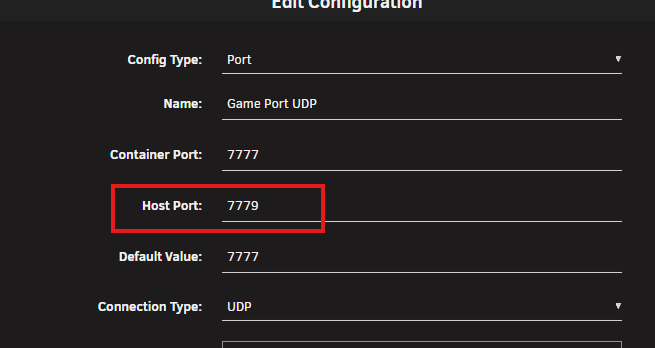

Do you know what happened when you changed the value here?
Click on edit, it will be like that
Notice only 1 value changed, HOST PORT? This is also called exposed port. Notice Container Port is still 7777? This mean, in the container, it will receive whatever data is sent at port 7779 from the host and he will receive it at that port.
So to be even more clear, let's break in image how docker networking work. It's like a small router (well in fact, it is). So container port is like your lan port and host port your wan port. Whatever you put in WAN port (Host) has nothing to do with where the server is listening. You could put port 65023 here and it will work if you say, when connecting to your server, use port 65023. Does it mean the server is listening to that port? Not at all. It's port forwarding. The server is still listening on port 7777. In fact, the server and container has no idea about that, it don't care at all about all of that. You could delete the entire config and it will still run and listen on port 7777. Just like if you start a web server on your pc and don't forward incoming stream from port 80 to that server, the server will still listen to port 80 but nothing will work. You could use port 8080 on your router (which is what most people did in the past since 80 was blocked) and forward it to port 80 inside. You server doesn't listen to port 8080, it's still listening to port 80. That's what you did.
I'm trying to help you here understand how things work, specially to prevent other people on taking your information as fact when they are wrong. Provide requested information and we'll be able to make everything clear for you.
Edited by Nodiaque

I updated the docker port settings as per post #2, and forwarded the ports on my router. I am able to direct connect and play the game, but joining via invite code no longer works. Is that expected or is there some problem with the Query port that I need to troubleshoot?
As documented on the docker itself and in the windrose page, it's one or the other
I have an odd situation. I've done all the port forwarding correctly, as direct connection works just fine. But I would prefer to use the invite code.
I've followed the documentation, disabled direct connection, and removed the assigned ports, and ensured UPnP is enabled on the router. But every time I attempt to connect I receive the following error:
I've tried rebooting server, rebooting array, changing the container from all the different branches, it just doesn't connect.
Not the end of the world, as direct connection still works. But the invite code enables you to rejoin servers using the recently connected servers list. If you have direct connection enabled then the recent servers list doesn't work.
EDIT: Also, I've tried the new "Force Relay" option to see if that would work. That still doesn't resolve the issue either.
