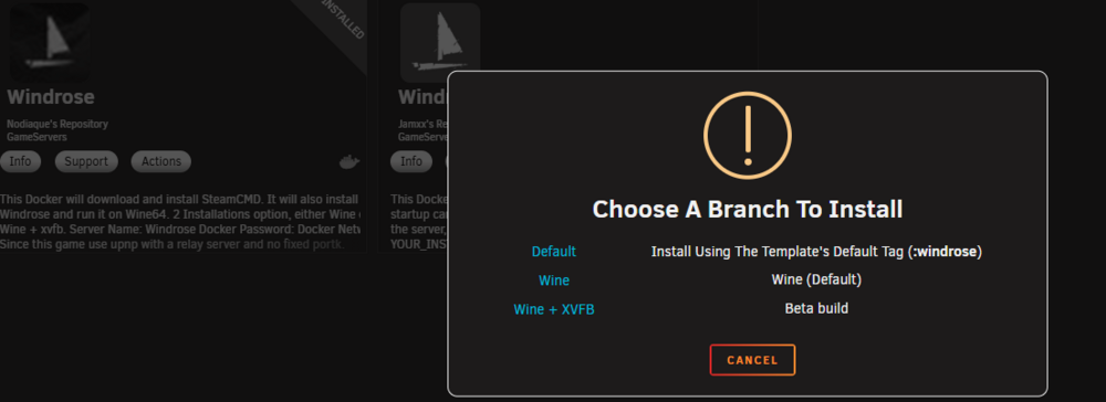

@Nodiaque sorry if i have missed something.. but i cant find your docker to install windrose from the list..
ok, I think something happened to the template, let me check

weird, I see it. It's even updated to ask for which version you want
@Nodiaque it does not show up for me.. is there like a tab i gotta click for new/unstable stuff ?
No it should update automatically. Let me check on my other unraid instance just in case it's my cache that's playing with me
just checked on my other unraid instance and see it. Do you see the other windrose made by someone else?
i found it.. i leave my servers open in tabs.. i forgot to click the apps tab to reload everything...

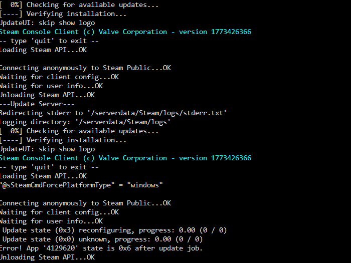

Running the Windrose docker, and its just refusing to pick up the recent update that was released. Anyway to force this to kick off?
Edited by Inch
That'S the joy of Steam CMD. I saw that many time with other games. When that happen, I simply delete the folder (but keep savedata and config) so it force a redownload.
Figured out a workaround:
Delete the appmanifest_4129620.acf file in steamapps/ and retry to force a fresh manifest.
ah nice if only deleting that is enough

Error:The client and server versions do not match
I'm encountering this after updating and restarting the container for windrose. is there perhaps other steps i need to do. this is my first container that also uses steamcmd.
