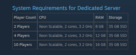

Yeah, the requirement are very high. It's not very optimized. Early access after all

Its wild that this game takes up ~10% of my cpu when nobody is online.. yet 4 of us can jump in and it drops down to 4%
That's early access game for yeah, specially in a emulation world. If they release a native linux server, it will surely be more efficiant.

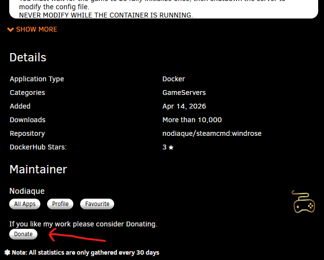

Also, if you have a link I'd love to buy you a beer, coffee, or whatever.
Thank you. I do have a link but I don't even know if it work. I think I created it like 10 years ago. I'm doing this since I like doing it XD
the link is normally in the docker application (like windrose) or on my app profile in unraid.
I clicked on your name and didn't see any kofi, paypal, or anything like that. If you send me a message I'll definitely send something.

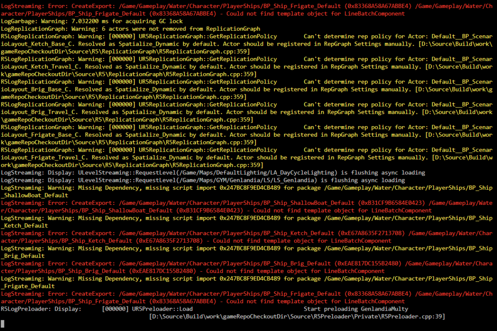

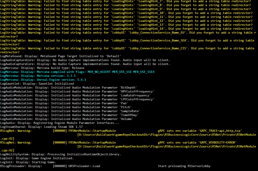

I have had windrose dedicated server with steamcmd running in a windows VM and trying to get a docker container running to migrate to.
I've tried both default + the XVFB versions in a fresh container, however both hang on the 'R5LogPreloader: Display: [000088] UR5Preloader::Load Start preloading GenlandiaMulty [D:\Source\Build\work\gameRepoCheckoutDir\Source\R5Preloader\Private\R5Preloader.cpp:39]' for atleast 30+minutes
Anyone experienced this and got a work around?
Networking looks to be fine as the relay checks all good, and even tried with old server data but still just hangs
This also happens on mine however once I connect, things load.
You don't see this in the docker template (not in the forum)? I'll have to find out why if you don't
Are you not able to connect? Mine always stopped there but I don't own the game so never tried to actually connect.
