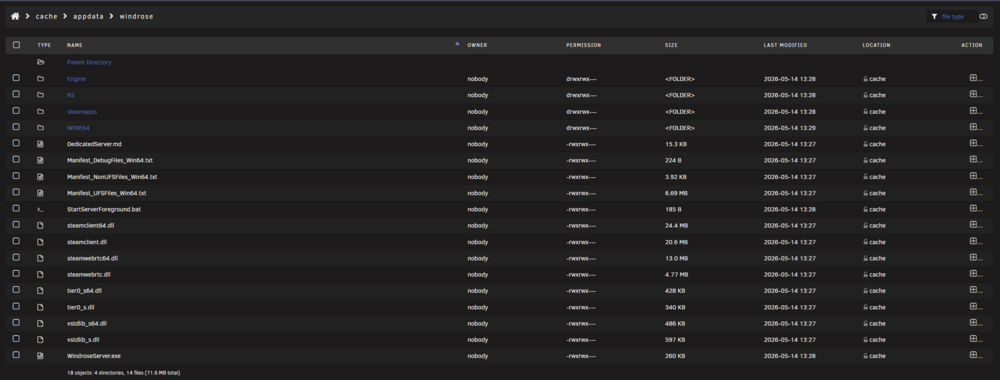

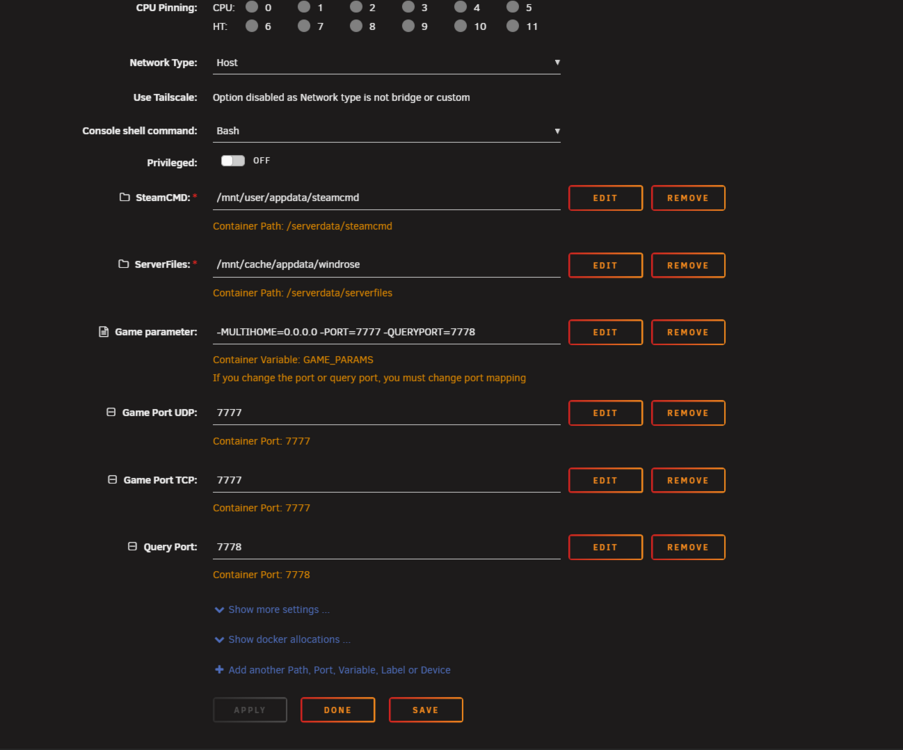

Windrose , Tried both beta and xvfb (deleting steamcmd and windrose appdata folders inbetween)
Can't get the server to fully start enough to even generate the config files i think .Or i'm being dumb and missed something . Where exactly are the config files stored (root?) so should be in /mnt/usar/appdata/windrose

i was able to get the server to start enough to find the config file made in ./R5 BUT using another's template docker

ahhh missed it thanks , i was reading EVERYTHING on the first and 2nd post going .. i know he told us somewhere lol . going to try the "normal" windrose instead of the xvfb or beta of your docker/temp

Yeh i think i just goofed and didn't see the config file . let me cross my eyes and dot my file ;0 lol . i'll report back with results sorry
Yep i was just being stupid , SOOOO sorry to bother you , i thought for sure i checked under /R5 for the damn config file .. after the server was running for awhile .

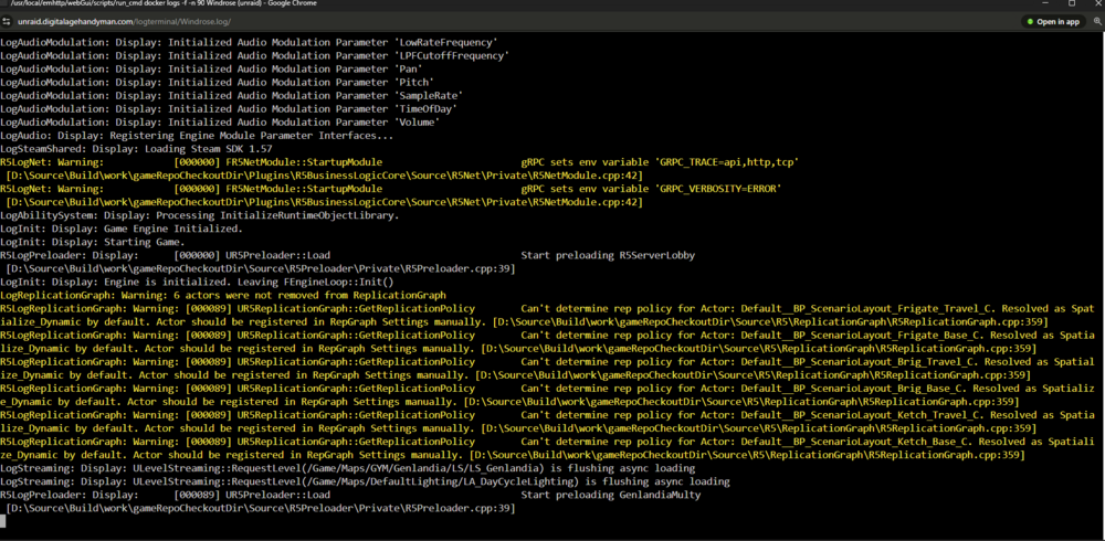

Well for anyone else reading this , if your log gets to this point (it will have errors/ warnings ! ) > image.png
Then your good to go , shut the container down , edit the config as in description , should be good to go .
I was able to connect direct ip on my network to the server running fine . Next to forward the ports needed to access it from the Wan side .

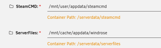

no it won't reinstall steamcmd. They share the same path specially to prevent that. It download steamcmd only if it's not present. Unless you mount to a different path.
