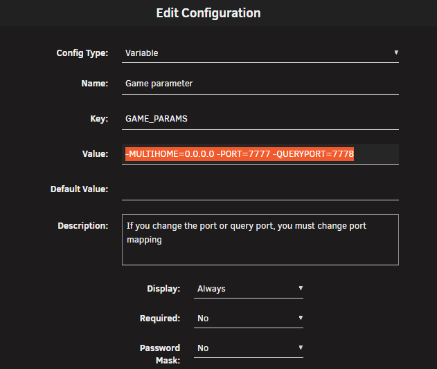

TO ENABLE DIRECT CONNECT, THE FOLLOWING MUST BE DONE
Add a new variable "GAME_PARAMS" with value: -MULTIHOME=0.0.0.0 -PORT=7777 -QUERYPORT=7778
image.pngu

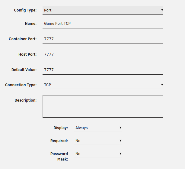

After, you must add 2 port binding, UDP 7777, TCP 7777 and 7778 (you could simply also create one at 7777:7778 but I prefer having them seperate)

After, you must add 2 port binding, UDP 7777 and 7778 (you could simply also create one at 7777:7778 but I prefer having them seperate)

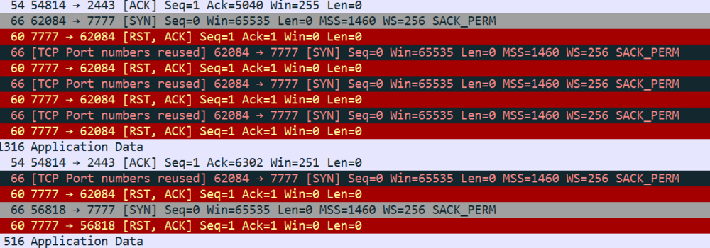

So I have this kinda working for windrose, but having some networking problems.
I am trying a direct connection method and I am able to connect to a world from my PC when the container is in host mode, but when I go to bridge or custom network and have the 7777 and 7778 ports mapped in the container, and the GAME_PARAMS variable set to -MULTIHOME=0.0.0.0 -PORT=7777 -QUERYPORT=7778 , I cannot connect on my home network. I get to the loading screen and then a few seconds later I am booted back to the main screen.
I have tried messing around with the ServerDescription.json to have my server IP address in every possible combination for the P2PProxyAddress and DirectConnectionProxyAddress variables, but it doesn't want to work.
I looked at Wireshark and it looks like when my PC reaches out to port 7777 I get a bunch of reset responses back:
It looks like it tries at two different ports and then gives up.
In every scenario, nobody can join remotely either (even though I have a port open on my router pointing to my server).
Would this be just a plain and simple networking issue or perhaps an issue with properly assigning the access to specific ports that the container needs?

Update: it seems port 3478 may also need to be opened. Need to to more testing to verify, but remote connections are possible now.
Port 7777 tcp and udp should be opened when the docker is on a custom network and using direct connection. Verified using a vpn for external connections. Just checking with friends to see if they can join.
All other parameters except for the ‘UseDirectConnection‘ were left as default.
Update: Friends can join. I think the missing part for my setup was simply enabling TCP port 7777 alongside the UDP for ports 7777 and 7778
