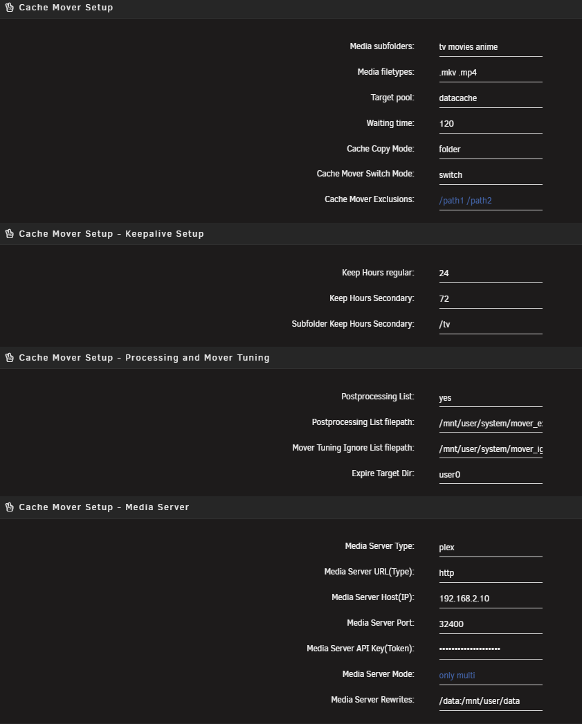

Hi @alturismo I am trying to use cache mover, so far my setup looks like on attached, the only thing that is missing is plex token, however not sure if all paths are ok? Also what about subtitles files, will it move them automatically or should I add .srt next to the mkv and mp4 files?
Thanks for help.

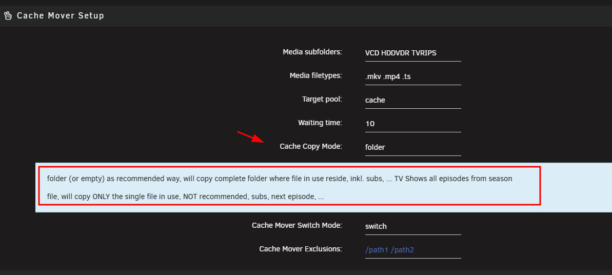

there is a wrong argumant in one field
which also answers your question about subs ;) as long as they are in the same folder ;)
postprocessing ... pleas read and fill the field, the "yes" is just a blueprint in your case
if your pathes are correct, cant tell without knowing how you setup your plex Server Docker
and, if you are not using token, you can leave the mode field empt, just as note.
there is a help text on each input field
if you are not sure, i need more infos from your general setup ;)
Thank you @alturismo , it was my bed time and used wrong cache copy mode :)

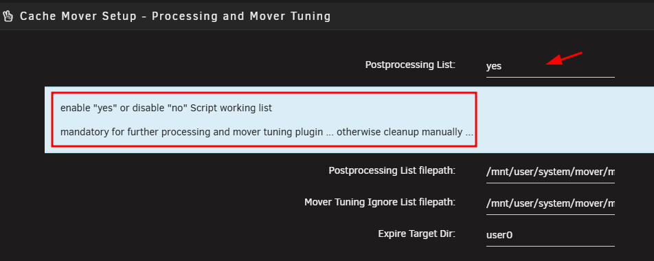

I am just thinking, technically I do not need mover at all, as this is separate ssd pool, not the main cache. I guess in this case I have to figure it out and remove files manually, or they will be deleted after xx time?
if you dont want the plugin to clean up then ...
i always recommend, set to yes
create 2 empty files which are pointing somewhere, i use /mnt/user/system/mover/... as you see in the pre configured type.
then the plugin will delete untouched files after your given hours, sample
24 for movies now
720 for tv now
untouched means, whenever the plugin checks activity /default every 10 min) the timer "resets", so you can watch every day 10 mins from your movie if you want to, only once you didnt touch it for at least 24 hours ... the cleaner will remove it then (default, once a day in the morning)

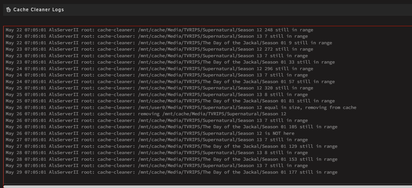

The only thing that is not working is cache cleaner, I set post processing to yes, set the cron to do it every 2 minutes but the cleaner log is empty, not sure why it does not check the files?
Edited by Joloxx9
it ll of course only look for played files on "cache", so if you enabled it afterwards ... will only lookup for files which are logged
sample
scrolling down ...
Thanks I have re did all and now I can see cache-cleaner is running and files are visible in Cache mover cached tab, the last question the same file is in mover tuning excluded, is it because the file is still in range?

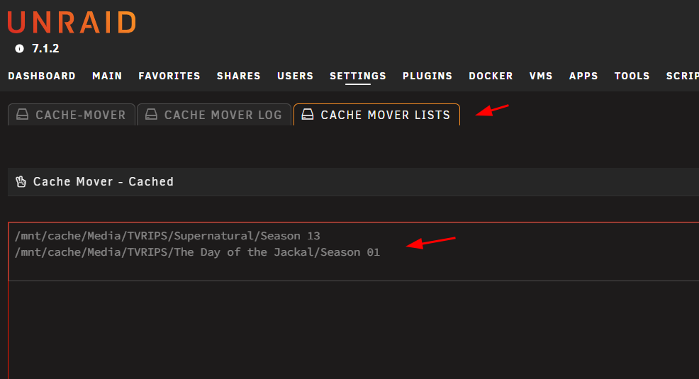

I am having an issue with CACHE-MOVER where it is working but it takes 40 minutes for the plugin to recognize a movie is playing and then move it to the cache drive. You can see that I have even set my corn job to go every 2 minutes instead of every 10. It doesn't seem to make a difference. Do I have something set wrong?
** Update to this. I am now getting the following error.
May 29 12:39:35 Cyberdyne root: cache-mover: msm: cat: /usr/local/emhttp/plugins/cache-mover/tmp_openfiles2.txt: No such file or directory
May 29 12:39:35 Cyberdyne root: cache-mover: msm: not matching tv|hdtv|sdmovies|hdmovies|anime, breaking here
Edited by UninspiredENVY

@alturismo The plugin doesn't work, I mean it does work but only for new files.
Please look at the screenshots, in case 1 the movie was already in cache drive as was watched this morning, plex decided to start using file in the disk1 instead of cache. It never changed to cached as well.
In second case, the file was only on the disk1 so plugin did the job, copied it to the cache and switched.
Not sure what is wrong in my case, why is it not using cached files isntantly? Is it because I use zfs on this chace pool? Is there something wrong in config? Just ot let you know I tested multi mode as well.
Edited by Joloxx9
ok, as it seems the pinned posts are gone i ll describe what i guess your issue is (there is a description in this thread).
may ahead, this plugin cant control what Plex is doing, it only does jobs on the Server itself.
so, you are using a pool device "outside" your regular Shares for caching Media Files, which does work "live" but cant work with existing files as plex cant see the files from its point of view ... as your Share /data inside plex doesnt include your UAD cache disk.
to achieve this, i recommend using mergerfs to build virtual Shares which includes the UAD cache pool device, then plex can benefit of cached files ...
i ll search the pinned posts and link them here.
if thats correct (UAD ssd pool device for caching) then yes, needs some different setup on Share Management.
about zfs, i did test zfs here and it worked out on regular mode, for media server only mode it should always work, but i ll take another look therefore when i have more free time, still under construction here in my new house ;) im usually not using zfs as its personally overhyped for homelabs, but thats my personal oppinion ;)

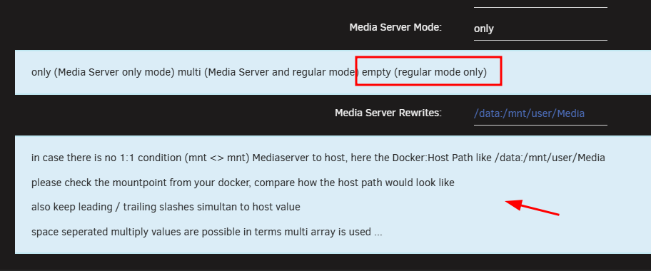

Help needed here, I tried to set this up months ago, it’s still not working. Regular mode seems fine, it just can not see jellyfin activity.
Edited by YsHaNg
did you try http instead https ? its LAN ... may try http and port 8096 instead
Yes I tried, not working. I have this setting in my jellyfin because I mostly connect it from Internet.
On 6/1/2025 at 4:29 AM, alturismo said:
please let me know if thats a described setup in your case.
Hi I have tried to fix it, and that trick with mergeFS fixed the issue :)
Could you possibly expand the plugin to use jellyfin and plex at the same time? I do have plex for most users(including myself) and jellyfin for other few.
is host access enabled on your system ? depending now on your overall setup ...
SSL on, you should enter the external hostname instead LAN IP, may try this then.
