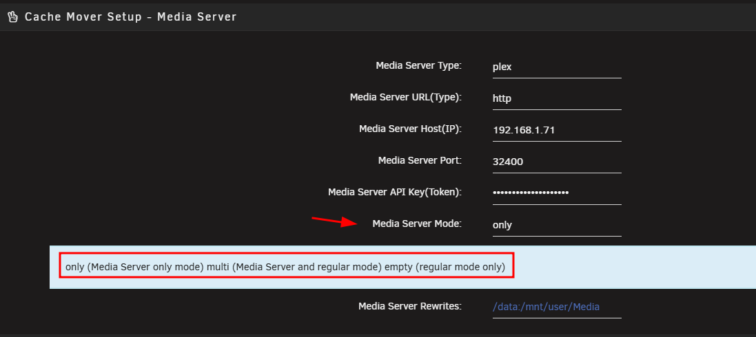

I have been trying to set up the Cache Mover Plugin for a while now. It seems to work from time to time, but it is not consistent. It is also telling me that it can't access the following locations.
May 12 17:32:40 Cyberdyne root: cache-cleaner: chmod: cannot access '/mnt/user/system/mover/mover_excl.txt': No such file or directory
May 12 17:32:40 Cyberdyne root: cache-cleaner: chmod: cannot access '/mnt/user/system/mover/mover_ignore.txt': No such file or directory
Do I need to create these?
I am also wondering about media subfolders, mine are named: hd movies, hd tv, sd movies, tv and anime. With it requiring a space separator will my naming scheme not work?
cache cleaner log.txt cache mover log.txt
Edited by UninspiredENVY
I added logs and screen shots of my settings for reference.
yep, would be useful in combination with mover tuning to temp exclude them to get moved off
exactly, actually i didnt implemented support for "spaces" in dirnames, you can try to put the in quotes ... never tested, spaces in root dirnames are not a good idea anyway in my personal enviroment ;)
So I added those files and it still doesn't seem to be working right. I've seen it move a few shows but they arent even ones that people are watching. What could I be doing wrong?
It continues to move Doctor Who as shown below but nobody is watching that show.
as we see its triggered by reg mode, meaning, may anything accessing the file triggering ...
try switch to Media Server mode
then it will only trigger if the Mediaserver will return playback.
I must have something setup wrong with my plex docker then because I cant get it to find anything at all if I switch it to only mode. Is there something I can send you to take a look at my setup and help me get this set properly?
When I set the cron to started it doesn't run any logs. The cache cleaner logs start but not the cache mover logs.
****Thanks for all your help on this. It looks like my issue is resolved and everything is working correctly now.
Issue resolved
