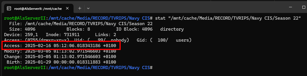

3 hours ago, Viper020GER said:
any Idee?
something on your system is accessing (and modifying) the access time on your files/folders ...
as you are nr. 3 now ... i almost guess it may has something todo with mover tuning plugin.
@Masterwishx may i ask if mover tuning is accessing (and manipulating) files ? just as question if there was a change lately.
manipulating by change access time as sample

15 hours ago, Viper020GER said:
any Idee?
looks like i have no idea ;)
so, what i basically see, cache-mover doesnt modify anything after (always logging those events, see few posts upper)
Mar  5 21:42:05 Unraid root: cache-mover: msm: update access time: /mnt/cache/Filme/WarGames - Kriegsspiele (1983)
so this was the last time cache mover triggered a update as file been busy ...
now, what i basically see in cleaner, all folders are currently "0" hours away since last time "something" modified" the access time, you can check yourself as sample
stat "/mnt/cache/Filme/WarGames - Kriegsspiele (1983)"
and check your "access" time there, sample
thats what im looking for to validate file was "not in use" ... and im pretty sure your return will always be pretty "fresh" dated, so "cleaner" wont process further as its still "in range".
thats the current state i can see and tell, may any other plugin, app, ... invoked meanwhile in your setup which may triggers a access on those files ?
as someone else already tested without cache mover, it was "updated" anyhow ... but thats obvious as mentioned, cache mover will always log those events in terms cache-mover would have done it ...
so short, cant tell how to help besides a rewrite here and building a own "database" with last access times instead using filesys access times ... i think about it if there are more having issues, but may please check your apps, sorry for now.

ok, my plugin does as follows
- 1st time you start watching, it will copy (not move) the season to the cache and switch "live" to cache
- it will update access times on the season folder
- it will keep files as long as you set them (last access then, sample 240 hours for 10 days from last watched episode)
- after this period "not watched anymore), it ll delete from cache
so, personal opinion, i dont have to wait for the next day, it will even switch the access to cache on episode 1 and disk/s can directly go back to sleep, you have the complete season already on cache (who is watching partly ...).
bonus, less disk activity and no "ping pong" ... copy from array to cache and copy back to array and when i watch 1 epsiodes it will move again until the "10" are reached ...
and may its not clear what "live" means, that was the major point for me, sample, when i watch a movie now.
plugin detects playback (sample after 5 Minutes)
plugin copy movie to cache while played (lets say takes another 5 Minutes)
plugin switch filesystem access FROM array disk to CACHE disk LIVE in background
disk is "free" and will spin down after period (sample 15 Minuts here)
so, even while randomly warching a movie from array disk this will be cached and used from cache instead array disk ... so live means, while playback is running the switch from disk to ssd will happen ...
so sorry, i see no benefit here for waiting "on desk" ;)
