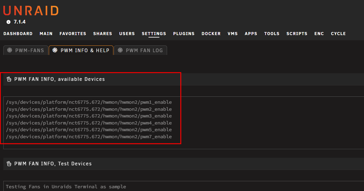

I just installed pwm fan on my T440 server with Unraid.
I'm trying to get functionality like HD Sentinel Pro that I used on Windows, to warn me of drive overheat, and control the fan appropriate.
By default, the T440 seems to control the FAN based on CPU load only, and the drives can be hot, but the fan stays at idle rate.
In the plugin settings, under "PWM FAN INFO, available Devices" nothing is shown. Does that mean pwm fan did not automatically detect my FAN control?
Is it possible for me help if find the fan and fan control?
exactly, should look somehow like this
can be either you need some driver to detect them or you are not using pwm fans (3 pin dc fans instead).
