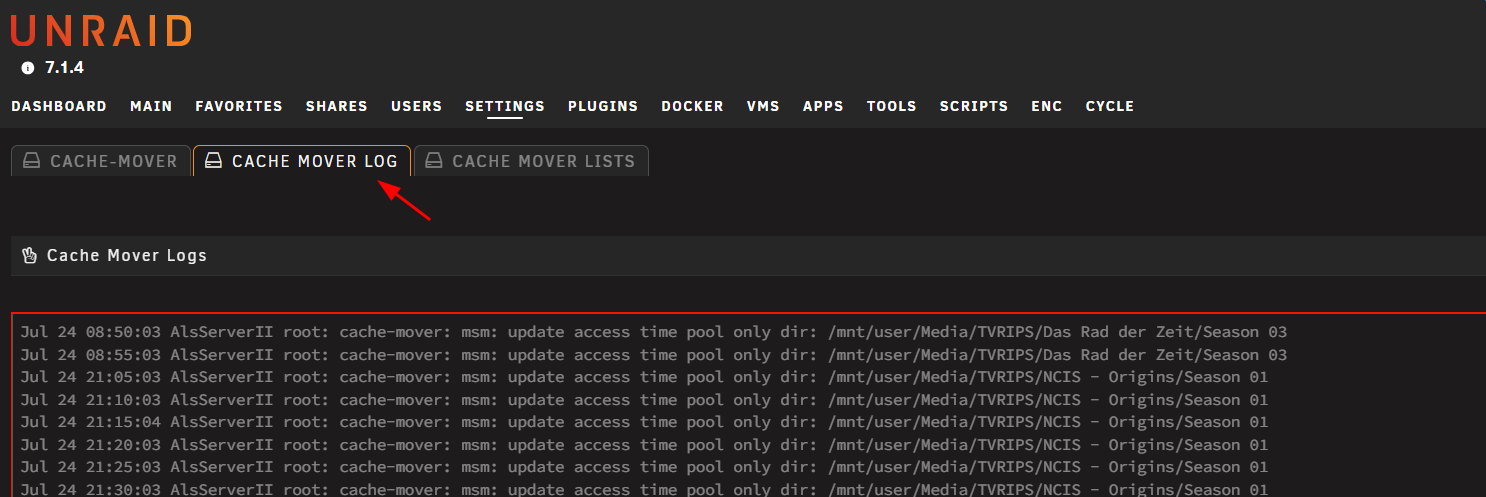

Good Morning,
after hours of try und error i have the mover tuner partially working at the moment.
Problem 1 :
The Mover does not work in Media Server Mode
In Media Server Mode, the playback is not recognized.
I attached the cache mover picture.
The other 3 pictures show my folder structure and my plugin configuration.
Problem 2:
The Plugin does not delete files from my cache drive, although the 24 hour wait time is long gone.
The log says the file are still in range although the 24 hours are over.
What can i do to solve my problems ?

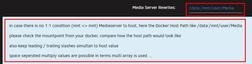

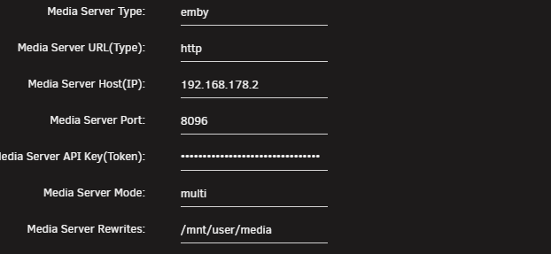

2 aspects to consider and correct
1/ multi mode, only when you also want files outside emby usage be taken care off ? reall ywanted ?
2/ check your configuration and may read the help texts ...
your config
blueprint and help text ...
may start correcting this, then we can loook further in terms you have still issues.

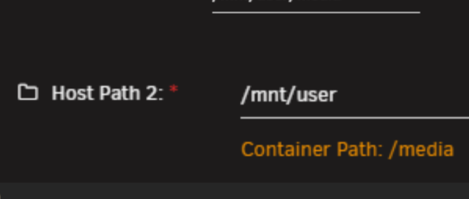

2 hours ago, alturismo said:
there are the pathes from your Server, sample /mnt/user/Media/Filme, now, how does your emby docker mounts look like ?
My docker mounts are :
Edited by Gepelmario
My library pathes in the emby settings are the following:
1 hour ago, Gepelmario said:
docker mounts are :
Se, your case would be then
/media/Media:/mnt/user/Media
your config

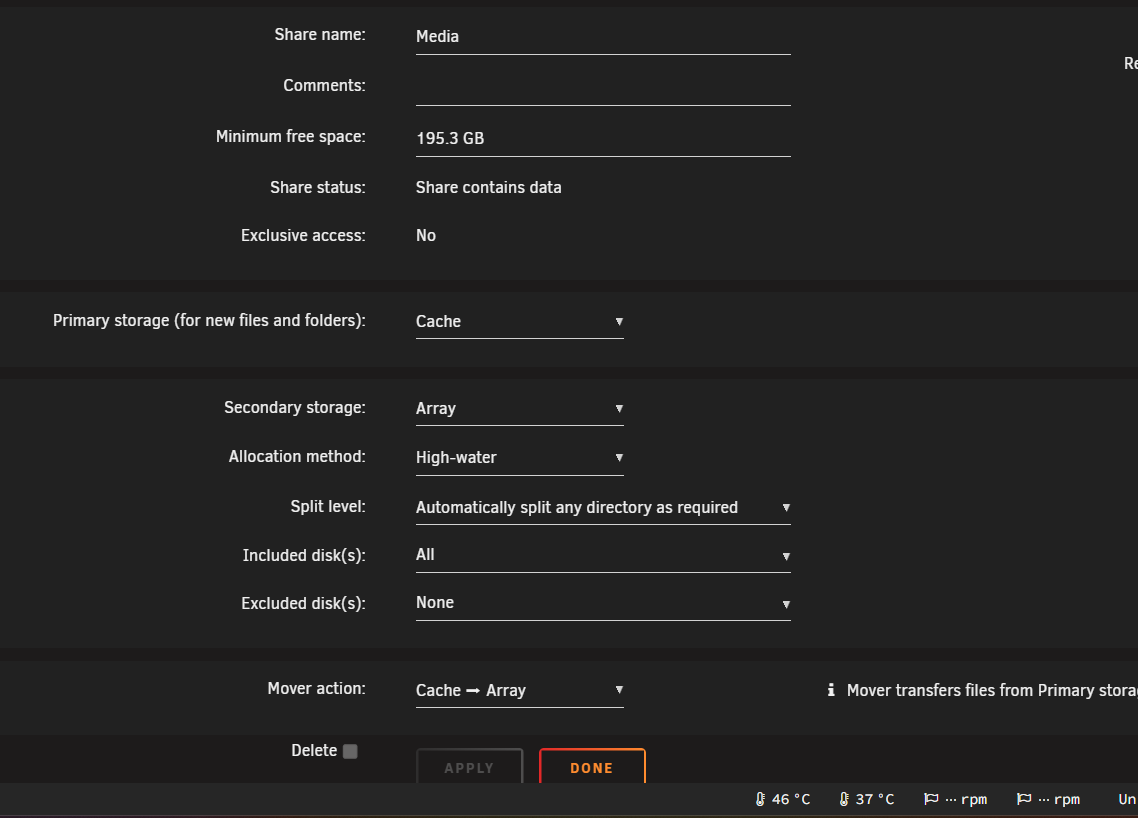

may a screen from your shares page please to see your disk / cache layout for Filme and Serien
as requested,
or did you mean something else ?

ok, seems your Media Share is download-ssd > array, then fine

now, when running a movie or a show (may change your wait time to a lower value for now, like 5), please execute in terminal
/usr/local/emhttp/plugins/cache-mover/scripts/cache_mover1
what is the respond in syslog ? you can also check in cache mover page then log ...
