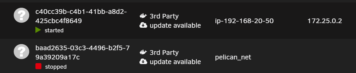

i did poke in the files and found a reference to the weird ip- network that popped up. But i havent found under which circumstances that interface gets created.
if a.ForceOutgoingIP {
		enableIPv6 := false // define a bool variable
		e.log().Debug("environment/docker: forcing outgoing IP address")
		networkName := "ip-" + strings.ReplaceAll(strings.ReplaceAll(a.DefaultMapping.Ip, ".", "-"), ":", "-")
		networkMode = container.NetworkMode(networkName)
But how you triggered that, is a mystery to me at this point in time but it seems it has something to do with the way allocations are handled.

the 0.0.0.0 made it create a new network container.... I think I may have messed up on something! i got to start over
Im intrigued now. Could you share your webpanel settings for that node and the config.yml? of course, stip the
uuid: token_id:  token: and any other personalized info from it

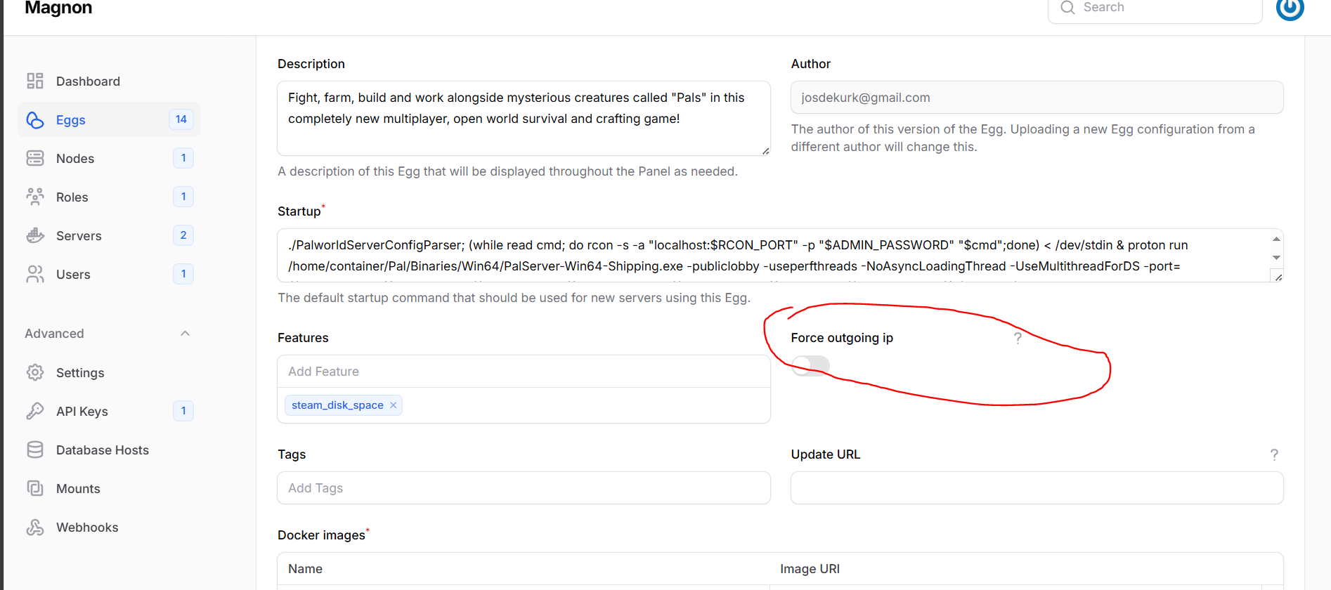

Also. does the Egg youre using have a "force_outgoing_ip" option?
Edit:
Turn this off in the Eggs @Gorden
Edited by Mainfrezzer

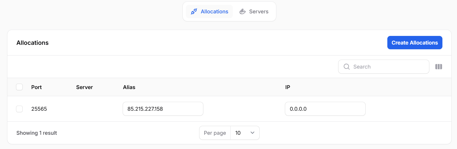

Glad the first thing was solved.
The allocation part is a bit unintuitive, i would say.
Just pick any ip and after you added them, you can do the following
0.0.0.0 ensures the gameserver is listening to all interfaces and can actually start and not complain about not being able to bind to that ip address and the alias, is what is shown everywhere in the ui. So you can pick what address is to be shown.

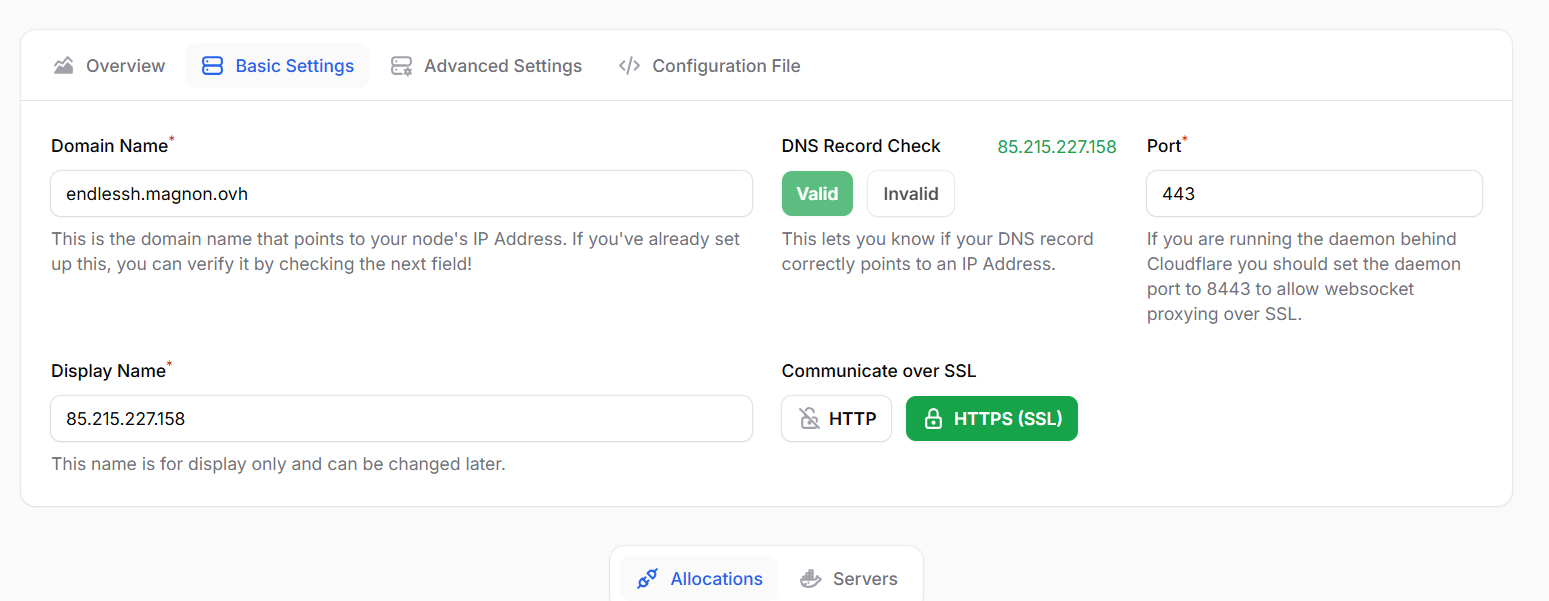

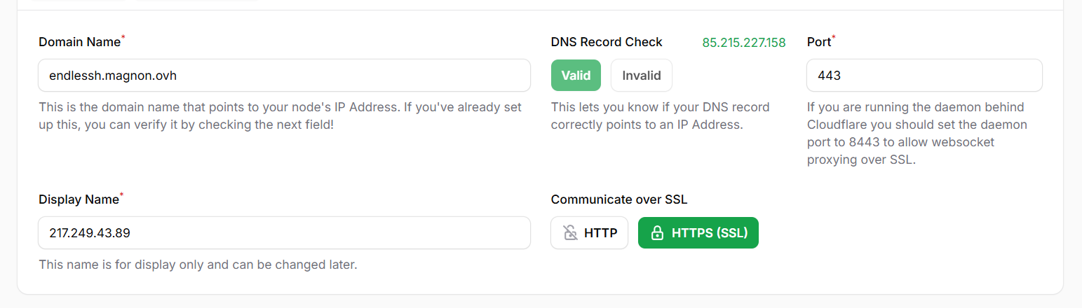

Thank you. I set it to the 0.0.0.0 addresses.

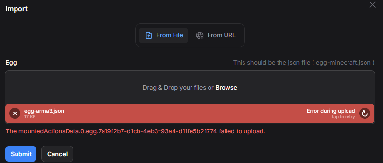

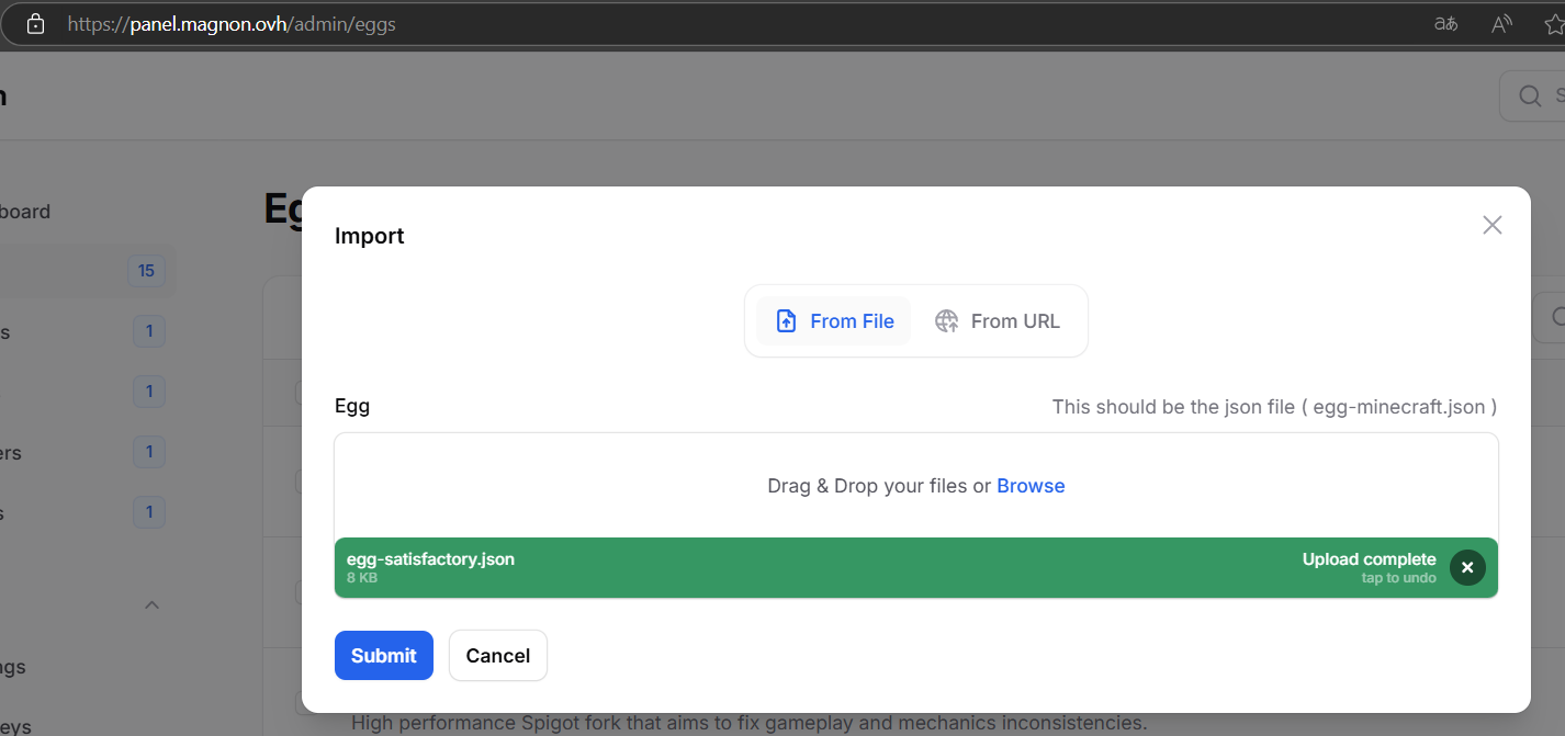

1. Uploading eggs,
I can pull eggs via a URL but cannot with a local JSON
 Is there a setting or something I'm missing?

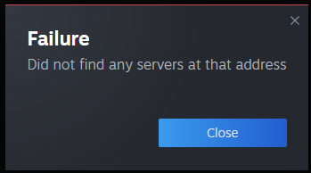

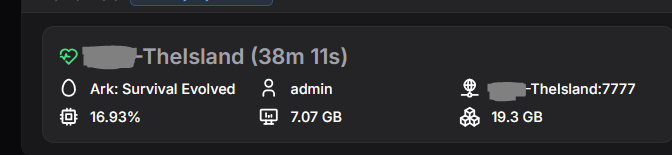

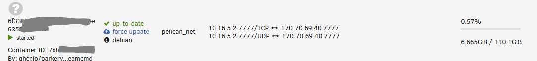

2. Game server
I created a ark:se server, it shows up and running.Serverrunning.PNG.30fead85f9ab585becb3879845ac12a2.PNG

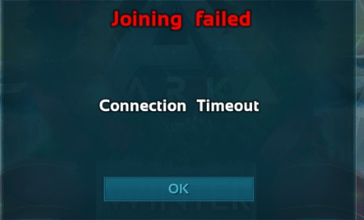

Is it normal that it is using my hosts IP instead of the Wings?
It cannot be found even if I try adding it to my favorites on steam client using any of the IP's:
Should the network be routed through the wings?

I need to check that, i do have the issue with the json upload too. Ill get back to that tomorrow.

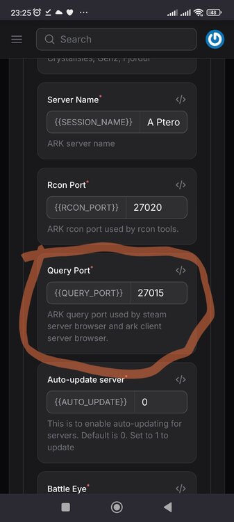

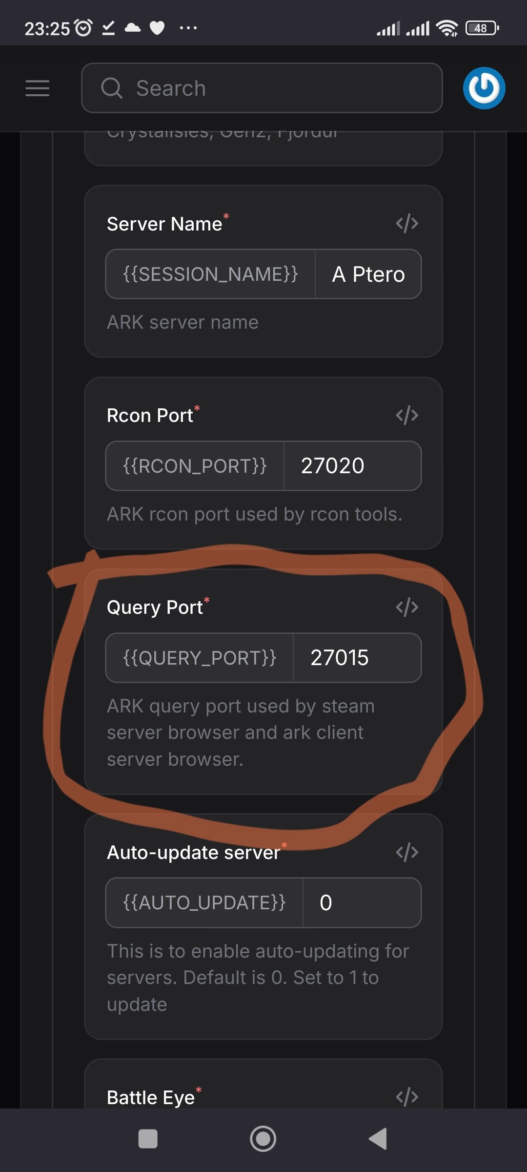

Thats an issue with steam games, you need change the query port from 27015 to 7777Screenshot_2024-12-30-23-25-20-034_org.mozilla.firefox-edit.thumb.jpg.add627a98900bf5e49dc5f0a28e21641.jpg
To the IP part, thats normal. Its a bridge network. The containers are not getting tunneled over the wing container. You can make use of unraids feature for wireguard Tunnels for dockers with pelican, so you can expose the gameservers over a vps for example.

Edit:
YES!!! that was the problem!!! maybe I did activate it while the server was already running and thought it wasn't the issue. Thank you!
Thank you, you are a boss, I can see the server now. When connecting, from my pc on the same local network, It says connecting but then times out?
Edit: got it right, The game port and query port was set to 7777, I changed the game port to 7778. Now I'm able to connect to the server.

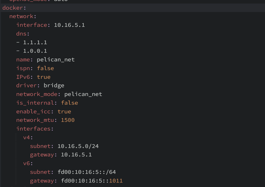

debug: false
app_name: pelican
uuid:
token_id:
token:
api:
  host: 0.0.0.0
  port: 8080
  ssl:
    enabled: false
    cert: /etc/letsencrypt/live/panel.mydomain.com/fullchain.pem
    key: /etc/letsencrypt/live/panel.mydomain.com/privkey.pem
  disable_remote_download: false
  upload_limit: 256
  trusted_proxies: []
system:
  root_directory: /var/lib/pelican
  log_directory: /var/log/pelican
  data: /mnt/user/appdata/pelican-wing/data
  archive_directory: /mnt/user/appdata/pelican-wing/data/archives
  backup_directory: /mnt/user/appdata/pelican-wing/data/backups
  tmp_directory: /tmp/pelican
  username: nobody
  timezone: Asia/Riyadh
  user:
    rootless:
      enabled: false
      container_uid: 0
      container_gid: 0
    uid: 99
    gid: 100
    mount_passwd: true
    passwd_file: /etc/passwd
  disk_check_interval: 150
  activity_send_interval: 60
  activity_send_count: 100
  check_permissions_on_boot: true
  enable_log_rotate: true
  websocket_log_count: 150
  sftp:
    bind_address: 0.0.0.0
    bind_port: 2022
    read_only: false
  crash_detection:
    enabled: true
    detect_clean_exit_as_crash: true
    timeout: 60
  backups:
    write_limit: 0
    compression_level: best_speed
    remove_backups_on_server_delete: true
  transfers:
    download_limit: 0
  openat_mode: auto
docker:
  network:
    interface: 10.16.5.1
    dns:
    - 1.1.1.1
    - 1.0.0.1
    ispn: false
    IPv6: true
    driver: bridge
    network_mode: pelican_net
    is_internal: false
    enable_icc: true
    network_mtu: 1500
    interfaces:
      v4:
        subnet: 10.16.5.0/24
        gateway: 10.16.5.1
      v6:
        subnet: fd00:10:16:5::/64
        gateway: fd00:10:16:5::1011
  domainname: ""
  registries: {}
  tmpfs_size: 100
  container_pid_limit: 512
  installer_limits:
    memory: 1024
    cpu: 100
  overhead:
    override: false
    default_multiplier: 1.05
    multipliers: {}
  use_performant_inspect: true
  userns_mode: ""
  log_config:
    type: local
    config:
      compress: "false"
      max-file: "1"
      max-size: 5m
      mode: non-blocking
throttles:
  enabled: true
  lines: 2000
  line_reset_interval: 100
remote: panel.mydomain.com
remote_query:
  timeout: 30
  boot_servers_per_page: 50
allowed_mounts: []
Search:
  blacklisted_dirs:
  - node_modules
  - .wine
  - appcache
  - depotcache
  - vendor
  max_recursion_depth: 8
BlockBaseDirMount: true
allowed_origins: []
allow_cors_private_network: false
ignore_panel_config_updates: false
The issue was the force outgoing IP. just linking my config as requested.
@Dr0on you can download the container with the tag "expbeta16" i.e.
mainfrezzer/pelican-panel:expbeta16
Edit: its fixed with the newest update
I know kind of whats causing this but will need some time to come up with a permanent solution to that problem. Also exists in the official build/container.

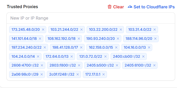

Im pretty sure that i solved the issue now. At least my tests with a cloudflare tunnel were successfull. i also tested nginx.
in case its still not working, add the cloudflare ips to the trusted proxies under settings and in case you funnel it over unraid, include the unraid docker ip as well.
In my case, its enought to set "172.17.0.1" on the trusted IP list. I just have the cloudflare tunnel container (172.17.0.5) directed at 172:17.0.1:800.
I would reckon that for the public proxy, you have to add the public ips.
proxies.PNG.6e6e4ce9e6e221a957d76da2175d4079.PNGworks.thumb.PNG.5188b9a073a7d2acba48a4146cdcb3d3.PNG
also, its no longer running over caddy.
If something pops up thats not working, yell at me. 😅
I really really appreciate your work! thank you!!!

Thank you, I tested and was able to upload from my PC. You are a champ.

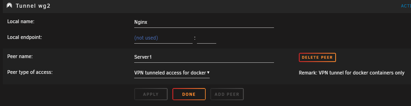

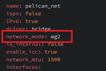

Can you please expand more or give me a direction to follow on the wireguard tunnels?
Edited by Dr0on
Of course.
Im gonna outline the 2 common processes in case someone else needs it at some point too.
First: The "home" way.
This will use your Public Home IP to be able to join the game servers. The Panel and Wing are still behind the Proxies.
In case you have a static ipv4, you can just enter your own home public ip4 in the alias Parts. This will display your own ipv4 throughout the UI. (The same applies to the sFTP option thats available)PublicHomeIP.thumb.PNG.f18c168aa61e7fc1ecfb24a8406ba92f.PNG
Once you finished adding the allocations, you need to open the ports in your router/firewall to enable people to join the servers via your home ipv4 address.
Second: The "VPS Tunnel" way.
For that, you idealy have a cheap VPS somewhere. On the VPS you ideally install wireguard and docker*.
Docker we can use for the Proxy, you could skip that part when you use Cloudflare but overall it would make things "simpler" since the DNS entries for the domains point towards the correct IP but its absolutely not needed.
*Docker is not needed and "only" needed if you wanna use your own reverse proxy.
After you setup Wireguard on the VPS (theres a lot of guides for all the distros Providers offer), you add the wireguard client config to Unraid. Specifically for VPN tunneled access for dockerDockerContainer.thumb.PNG.f06bb10b06f96f5a882b6cfef2f3a737.PNG

All that is needed on the Pelican Wing side of things, is one single change in the config.yml.
The network_mode needs to be changed to the interface that the "wireguard tunnel for docker" is. This ensures all gameserver containers are hooked up to the vpn and their traffic is routed over it.
Edit: Before i forget, the wireguard config on the server should include the following, again, Ubuntu example
Little warning: If you are NOT on Unraid 7 RC-2, this WILL have issues with Minecraft specifically (maybe some others too). Its fixable and i will absolutely help sorting that out.
At this point, if the wireguard tunnel is working, all you need to think about are the port allocations you want to use since we need to add routing rules to the wireguard config on the VPS, so that the traffic, that arrives at the VPS gets routed to the UnRaid server.
(the server might have a seperate firewall where you need to open the ports too)
This is an example for an Ubuntu VPS and a Ark Survival Evolved Gameserver.
PreUp = iptables -t nat -A PREROUTING -i ens6 -p udp --dport 7777 -j DNAT --to-destination 10.123.0.2:7777
PostDown = iptables -t nat -D PREROUTING -i ens6 -p udp --dport 7777 -j DNAT --to-destination 10.123.0.2:7777
PreUp = iptables -t nat -A PREROUTING -i ens6 -p udp --dport 7778 -j DNAT --to-destination 10.123.0.2:7778
PostDown = iptables -t nat -D PREROUTING -i ens6 -p udp --dport 7778 -j DNAT --to-destination 10.123.0.2:7778
PreUp = iptables -t nat -A PREROUTING -i ens6 -p udp --dport 27015 -j DNAT --to-destination 10.123.0.2:27015
PostDown = iptables -t nat -D PREROUTING -i ens6 -p udp --dport 27015 -j DNAT --to-destination 10.123.0.2:27015
This takes the incomming connections of udp port 7777,7778,27015 and sends them to the wireguard client ip of unraid, in this case 10.123.0.2
PreUp = iptables -t nat -A POSTROUTING -o ens6 -j MASQUERADE
PostDown = iptables -t nat -D POSTROUTING -o ens6 -j MASQUERADE
to ensure that all the gameservers can communicate with the "outside" world.

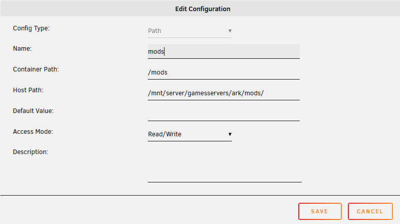

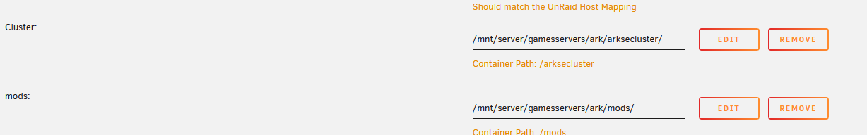

1st thank you for all the assistance so far.
Ok, so I found this page: https://gameservershub.com/forums/threads/setting-up-an-ark-survival-evolved-cluster-on-pterodactyl-control-panel.5334/
more or less followed the instructions.
If you try to map directly to the unraid the wings gives an error. So because the wings docker is the "pc" I added map folders as following:
Now wings do not give the error.
Then I continued to follow how to mount to a server.
.yml file
mounts
mount in server
But getting an error the file path does not exist.
Error Event [fxxxxxxxx-cf6a-xxx-9c68-xxxxxxxxxxxx]: environment/docker: failed to run pre-boot process: environment/docker: failed to create container: Error response from daemon: invalid mount config for type "bind": bind source path does not exist: /arksecluster
sorry I'm a total noob when it comes to containers, am I doing something wrong?

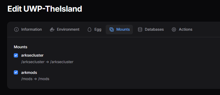

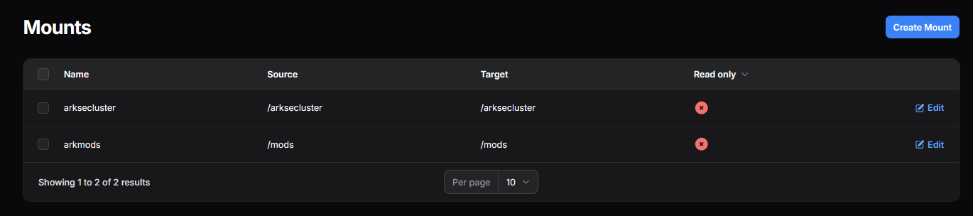

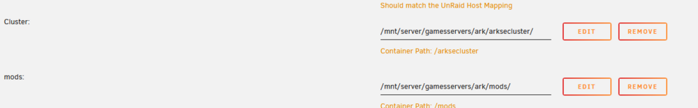

Docker is operating on Unraid, not the Wings Container. It doesnt have access to what you map inside the Wings container.
If you would mount "/mnt/server/gameservers/ark/mods/"  & "/mnt/server/gameservers/ark/arksecluster/", that would work.
Edit: to be a bit more precise,
You can map 1:1, as i did with the Pelican - Data for example.
Host: "/mnt/server/gameservers/ark/mods/" Container: "/mnt/server/gameservers/ark/mods/"
Although, im not sure if you really need to mount the paths into the Wing Container first, although could be.
The Panel mount options should look like
Source: /mnt/server/gameservers/ark/mods/ target: /mods
Source: /mnt/server/gameservers/ark/arksecluster/ target: /arksecluster
