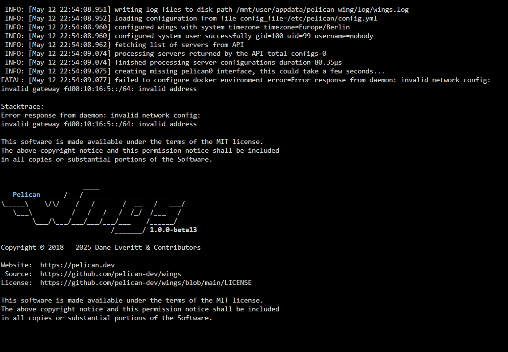

        gateway: fd00:10:16:5::/64

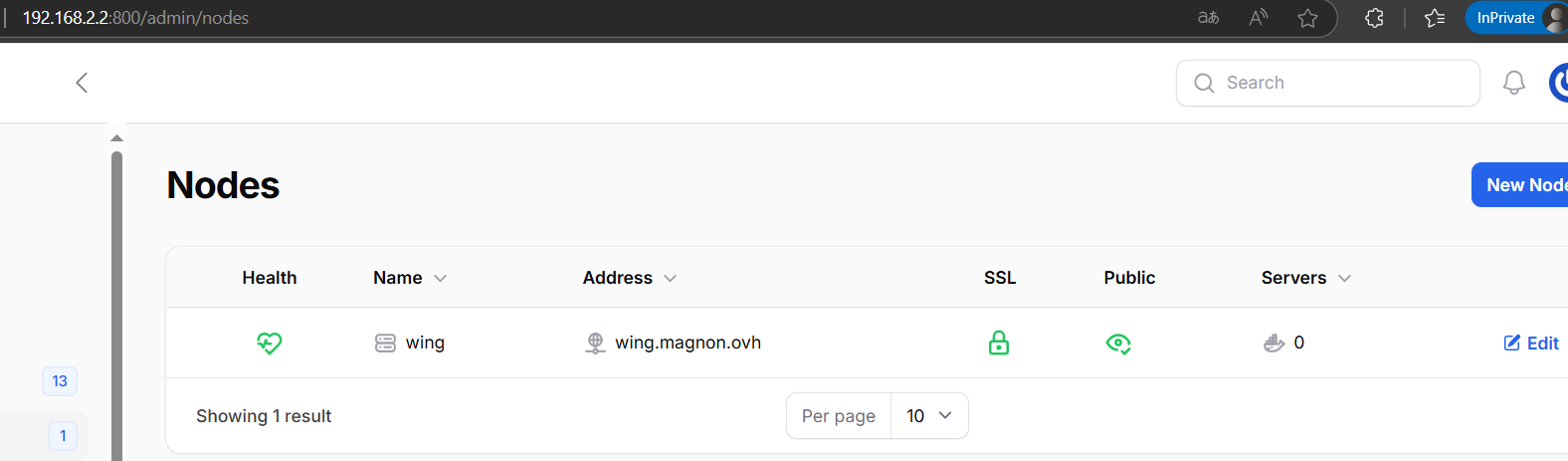

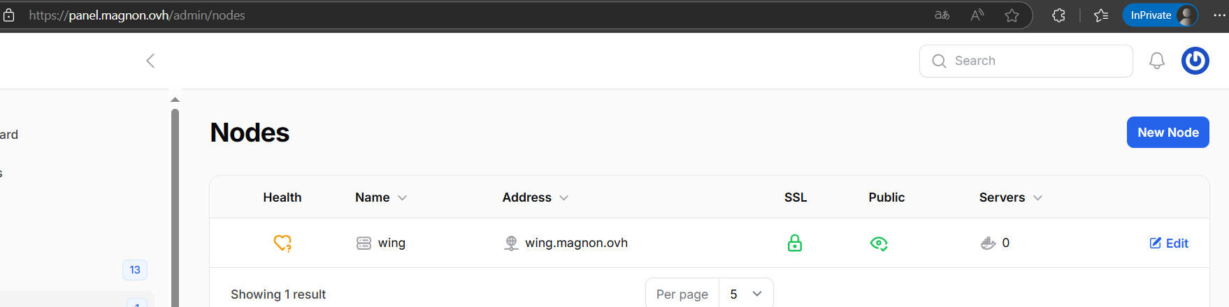

I noticed that when I click on "edit" on the node, those values (cpu usage, memory, storage) actually change, so I guess it is somewhat successfully connecting to each others ? But the status is still "?" and I can't create a server or see the node anywhere.image.thumb.png.aee87369dc1c072af779c9679bfe16b8.png
20 hours ago, Niyah said:
Hey ! Yeah sorry the nginx screenshots are accidentally doubled, the games.domain.eu is pointing toward 8002.
I have both domains proxied trough cloudflare to my reverse proxy (a nginx proxy manager docker) that forward entrance of both those domains to the pelican dockers.

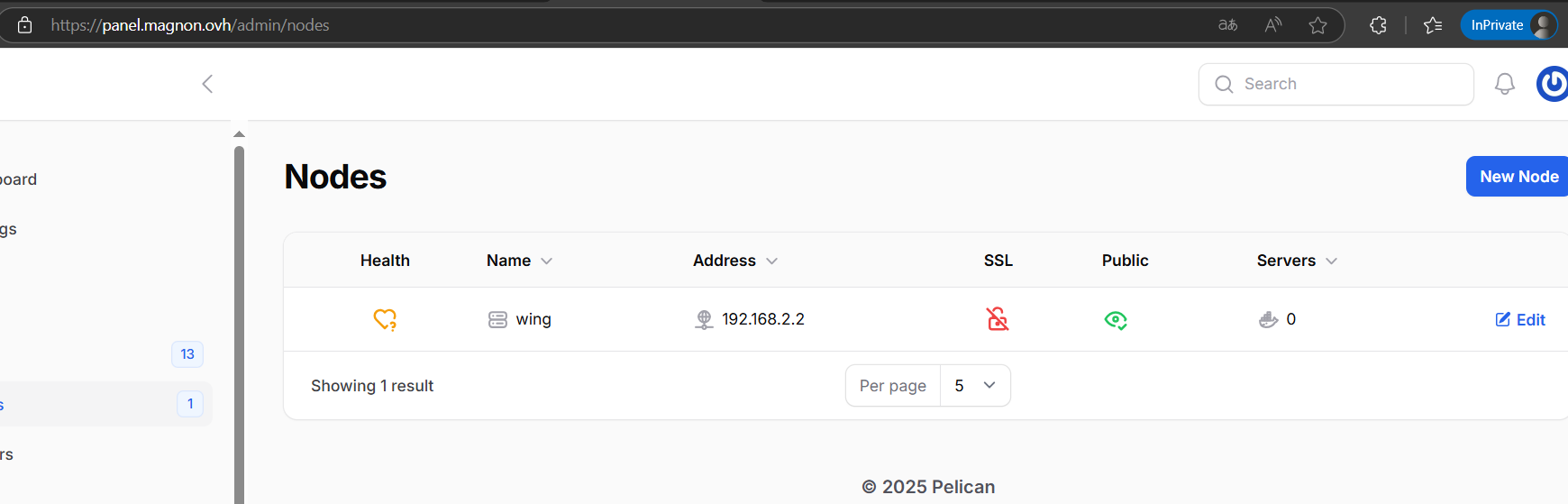

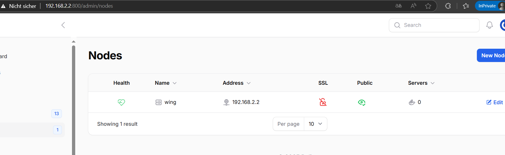

i was able to recreate it. Currently limited with time to figure out what exactly is causing it but it seems like cloudflare is the issue.
using the ip
Edit:
So you can set the panel to access the wing through cloudflare to nginx to the wing and set the wing to access the panel over cloudflare.
But if you access the panel through cloudflare, it breaks
Okay found the issue, in the panel template this was set to http instead of httpsimage.png.3e72fd9b785ff5536f426357982a388f.png
after setting it to https, cloudflare works ( i did set cloudflare as trusted proxies)

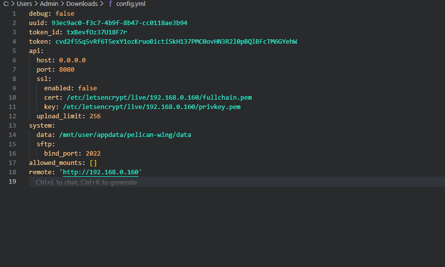

When i start wing after a couple of seconds it closes do you know what it can be
without the log a bit hard to say
but if its a couple seconds afterwards its most likely the missing config.yml

31 minutes ago, Onyxdigital said:
Oh okay, i was made aware of that recently but i still dont have a good solution for that issue yet. Could you use this as your config.yml, that should solve that problem.
You just need to fill your own uuid, token_id and token, also change the timezone to match yours.

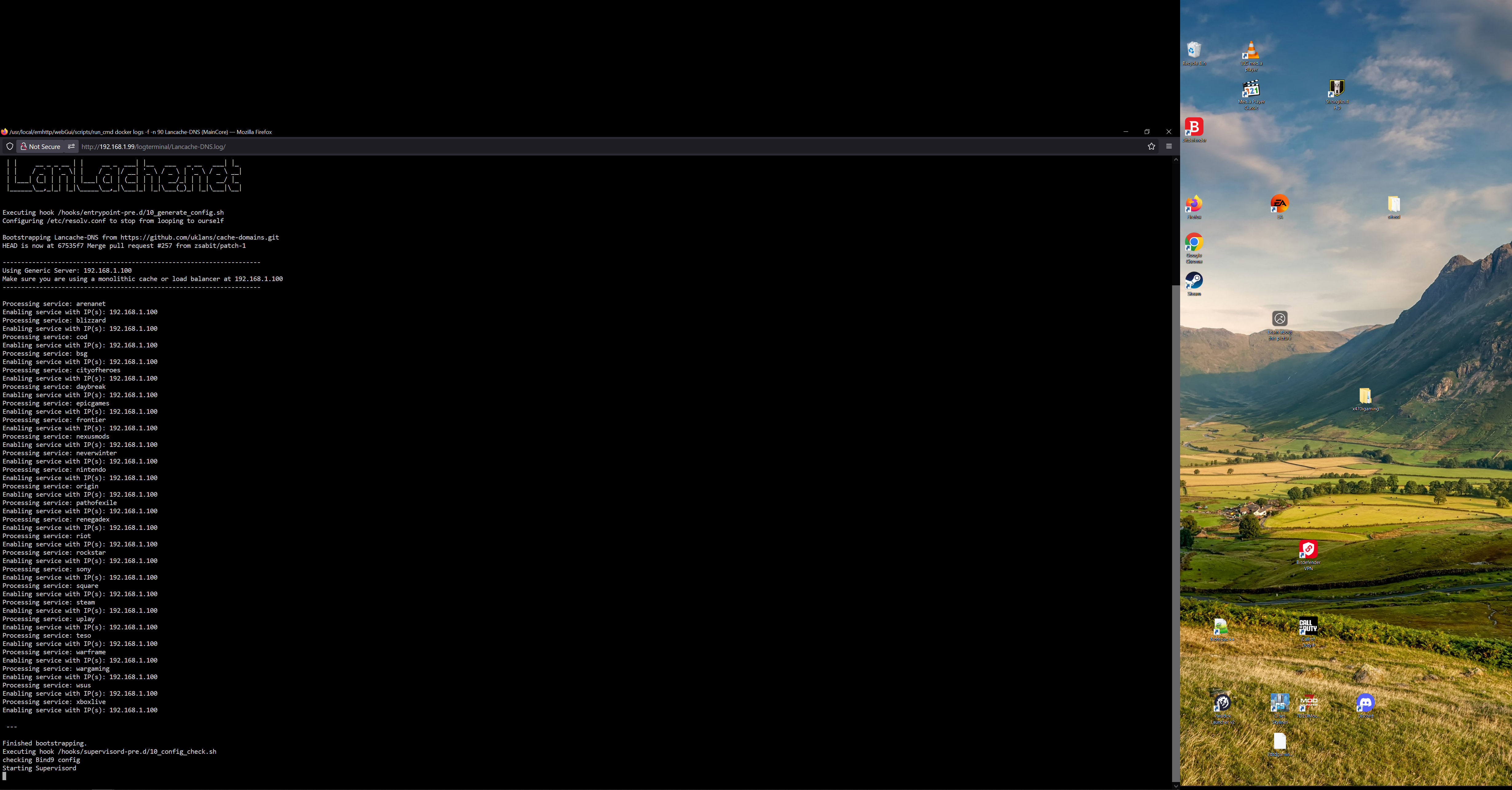

i can login to the panel and start deploying servers with the wings, but for ever server i make it redownloads the whole server files.i have lancache dns/lancahe on the same unraid computer as the panel and wings, where do i set the dns for the panel to look at the lancache first and maybe save on some outside bandwidth?
i have a normal windows computer that i set the first dns to the lancache dns ip and it just works but when i try it on stuff inside unraid it just doesnt
just replace the dns entries in the wing config.yml with your dns server that has the lancache info
i stop wings, change to the config file under that dns and point it too 192.168.1.101(lanche dns), restart wings, it just makes it worse then normal

45 minutes ago, fyfsmedia said:
i stop wings, change to the config file under that dns and point it too 192.168.1.101(lanche dns), restart wings, it just it worse then normal
could you elaborate what you mean by "worse than normal"?
I would suspect that either the dns works or it doesnt when you define it. So i dont think the dns part is the issue or is it? What does the dns say on requests? What does the lancache log say about access and caching?

takes longer to find that its looking for, then when it does find it, it takes like 5 times as long to download then normal, its like its having a hard time working its way out.
i did test it on 3 different machines with 2 different isps now. Its all the same, wether its cloudflare as dns, my dns or a dns with lancache on the same machine as the wing is running on. The only difference that is tangible is wether or not you have exclusive shares enabled in unraid on the relevant disks (i.e lancache and docker) and thats only for the preallocation of diskspace. I test downloaded ark surival ascended and with exclusive shares it was done in seconds while without it, it took minutes. (or instead of exlusive shares direct mount to disk i.e. /mnt/cache/appdata instead of /mnt/user/appdata)
*The tested machines range from a toaster with a celeron n3000 over a j4125 and a 14100, all with a ssd pool as target. The lancache and dns in question was done by this lxc container https://github.com/Mainfrezzer/unraid_lxc_alpine_adguard
Edited by Mainfrezzer
i just dont get what stoping it, its on the same computer or could be on the same nvme, but going over the network on my windows machine gets me gig+ download speeds using the same lancache

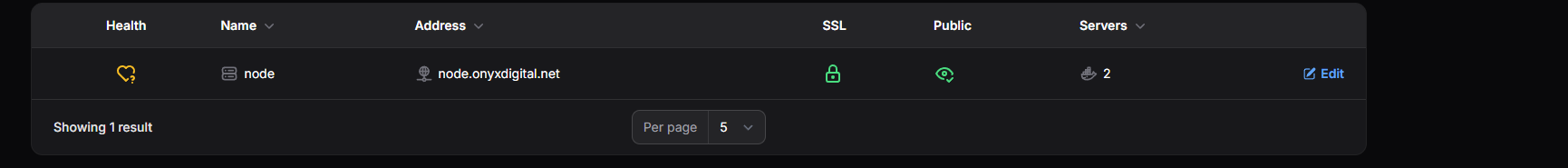

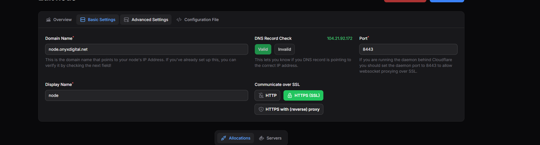

do you maybe know why its not green i use cloudflare tunnel
Nevermind fixed it but Thanks anyway
Edited by Onyxdigital
fixed
Set in the panel 443 not 8443 (the notice there doesnt make any sense https://developers.cloudflare.com/network/websockets/)
For your wing, depending on your configuration you probably have to set it like this
Set the config.yml to 8080 and point your cloudflare tunnel to unraidip and the port you picked here
If you point the cloudflare tunnel directly at the wing container ip, you can leave the config.yml at what it is currently and then point your cloudflare tunnel at wingcontainerip:port from the config.yml

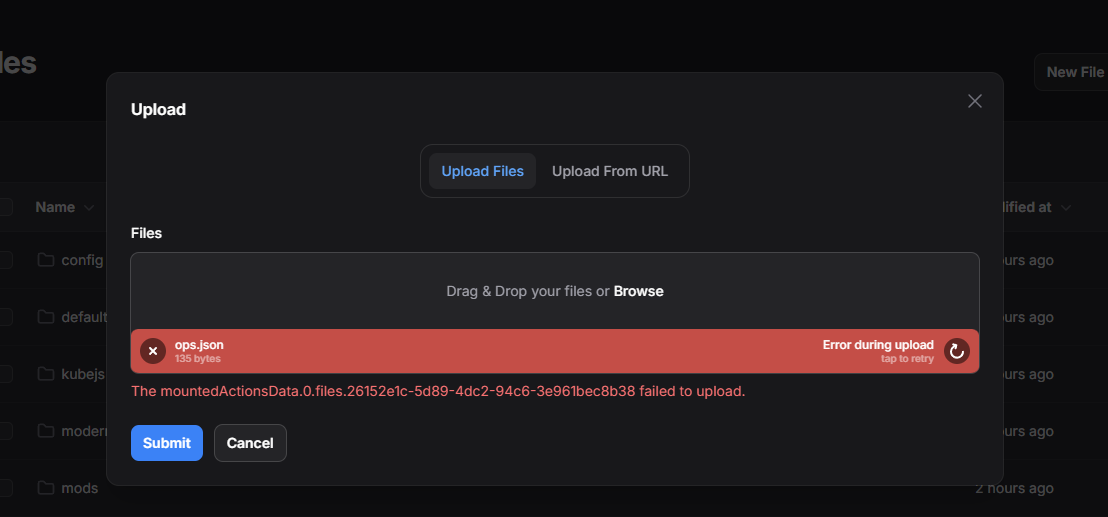

i cant upload files
11 minutes ago, Onyxdigital said:
i cant upload files
You need to set the trusted proxies in the settings of the panel

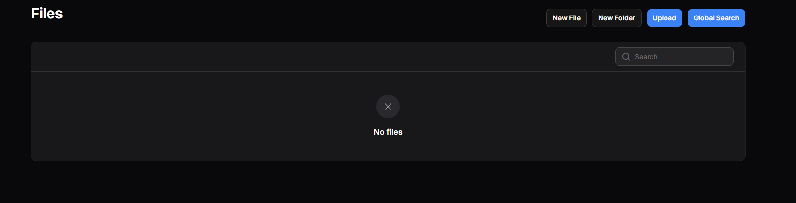

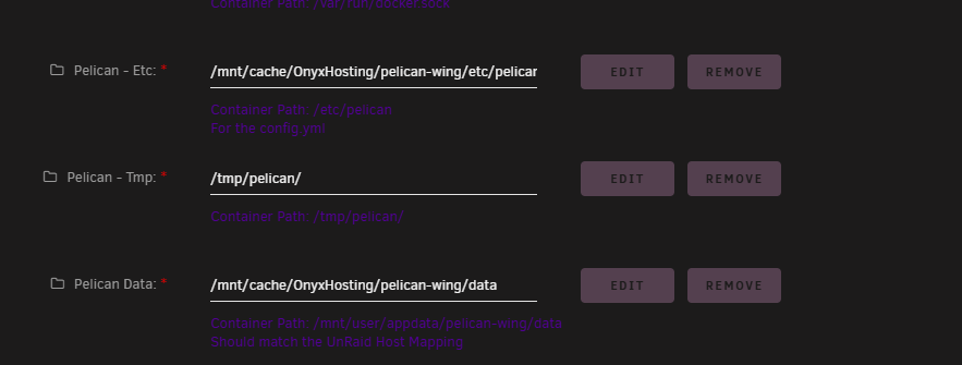

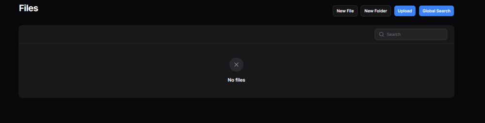

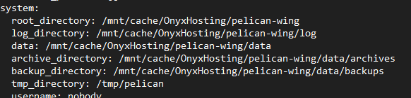

when i try to change my location from /mnt/user/appdata/pelican-wing/data to /mnt/cache/OnyxHosting/pelican-wing/data
it dosent show the files anymore
do you know how i can fix this because i wanna run it on my nvme
You forgot to update the container path in the template, its still pointing towards /mnt/user/appdata/pelican-wing/data for /mnt/cache/OnyxHosting/pelican-wing/data
