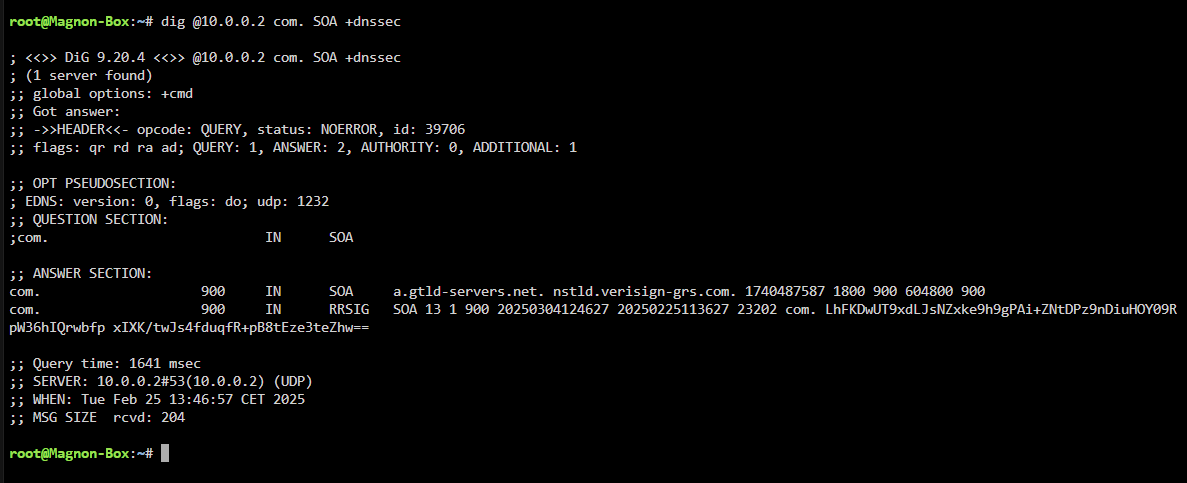

for your second problem. I did push an update which adds the option to create the root.key upon startup.
You would have to include a new variable in your adguard template with the "DNSSEC_ENABLE" as key and a value of 1. Upon start it will start unbound-anchor and create the root.key file at /etc/unbound/
So adding
auto-trust-anchor-file: "/etc/unbound/root.key"
should work without a fuss. (hopefully) if it doesnt, complain please :D
Edit: I actually needed to update the container twice now BUT im pretty sure it works now
Edited by Mainfrezzer

Thanks! Finally had a chance to test the new version and I'm happy to report it works exactly as expected. I also tested with the fail01.dnssec.works and dnssec.works addresses after implementing the new label and config file line pointing to the trust anchor.
SERVFAIL is the expected result when resolving the fail01 variant as it won't use DNSSEC.
I spent a bit of time doing some research before responding because the docs state that you have to periodically run an unbound-anchor to keep the anchor up to date. I assumed we'd need to update the image to run a cron job. From NLnetlabs:
Set the unbound-anchor tool to run at system startup, it is part of the unbound package. This tool checks if the anchor is out-of-date and attempts to update it.
But, I think you actually set it up just right by having unbound-anchor run in the start.sh script. Unless my very amateur docker-fu is way off, that script will run every time the container starts up or is updated, thus achieving what the docs recommend for regular updates since the anchor is managed actively while unbound is running. From NLnetlabs:
Unbound uses RFC5011 updates to keep the anchor updated if it is changed while the computer is in operation, but the unbound-anchor tool is used if it is changed while the computer is not in operation.
I would humbly recommend one edit to your README file on GitHub, though. You have this today:
To get DNSSEC up and running, provide the environment variable DNSSEC_ENABLE with a value of 1. That will create the root.key at /etc/unbound/
But you need to specify the addition of the auto trust anchor file location in the config as well for anyone arriving at the container without this forum as additional documentation. So, something like this maybe?
To get DNSSEC up and running, provide the environment variable DNSSEC_Enable with a value of 1. That will create the root.key at /etc/unbound. Then, just add this line to the unbound.conf file under the server attribute:
Last, and this is really nit-picky so feel free to ignore it, it would be nice to be consistent with your boolean operator in the Unraid template. For the PROVIDE_CONFIG variable it's "yes" but for the DNSSEC_ENABLE its "1". Might be nice to make the DNSSEC_ENABLE be "yes" as well.
I also confirmed the logging recommendation you made. Ultimately, I don't plan to use logging since it doesn't have a good mechanism in the config to limit their size, and it reduces performance, but I get itchy when I can't access logs at all, so this works. For anyone interested, I briefly toyed with redirecting the log file location to /dev/stdout to see if I could get the unbound logs to be available alongside the Adguard logs in the docker logs implementation, but it didn't work. I'm not entirely sure why, but this is good enough for me to be able to review and fix things when needed.
Edited by FirbyKirby

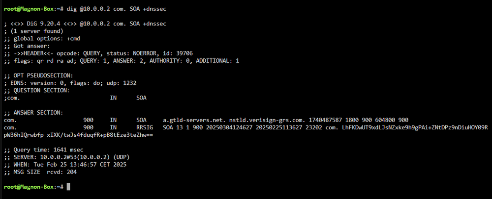

Thats great, good to hear.
What i got from the docs is that unbound itself is managing they keyfile as long as unbound is up and updates it correctly (from what ive seen it creates new subkeys) and the anchor is only used when unbound wasnt running. So setting the anchor at startup was the most logical way.
I will add it to the readme at some point, i did assume that someone who wants to enable dnssec knows about the setting in the unbound config.
The semantic difference between the config "yes" and DNSSEC_ENABLE is mostly for the unraid-template sake. I added the dnssec as an advanced option to it which is not shown unless you expand the options. I find a "yes" as setting is a more clear way for it to communicate what that one specific setting does, as where 0 and 1 would suffice to get the point accross to you and me, it might not to someone else.
(i would otherwise just use 0 and 1 respectively accross all and will be, with the exception for the "provide config" one, that ill keep at yes^^)

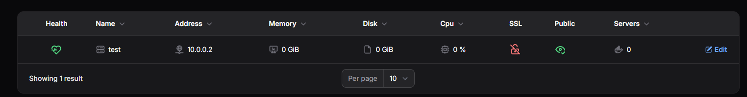

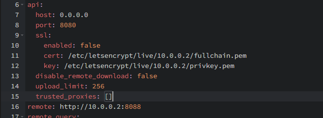

HI there
Is Pelican something you are still supporting? I ask because I am having an issue whereby the node cannot connect to wings. I am attaching my config.yml. I have removed the uui/token/tokenid as they didnt seem relevant.
I did change the ports as the default was being used by something else. Both components (panel and wing) show no errors in the log files. Thanks
debug: false
uuid: uuid
token_id: blank
token: blankh
api:
  host: 0.0.0.0
  port: 443
  ssl:
    enabled: false
    cert: /etc/letsencrypt/live/mydomain.com/fullchain.pem
    key: /etc/letsencrypt/live/mydomain.com/privkey.pem
  upload_limit: 256
system:
  data: /mnt/user/appdata/pelican-wing/data
  sftp:
    bind_port: 2022
allowed_mounts: []
remote: 'http://192.168.1.161:8013'
Edited by korefuji

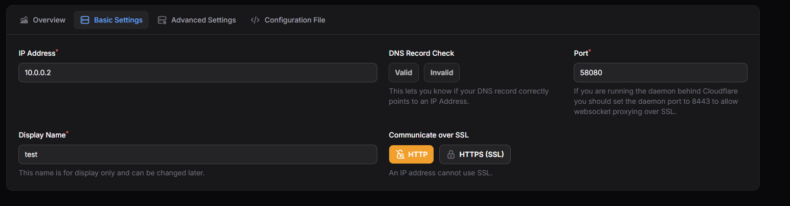

Looks like youre mix and matching domains and ips. If you use https, all has to be https, including how your wing talks to your panel and vice versa.
Edit: also, your wing apparently is running on port 443, which is by default not mapped.
"should" be 8080 there, unless you did add a mapping for 443
Edit2:
I did do a quick internal test
Wing Template

I appreciate your help. So I was able to get it working. I can't however, get it working with my domain. Is it because I need to used the domain for both Wing and Panel? ty

Yes, for example. panel.domain.tld is for the panel, wing.domain.tld is for the wing. Examples for the config for that can be found on page 4, in case it gives trouble.

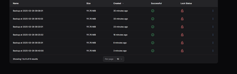

Back with another Pelican question.
I have scheduled backups and they work, but I need to rotate or delete the backups older than x days. I can use the scheduler to delete files, but idk how to schedule it to delete backups.
Someone commented on discord it cannot do this as the files are outside the container. In which case, is it possible to use something else to schedule the first file every x days in that backup folder without it breaking backups?
Given what ive read from that conversations, i think you might have to wait until thats fixed.
That's already the case. If the backup limit is reached the oldest backup will be deleted
(but there might be a bug where this is not working when using S3 backups)
And yes, just deleting the backup folder won't work because the backup metadata is still in the panel database.
From what im seeing here by testing, it does work as expected
Edit a bit later: It certainly does

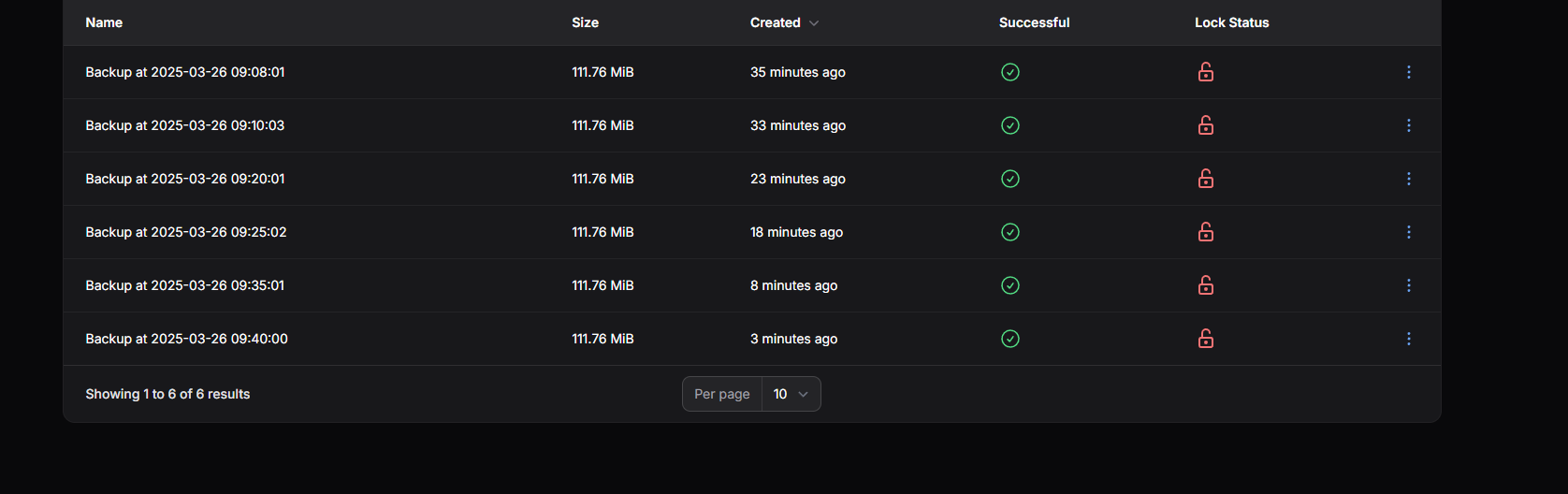

EDIT: I think it's working. It may have been that previous schedules were preupdate, and so i redid them and it seems to be good now
Any idea on how to troubleshoot this then, if it's working for you it should work at my end too. I did update to the latest image, which was the fix for the backup scheduler I believe. I'll re-do the schedule, but can you outline the steps you did if you dont mind so I can replicate this. Thanks
Edited by korefuji

Finally my docker config for wings is below, if i use ssl it will not fully boot wings, If I attempt just port 8080 it will boot but panel will never see it.
