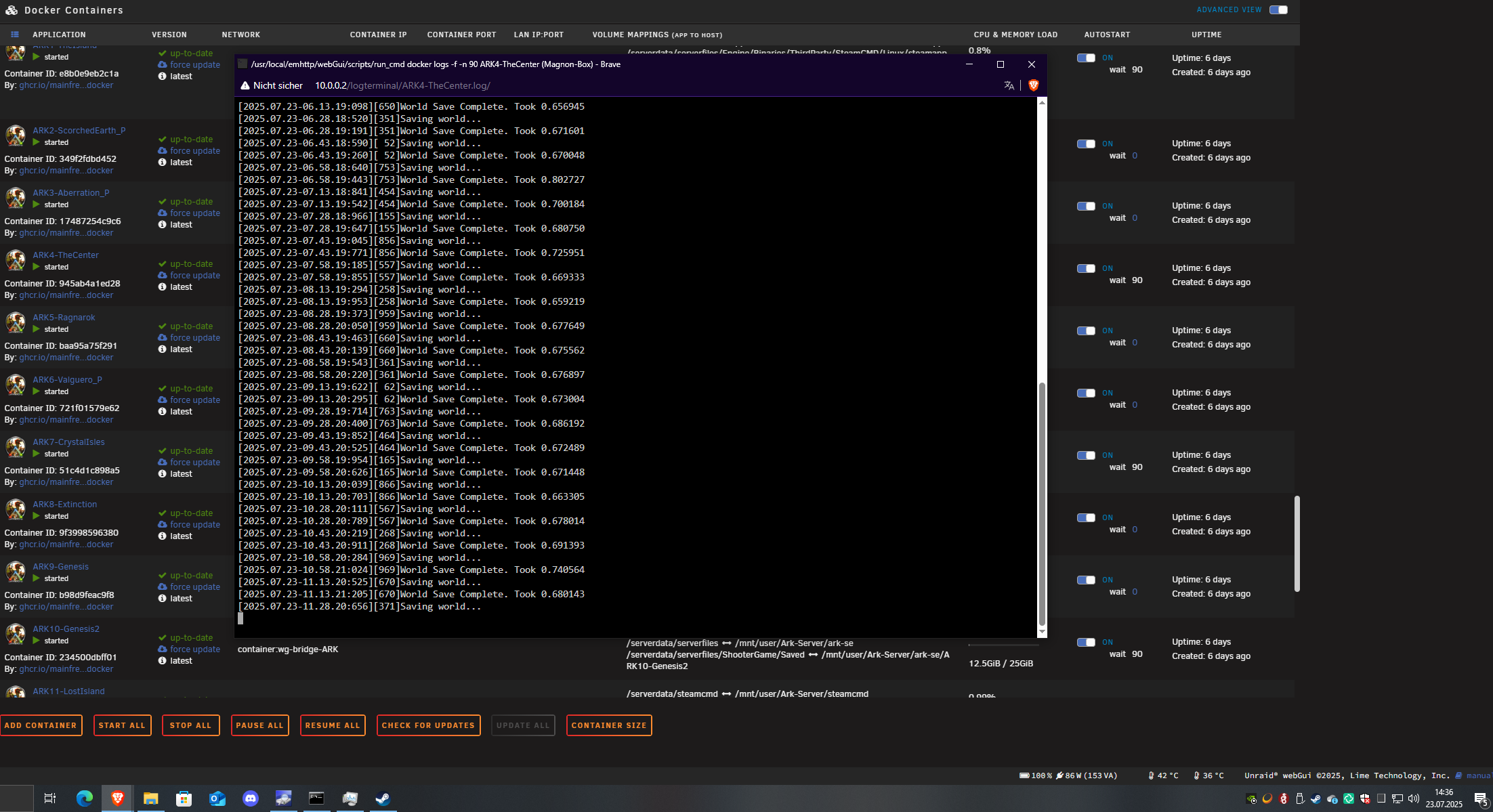

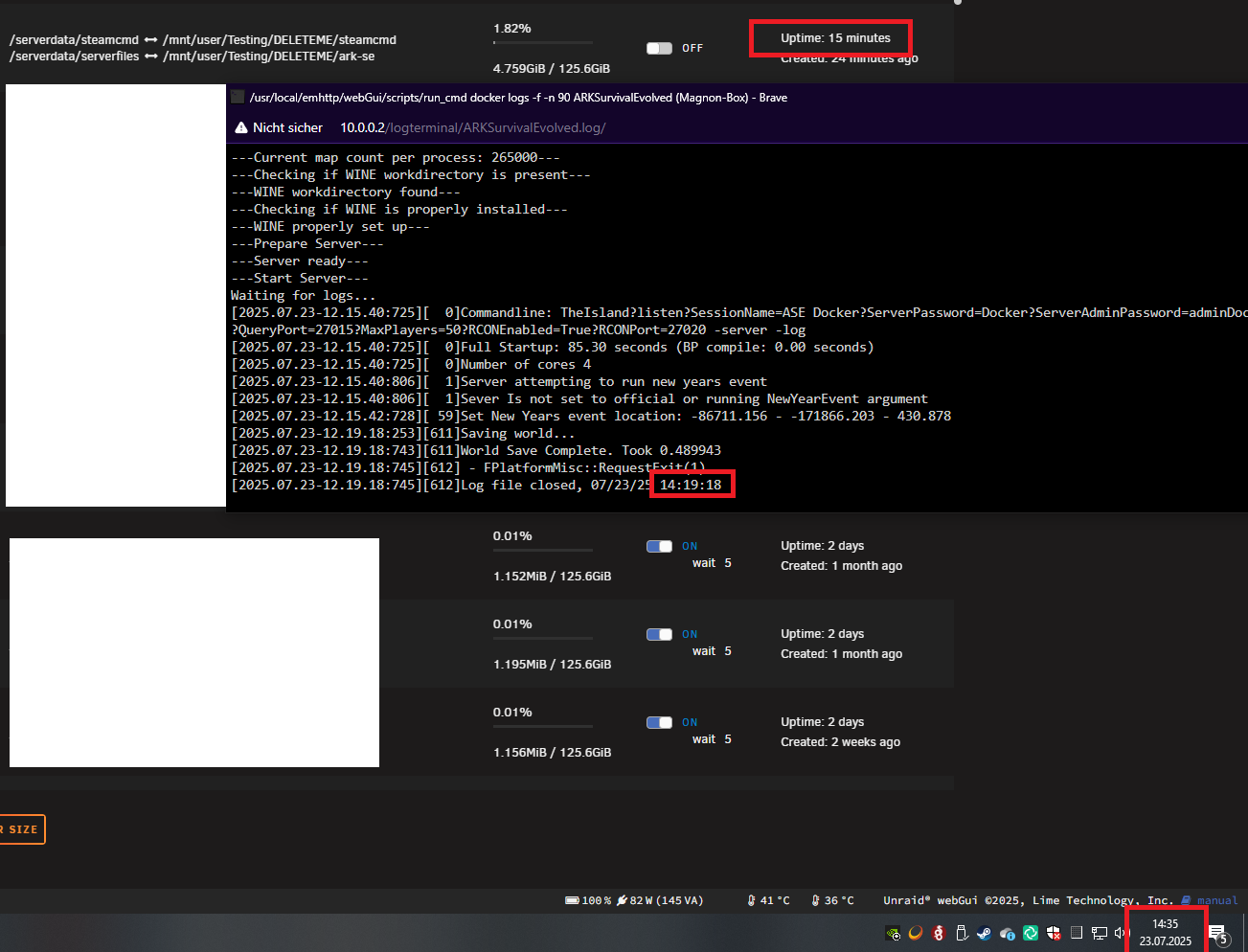

That doesnt look like crashing, the requestexit just means the server got told to shutdown, as to why, i cant tell from that
Forgetting to run the maximum_map_count command does absolutely nothing. As nothing happens with the container.
The container does not delete anything, at all, anything that could delete files of the server are either,
Wildcard with their awful patches (i dont know if they fixed the char transfer deletion on clusters yet)
or
improper mappings, so the container gets written into RAM instead of a disk.
They did update their server package twice earlier, so no clue if that is related to it.
Also keep in mind, the ark log entries from within the docker logs window are 99% of the time from the prior start. As the shootergame.log gets read by the container before the server is catching up with starting itself and doing its logrotate job.
this is what a server log looks after running for a while, as it fetches the "updated log"
Edited by Mainfrezzer

Connecting anonymously to Steam Public...OK
Waiting for client config...OK
Waiting for user info...OK
Unloading Steam API...OK
---Update Server---
Redirecting stderr to '/serverdata/Steam/logs/stderr.txt'
Logging directory: '/serverdata/Steam/logs'
[ 0%] Checking for available updates...
[----] Verifying installation...
UpdateUI: skip show logo
Steam Console Client (c) Valve Corporation - version 1751406682
-- type 'quit' to exit --
Loading Steam API...IPC function call IClientUtils::GetSteamRealm took too long: 44 msec
OK
"@sSteamCmdForcePlatformType" = "windows"
Success! App '376030' already up to date.
---Checking the maximum map count per process...---
---Maximum map count per process OK...---
---Current map count per process: 265000---
---Checking if WINE workdirectory is present---
---WINE workdirectory found---
---Checking if WINE is properly installed---
---WINE properly set up---
---Prepare Server---
---Server ready---
---Start Server---
Waiting for logs...
[2025.07.23-16.13.19:428][ 0]Commandline: TheIsland?listen?SessionName=Sxxx?ServerPassword=Sxxx?ServerAdminPassword=Axxx?Port=7777?QueryPort=27015?MaxPlayers=50?RCONEnabled=True?RCONPort=27020 -server -log
[2025.07.23-16.13.19:428][ 0]Full Startup: 99.24 seconds (BP compile: 0.00 seconds)
[2025.07.23-16.13.19:428][ 0]Number of cores 36
[2025.07.23-16.13.19:516][ 1]Server attempting to run new years event
[2025.07.23-16.13.19:516][ 1]Sever Is not set to official or running NewYearEvent argument
[2025.07.23-16.13.21:521][ 38]Set New Years event location: -86711.156 - -171866.203 - 430.878
[2025.07.23-16.15.42:290][922]Saving world...
[2025.07.23-16.15.43:680][922]World Save Complete. Took 1.389990
[2025.07.23-16.15.43:689][923] - FPlatformMisc::RequestExit(1)
[2025.07.23-16.15.43:689][923]Log file closed, 07/23/25 18:15:43
In the Docker container, I set the network value to a custom network and otherwise only changed the login credentials and the server name.
I hope you can help me.
Regards, Snow

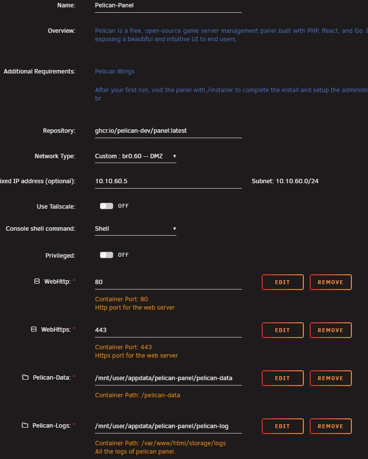

I've some problems launching the Pelican Panel container. In my opinion everything is configured right, but everytime the container starts it crashed immediately and i've this in the log:
In StreamHandler.php line 156:
The stream or file "/var/www/html/storage/logs/laravel-2025-08-12.log" coul
d not be opened in append mode: Failed to open stream: Permission denied
The exception occurred while attempting to log: file_get_contents(/var/www/
html/.env): Failed to open stream: No such file or directory
Context: {"exception":{}}
I've no idea what I'm doing wrong.
This is my container config:
Best regards
Edited by Redurion

The offical container runs with a different user and group
chown -R 82:82 /mnt/user/appdata/pelican-panel
should fix it
Thanks, that does the job
