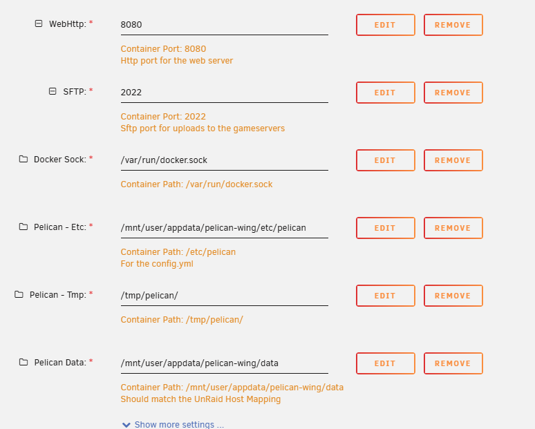

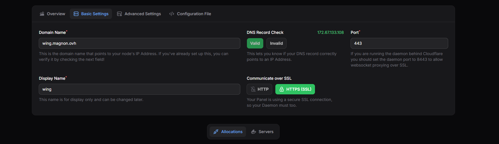

Hello. I have a problem. The wing and panel are not communicating, but the wing and panel are working.

Here is my wing setup
image.thumb.png.bf54946e3ff23c3124bb2c4d7fe974ec.pngConfig:
I have no idea why it's not working

Does the website for the Wing panel display anything when you visit it?
i.e.
Example2.PNG.bff6a57a1ea42bb4df9cb485e8f
if you do not see that message, then your forwarding/proxying is off.
Since i dont know how you have your reverse proxy setup, i can only guess that youre maybe missing the correct port export in the template.
The default thats set is 8080, so in your case, you would have to add a new port mapping on 8002 in the container.
I just needed to change the container port to get it to work. I guess i had same issue with pterodactyl set up. Because before this i tried to get it work. Thank you so much!

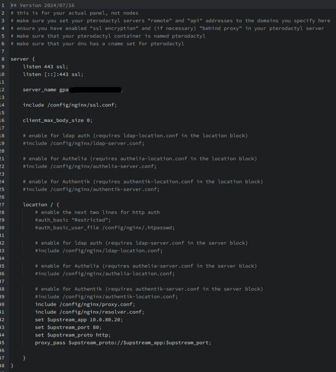

I tried accessing the local IP without being behind the reverse proxy, for this i removed the Proxy Workaround. However this failed to load. I then replicated my working setup on the original image but this failed to load as well.
Original image
I have a Cloudflare Tunnel pointing to the SWAG container, this forwards traffic to the IP:Port of the panel container and is accessible at the APP_URL.
Beta image seems to not get passed the NGINX step.
Very strange, I have not changed anything since my post and I can now access local and APP URL on beta image.
Restarted the container and it hangs at the NGINX step again, unable to access web panel.

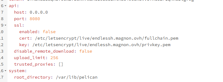

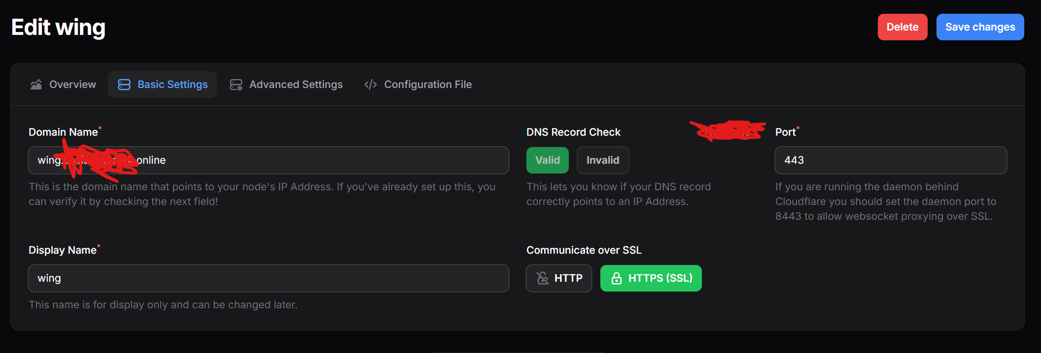

Regarding the wings image, do i need to change the port from 8080 to 8433 if going through Cloudflare. DNS check is valid but health check is unable to connect.
Edited by KeyBoardDabbler
3 minutes ago, KeyBoardDabbler said:
That makes sense now, i appreciate your input. Can confirm the error 500 has not popped up yet either..
For the config.yml itself, you have to change it to whatever is running inside the container and is mapped to the outside.
I.e. by default the config yaml inside the wings appdata folder should have 8080
the cloudflare thing is only a webgui thing, i didnt test the wing with cloudflare, so its either 443 or 8443
while making sure i stopped the container and updated the config.yml, i have tried 8080, 433 and 8443 with no luck. I also changed this on the template and nginx to match.
I would recommend putting SSL: to false in the config ;) should have complained about missing certs in the log
I included the certs in the correct path to prevent the fatal error. Unfortunately this does not help and still unable to get a healthy status.
What a convoluted way to provide certs and then also reverse proxy. That said, i honestly have no clue if native https works on the wings, never tested it.
also, i can conclude. its working fine with cloudflare tunnels on 443
wing template
Webpanel settings
Result

@KeyBoardDabbler im pretty sure the 502 is a swag issue.
ive encountered this issue once before with nginx
the proxy_pass uses variables and malforms the request. When change the proxy_pass to the proper written out "http://10.0.80.20:80" then it worked.
Edit: The odd thing was, i even only used swag to go one hop. All i tried to access with it was 192.168.2.2:800 and gave me a 502, while being able to curl it.
then i tried my unraid server it failed too.
After changing it back to variables, it seems to work again. But no clue why, maybe cache. who knows
Edit: heres the malform issue mentioned https://github.com/NginxProxyManager/nginx-proxy-manager/issues/4102
Edited by Mainfrezzer
added missing config.yml picture

I have the same settings, although the Cloudflare tunnel points to swag and it doesn't communicate. I will try connecting the tunnel straight to the wings container.
That reminds me, in nginx, you need to set something if you want to access ssl pages through the proxy
proxy_ssl_protocols TLSv1 TLSv1.1 TLSv1.2 TLSv1.3;
proxy_ssl_server_name on;
one of those 2 it was
im pretty sure, cloudflare has something similar for the proxied pages, but no clue on tunnels

I found ssl_protocols but not proxy_ssl_protocols. I also tried connecting the tunnel direct to the container instead of going through swag with no luck.
You mentioned "its working fine with cloudflare tunnels on 443" but your template is using 8080?
Screenshot2025-02-15114925.thumb.png.a436fd089edd72257780113cb18f0486.pngScreenshot2025-02-15115034.png.37662aad7d937b6090343cef5d895acb.pngScreenshot2025-02-15115119.thumb.png.90c5b6ce5ae247b0ed9c144f6b4270c2.pngScreenshot2025-02-15115310.thumb.png.d6873fee713e177a3da5c1f3970c24f8.pngScreenshot2025-02-15115604.png.90510336518457734596864a8a75cca6.pngScreenshot2025-02-15115809.thumb.png.d50f007a629d0b0751b48ae1ef15a05f.png
The container itself uses 8080. Because 8080 is forwarded to unraid.
The cloudflare tunnel is directed to redirect wing.magnon.ovh to 172.17.0.1:8080
Anyone who wants to access https://wing.magnon.ovh is automatically directed to port 443, because its the default port.
Its detached. Everything that is in the container, stays in the container.
No matter what you change the template to, if its 3888, 47578 or 30000. As long as the template say, image.png.6f95bd1d9ecb8f2ca93ae220952f9bff.png it stays Port 8080.
What the cloudflare tunnel(or any proxy) is pointing to, is whatever you set here image.png.8f4b85083edf5bfc597ed105635b59a6.png
And the webgui will use the default 443(since it worked)
Edit: If you dont use Unraid as the target, ie either lan ip or the internal docker host 172.17.0.1 its whatever the container port is period. if the container is running on the bridge with 172.17.0.20. its 172.17.0.20:8080
unless you did change the port in the config.yml, then its 172.17.0.20:Whatevertheconfig.yml says
