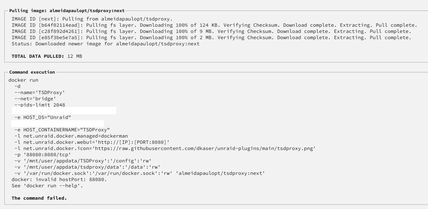

I can't seem to install this container (see attached)
does anyone know what im doing wrong?
Invalid Hostport 88080, i think thats the reason.
