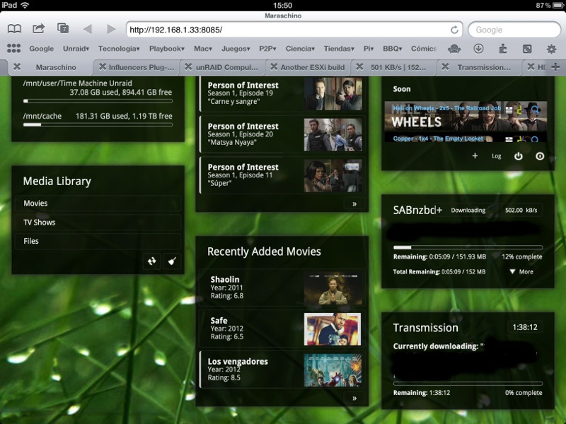

Sab works it only shows info if something is downloading, you may have to refresh. Haven't tested all of the modules but any issue there will be with the app itself unless its trying to use a program unraid doesn't have, send a log after enabling the modules that don't work so I can see what errors it may have.

Ok, but overall works pretty well, even in iOS  :)
As you said Sabnzb and transmission modules work fine, perfect, but only show info if there is any download, working or in pause. After complete info disappear.
I did notice that about the transmission module which is fine. The sab one works perfectly. It actually shows the top 8 items in queue while it is idle, at least for me it does.
The trakt modules work perfectly as well.
