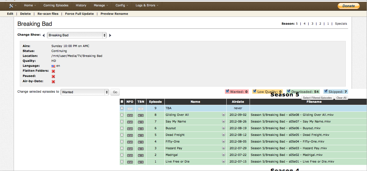

I upgraded to the sickbeard_unpluged plugin version and now the columns are all messed up. I have attached a screen shot of what I'm talking about.

Pmurphy, try clearing your browsers cache, beyond that it would be a app specific issue but ill still try to help you resolve it.
Do a shift refesh in your browser sometimes between versions they change the web client a bit and the cached stuff causes issues.
Clear your cache.

After a few reboots with the 8a upgrade... The problem just went away. Thanks for the tips though :)

I tried to clear the cache and the restart the browser but it didn't help. I will try a shift refresh this evening. Thank you for the help.
