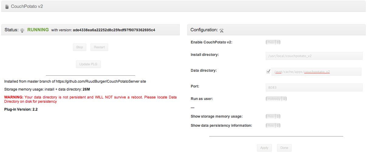

Not sure if I am in over my head, I'm running 5.0-beta14 and your latest plugins (Author: Wojciech Walaszek; Influencer. Version: 0.7.  unRAID™ webGui © 2010-2011 Lime Technology LL) however, Couchpotato now fails to start. I'm using Plug-in Version: 2.2.

What is the install directory for your couchpotato, and the data directory.
Also, from telnet run
/etc/rc.d/rc.couchpotato_v2 start
Post the output

install dir : /usr/local/couchpotato_v2
data dir  : /mnt/cache/apps/couchpotato_v2
Not sur how long it takes to start but my Telnet appears to hang at
root@Tower:~# /etc/rc.d/rc.couchpotato_v2 start
Starting CouchPotato v2: sudo -u nobody python /usr/local/couchpotato_v2/CouchPotato.py --daemon --config_file /boot/config/plugins/couchpotato_v2/settings.conf --pid_file /var/run/couchpotato_v2/couchpotato_v2.pid
...and simple features is still showing CP as stopped??

I tried deleting the plugin and starting again..
I deleted:
/boot/config/plugins/couchpotato_v2_unplugged.plg
And rebooted, I then inserted a fresh copy of your plugin from Github and rebooted. Initially it said CP was running with the expected "data directory is not persistent" however, once I changed the port and date directory to my cache disk I was back at square 1.
(see attached .png taken just after changing the data directory but before the webpage had refreshed)
UPDATE - edit
Ooookaaay, went back and did all of the above with the inclusion of deleting:
....Problem solved, all good.
