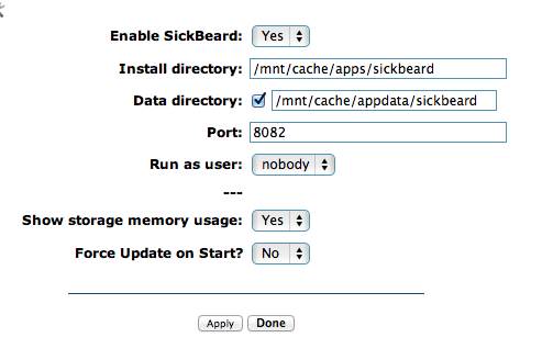

Can anyone advise how to add a commandline parameter to Sickbeard when it starts up using this plugin ("--forceupdate")?
I need to force sickbeard to do a mass update at startup as it normally does this at 3am when my server is not switched on.  Annoyingly there is no way of scheduling this check other than to force it at startup (from what I've read).
There's an option in the plugin config for this "Force Update on Start"
So you should just need to toggle to yes, and apply the changes.
Ahh, that's what that setting does!  Thank you :)
