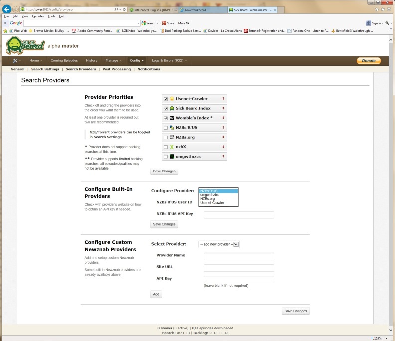

I wasn't able to attach a screenshot via PM, so posting it here.
In SB, nzbgeek is not listed in the boxes at the top, nor the built in drop down list.  I don't have the API dor nzbgeek and their support team hasn't answered my email.
CB has nzbgeek listed so I have that box checked, but again, I do not have the API key.

To setup your search site you go into sickbeard and go to Config > Search providers. NZBGeek is one of the preconfigured providers so you just check it and then scroll down to built-in providers, select nzbgeek from the dropbox and input the info needed.
The provider, supernews, is setup in sabnzbd. You open sabnzbd and go to Config > Servers > Add server and input the information for supernews.
Check out the instructions I posted and it will help you get sab and sickbeard setup to work together. The part about categories will also work for couchpotato. You'd set a category for "movies" and then when you set couchpotato up you'll tell it to send to sab using that category. This will let sab put everything where you want it so sickbeard and couchpotato can process the downloads accordingly. PM me with any questions and I'll do my best to help, I'll probably update my instructions with couchpotato as well.
if you want to use nzbgeek.. then you just need to add it. you obviously need to signup with them to get an apikey. if you dont have an apikey with them.. then you cant use them.

Yeah I answered that question via pm. It was my mistake thinking nzbgeek was a built in provider, I remembered seeing it but since I don't use then I didn't think I had added it. Guess I did at one point in time.
