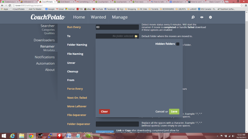

I seem to be having a bit of difficulty with cp v2.  Specifically the renamer.  I cannot seem to place a 'To' or 'From' directory.  I click the folder icon, the drop-down screen appears but is completely blank other than the 'Hidden' files checkbox and save, cancel, clear.  I tried pasting, no luck.  I disabled the sort function on SABnzbd in case there was a conflict, no luck.  I've tried so many searches with no luck.  I'm a complete noob so i'm not ruling out user error but i've pretty much exhausted my patience so it's time to reach out for help.
I get this error in the CP logs
[tato.core.plugins.renamer] Both the "To" and "From" have to exist.
I've attached a screenshot of my blank dropdown menu.
Thanks ???
You might try renaming your couchpotato database and restarting couchpotato. Or possibly remove the installation and restart the server. Only place I can find that issue is in windows.
I'll giv'er a try tonight.  Thank you.
